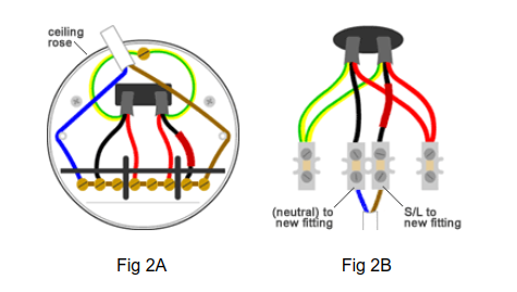

Ok I am after a little bit of advice, I am looking to swap over my light fittings (photos below).
I wanted to check if what I plan on doing is correct and yes I know to switch off the electricity before doing anything!
The two blue on the left:
Cable 1: Leads to the light fitting
Cable 2: From ceiling to the light fitting (in old and new fitting)
The two brown on the right:
So these four cables makes sense to me.

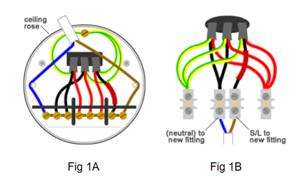

Its the loop cables in the middle which throws me off, I have checked all 6 light fittings and the loops are setup differently (I have no idea how these work) so I don't want muck around and break something.
Existing light fitting:
New light fitting:

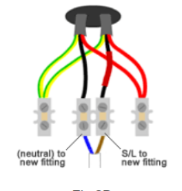

To handle the loops this diagram below seems to indicate I need to terminate them and then just leave them in the fitting doing nothing.
So from what I have described would I be doing this correctly? The main bit is the loops which through me off, moving the live/neutral connection from the old to new fitting seems simple enough, but am I doing the right thing with the three loop cables? Some of my other fittings have 1 loop cable fitted, others have none, so im not sure if I need to use them or not?
Can someone advise me on this please?
Thank You!!
The 2 blue cables on the left are both neutrals.
One comes from the loop, the other feeds the light fitting.
The 2 at the far right are switch live.
One comes from the switch (blue wire with brown sleeve), the other feeds the light fitting.
The 2 in the middle are the loop, so they must be connected together but not to anything else in the new fitting.
Of course earth wires are all connected together.
To put it simply after disconnecing old fitting and marking existing cables temporarily so they don't get mixed up, in your new fitting you need to connect the blue wire to the blue terminal (N), the switch live (blue wire sleeved in brown in your picture) to the brown (L) and then the earth wires together in the middle connector.
The other 2 brown wires in the middle need to go in a separate connector, I use Wago.

Also with the ago terminal connector, would you wire the three loop wires into one single wago connector or have three wago connectors, one for each wire?
Just wondering what is the best way to do this (safest way)?

I think so, going on the above diagram the two neutral I have seen in the current rose fitting earthing it, so those i need to unscrew and rescrew to the new rose fitting
The two in the middle of the photo (the black cable and black cable with red on) are the live and earth cables which on my original rose are on the outside of each cable connecting to the terminator and then rose connects to that passing on the connection.
Above the two red on the right are the loop wires being terminated off.
I think I have the wiring right, its just the loop which alludes to me, I do worry I will break something by not using it, what is the point of the loop if I don't need it in my new fitting?
The loop is the permanently live cables (it is a radial set up), one runs down the to the light switch and then back to to the ceiling rose as a switched live. The other permanent live comes from/to a neighbouring ceiling rose. If you have 2 or 3 loop wires, they will need to go in to the same Wago, or similar.

Yes, the loop all in the same Wago, otherwise you'll lose light somewhere.
When I say same Wago, I mean one connector with 2 holes.
Don't stuff 2 wires in the same hole ;)
There is only ONE Neutral.
The two in the middle of the photo (the black cable and black cable with red on) are the live and neutral cables
No, they are THE Neutral and the SWITCHED LIVE.
Yes
It connects the supply live to the other red which takes power to the switch.
