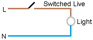

This is the basis of how a switch and a light work:
Somewhere in the system We need to bring the supply, the switch and the light together and that is conveniently done at the light fitting (ceiling rose):
As we don't tend to use cable with 2 browns (or 2 reds), instead we use brown and blue and add marker sleeves to the blue:
Does this help explain how it works?

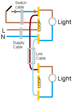

If both of your hall lights work together (by the same switch) the common method is adding a link between the 2 lights:
Leaving the 'loop' terminal empty in the second light.
Yes My hall has 2 light fittings with one switch, same in my living room 2 lights for one switch so this explains how the lights are linked up.

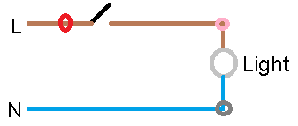

Will be terminating the loop cables not interfere with how everything works? As from your diagrams the loop helps with the switch so if I don't use the loop cables will everything be fine or am I going to have issues?
This is what is confusing me about the loop, it seems like I can terminate them and not use them and it has no effect, but since they are in place they must have a use? So am I ok to just terminate and not use them without any consequences?
If you look at the bit in the red circle
there are simply 2 wires joined together which corresponds to the red circle here:
The pink circle being the 'L' terminal in the ceiling rose and the grey is the 'N'
