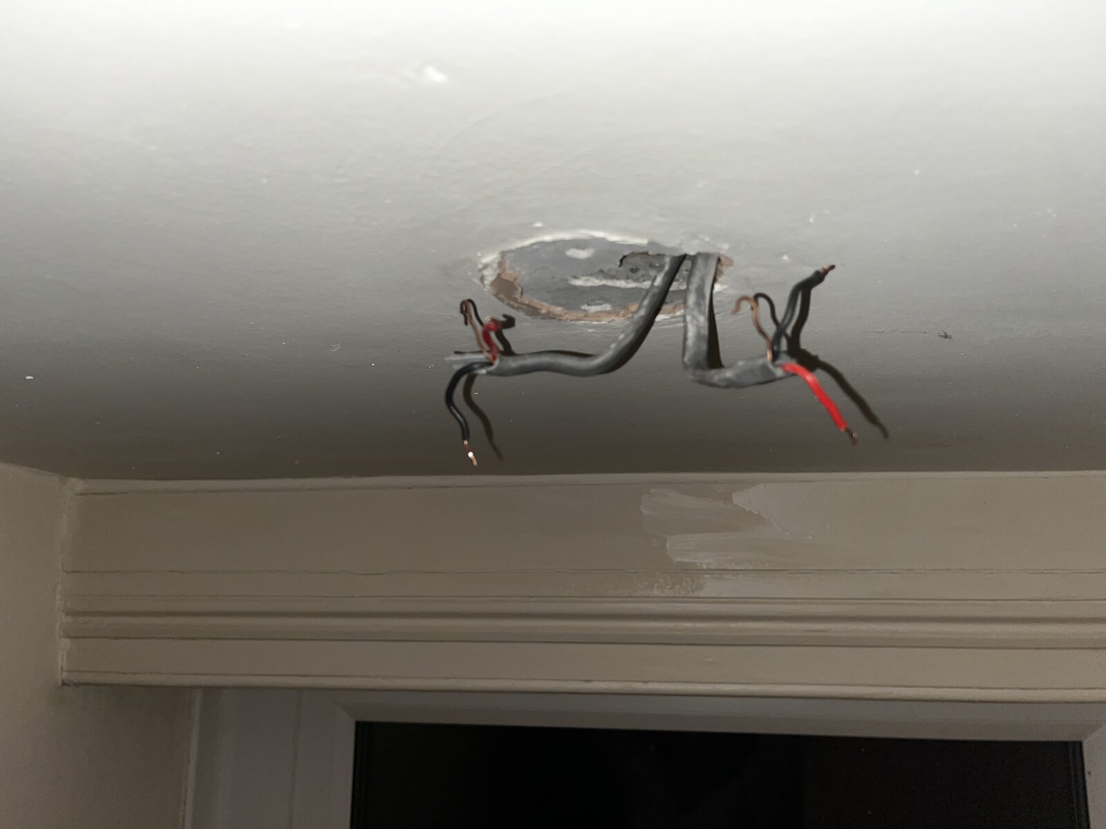

Hello,
I am changing the light fixture in my house and cannot seem to get this to work. The original ceiling pendant was cracked and falling off.
This is the wiring right now.
I have purchased a standard ceiling rose pendant.

one will likely be live and neutral IN
and the other to the switch - both Live and switched Live - so takes the LIVE down to the switch and then the other connection at the switch brings back the live to the rose
do you have a multimeter - OR some way to measure the voltage
one of the blacks maybe a neutral
and the 2 reds and black - may (depending on switch) Live

yes I have a multi meter, it’s 2 red 2 black and 2 copper
copper are earths and should be sleeved
so i pair will probably be live IN
so if you measure each cable - grey , red and black - i suspect one will read approx 240V and the other nothing

once you have done that and identified the LIVE IN cable
you could (with power OFF) checkk the switch cable
and then using resistance continuity - connect to the other black and red and switch the light switch ON/OFF and see if that has continuity ON off with the switch

how is this protected is it on a MCB and RCB at the consumer unit????

I’m ok when it’s the updated wiring and that, I have a fair idea of the basics and have don’t this many many time before. This old house I’m in now, nothing seems to be a simple fix.
I have measure with the multimeter and identified each

should be - from old to new colours - but electric does not know colours - so this is assuming people wire correclty
red=brown
black=blue
copper = yelloe/green sleeving
if
black is a switch should have a red sleeve
Blue is a switch should have a brown sleeve
not trade , but worked on quite a few houses and rarely saw , black with a red sleeve
