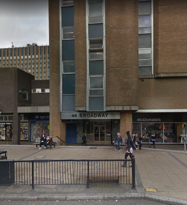

GB
VAT Number GB 273708486
Name SHENZHENSHI LIHUANKEJI YOUXIANGONGSI
Address 44 BROADWAY LONDON GREATER LONDON E15 1XH
GB
A bit late - see post #15 :)
There are 601 Limited Companies which have that as their registered address - but none bear that company name and, as has been said, no company with that name (or a name anything like it) is registed at Companies House.
I therefore can but assume that either it is not a limited company, and uses that address just for VAT registration purposes, or that the actual limited company has one of the 601 names, but with the VAT bei ng registered in terms of a trading name (as above) of that company.

They may be trading under a different name. I don't know for sure, but I wouldn't have thought that 'someone' who was not a 'legal entity' in the UK (e.g. a UK resident person or a UK-registered Limited Company) could get a UK VAT number (it could, of course, be fake!).
Not only "could", they have to.
https://www.tmf-group.com/en/services/companies/accounting-tax/vat/country-profile/uk/
As for the address, there's probably a lawyer, or an accountant, or maybe just even a mailbox operation in the building somewhere.
