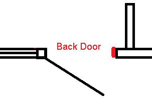

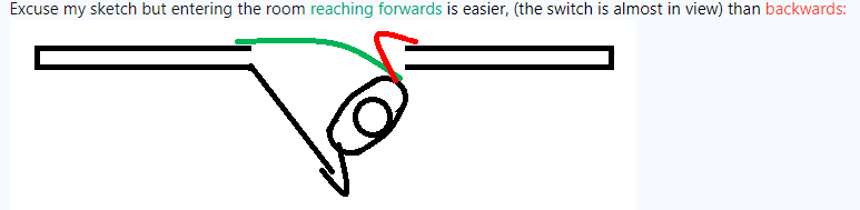

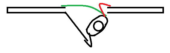

Excuse my sketch but entering the room reaching forwards is easier, (the switch is almost in view) than backwards:
He demonstrated this at 3 other existing doors and all were at the hinge side.

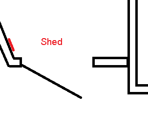

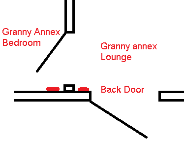

So thinking about my own home I have 5 doors that open outwards (6 if one counts the Granny Annex bedroom door as the entrance to the lounge) and tonight I've experimented and found that unless the door is fully opened and let go of he is correct. However, generally one is still holding the partially open door as you proceed unless there is an obstruction such as exiting the Granny Annex bedroom
Back door was a later addition by making the window (to the left) narrower and the only place for the switch is the reveal
And finally the WC, the only place the position feels awkward and the place we regularly have to tell guests where the switch is
In conclusion; I have completely changed my mind and agree the correct place is hinge side, it really does flow better (assuming no other factors involved).
