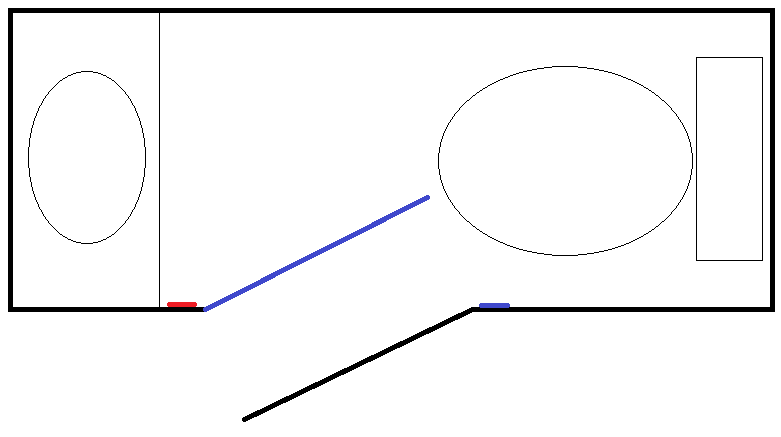

Well this all started with me thinking it should be on lock side but builder reckoned hinge. My conclusion from this thread is it doesn't seem to much of an issue, however the room which seems to have caused problems to people is our downstairs WC shown very roughly to scale about 7.5 x 3ftwhere the switch was lockside and they never seemed to find it. However we have rehung the door and moved switch shown blue.
Well there are some potential big 'issues', but maybe they're so obvious that we're not bothering to discuss them.
For example, once you had re-hung the door so that it opened into the room containing the switch, it would have been ridiculous to have the switch on the hinge side - since it would then have been necessary to go into the room, almost completely close the door, and then grovel are in near-darkness to try to find the switch!
As I said above, whilst it's not much of an issue in relation to a switch on the side of the wall 'away' from which the door opens, in the case of a switch which is on the side of the wall 'towards which' the door opens (and we your re-hung loo door), it is more-or-less essential that the switch is on the lock side.

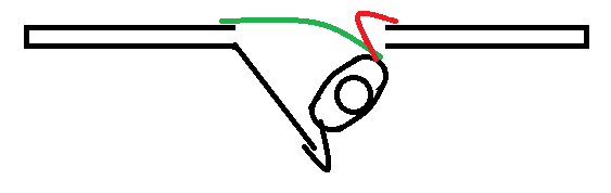

With two available hands - one hand for door handle, the other for reaching for switch, so lock side generally for me, which is how all of my room switches are and seems natural. One exception is the upstairs bathroom, where the switch is outside the door, combined with the 2w stairs, but that again is lock side - one hand reaches for door handle, the other to the switch - seems natural. Another example is the under-stairs cupboard, that is actually on the hinge side, but the hinge side is at right angles to the closed door and is the only solid wall and shares the wall with an angle batten lamp holder. The door had to be hinged on that side.
So are you saying black arm to open door and reach round with red arm?
