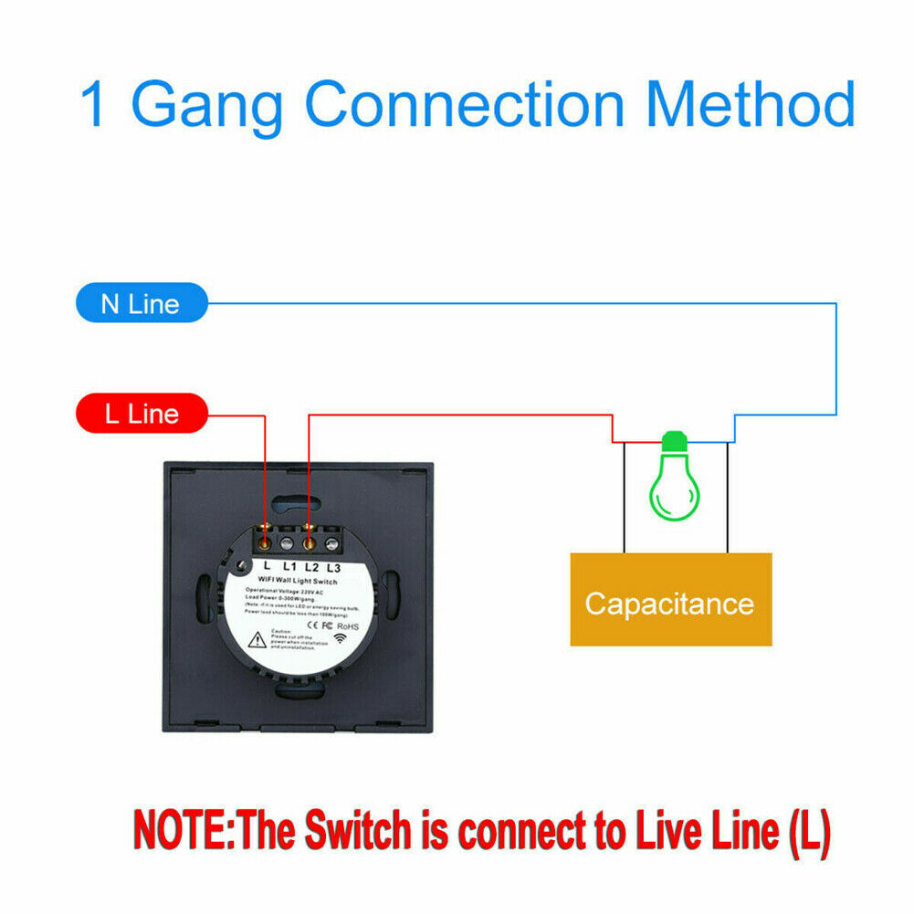

Hi Foxhole, just looked up switches that don't require neutral. How would i connect this up to my existing set up?
