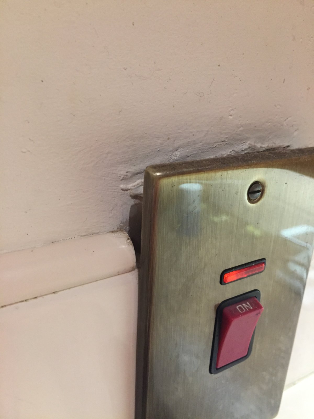

3. The cooker switch finishes higher than the tiles, I was thinking of making a frame with some flat tile trim I have to go round the edge of the switch? Or maybe a frame made out of wood/mdf and painted to match the wall ? It would not be proud of the switch, it would just sit behind it.
Can't you get a smaller switch?
Can you try some LED Lamps in the same fitting ?

3) Why any electrician would fit a switch like that I don't know, likely he didn't and it was tiled after the switch box was fitted if it was mine I would add extra tiles maybe a thin one of a contrasting colour which replaces the tile edging, but this is down to tiles rather than electrics. Yes you can get smaller switches (isolators) but it would require a back box to match so you will damage tiles fitting it.

I am still undecided what to do with the cooker switch. Looking at it it can't be a smaller switch as it has a large back box, it's to power a range cooker so so not sure if socket size relates to cooker size?
