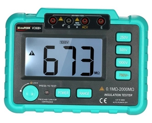

One of these View attachment 334790 costs around £35 there are more expensive which are calibrated, but I got this one for £35, it uses 500 volt DC to test, so clearly you need to know what you are doing. If you can't be sure it is the RCD in spite of pictures, I am not sure it is safe for you to try to DIY the diagnosis?
