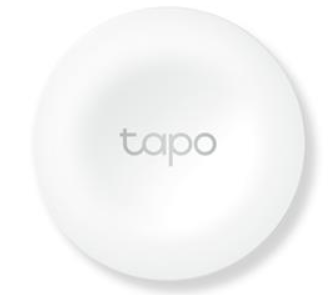

I do not walk around the house with a mobile phone glued to my ear, so using the phone to control the house is rather inconvenient. So I need some other method like the remote shown to control the smart devices, and each make seems to have a different method. Used a magnetic button 1715243686329.png but quickly realised with voice control it was simply not used, so reused it as a door bell, which has some advantages as I can see when it was used. Not gone full video door bell as yet. The use of voice control with Google Nest Mini's means I do have control with the google Home app on the phone, so all the different makes all work with one app.
