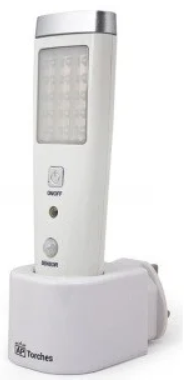

There is also a rule "Every installation shall be divided into circuits, as necessary, to: (i) avoid hazards and minimise inconvenience in the event of a fault (iii) take account of danger that may arise from the failure of a single circuit such as a lighting circuit" What we don't want is for a fault on sockets to cause loss of all lighting but one of these 1697685184401.png would remove that problem, I have one top of my stairs which auto lights with a power cut, so I can find my way down the stairs safely with a power cut.
One is not permitted a spur from a spur unless fused off a ring final, but one can have a radial so that socket would need to be supplied from one of the 16 amp MCB's. And if that's the case there is really no problem, other than loss of light if a MCB trips.
I have seen many homes where the lights and the sockets are from the same RCD, so should some thing happen to trip the RCD one is also plunged into darkness, but the simple plug in torch shown means that's not really dangerous. And a power cut will clearly plunge one into darkness anyway.

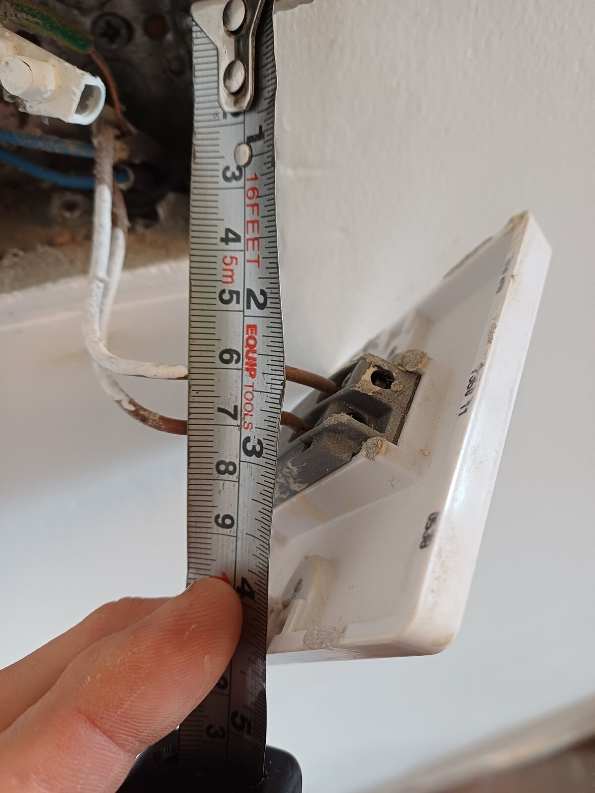

The socket may itself be a spur. Are the two cables the same size as each other ?

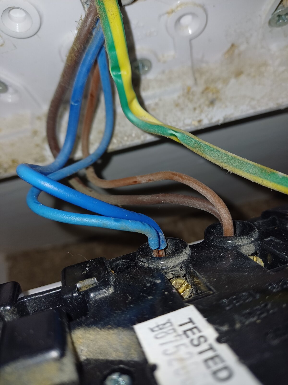

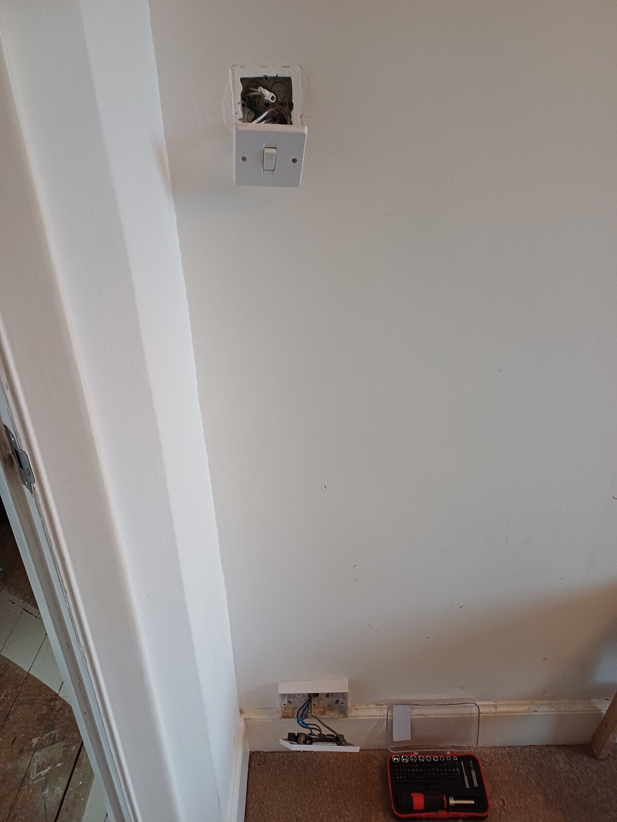

There's no slack on the wiring for me to check the pvc sheath, but it looks like one cable is smaller. There's no slack on the cables in the light switch either. I think it's 1.5mm T&E in the light , and 1 x 1.5mm an 1 x 2.5mm in the socket. See photos.

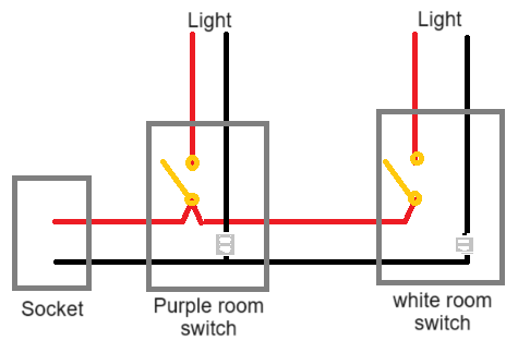

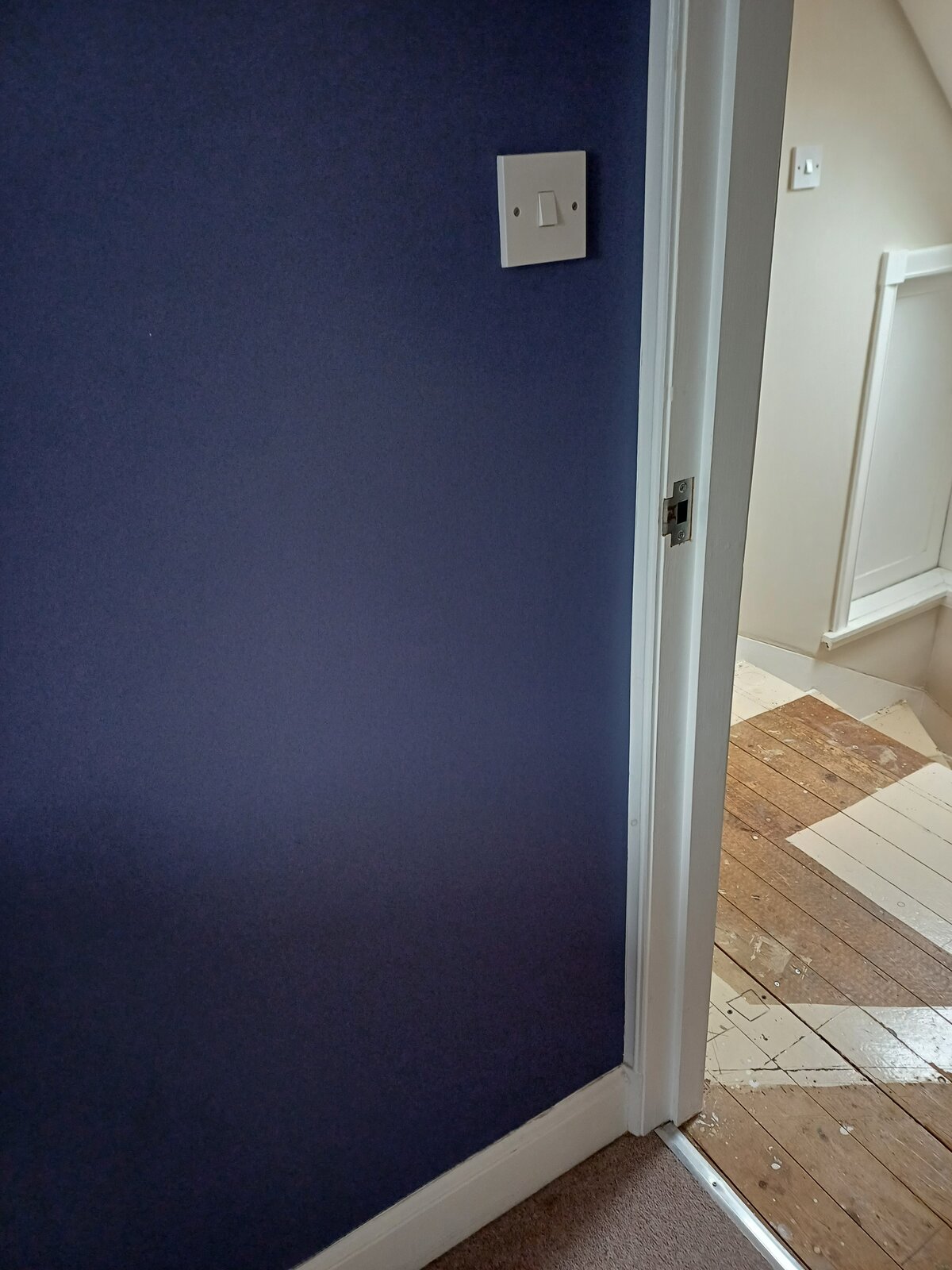

Turning of that 32A breaker switches off the socket and light (white room photo). The light in adjacent bedroom also goes out but there's no socket nearby (purple room photo).
From what you have told us ,it seems like the socket is spurred from a ring final circuit,and the light fittings are too. Not compliant and needs sorting. Engage an electrician.

I'm going to make a guess that the purple side has 3 cables
