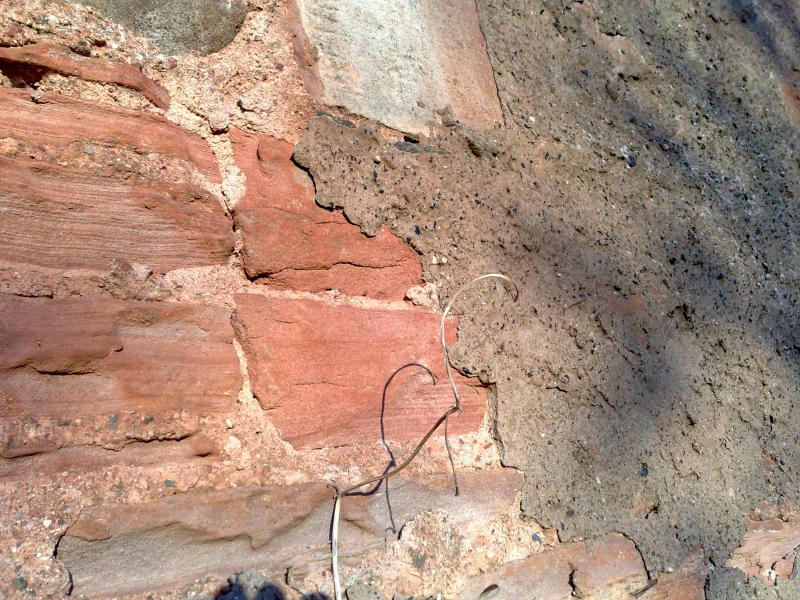

I need to repoint the stonework on my house and also apply a thin render. Two exterior walls are rubble walls with a mixture of red sandstone & a hard black impermeable stone (Schist?).
I am intending to use a Lime mortar for re-pointing and for applying a thin render.
As I have never done this before, has anybody have any tips or advice on sourcing & working with Lime?
Many thanks
Martin

Just one thing here, addict -why use board adhesive, designed for internal use only, for outside work? That's got to last in wet conditions for as long as the render
Use the material you need for outside work to fix the beads . You should stick the beads with sand and cement when rendering outside. I can't think of any good reason to do otherwise?
What is the pointing + render in photo made of ? .What type of finish is on the other to walls ? . How exposed to weather are the walls ? . More pics ?. Working with traditional lime rather than a cement based mortar requires more time and attention to detail due to the fact that it cures using an air drying process , not a chemical one . More preparation and careful application is needed as the finished material is inherently weaker , and is not relying on p.v.a + chemicals to stick it to the stones like cement . To avoid crackingfrom sun / wind the work must be protected with plastic sheeting . You dont want to be working in temperatures below 10 degrees as the carbonation (drying) process will not work leading to mechanical failure .The traditional time for outside limwork is spring / early autumn , avoiding both hot sun and frost . The advantages of this slow setting time is that you dont have to clean tools / scaffolding if taking along lunch break . Dont use anything with cement in it as it will ruin your old buildings' breathability .

Hi Sullydude-I presumed that you were intending to use natural lime [non-hydraulic or hydraulic] to repair your walls?I dont think just adding a bit of hydrated[powdered] lime to a cement and p.v.a mix is quite what you meant.If Im wrong then you shouldent have any worries about sourcing a few bags of Hydrated lime -if Im right,then you probably dont want to follow the methods described in the last few posts.
Hi All,
Thank you all for your posts. I have been led to believe that the exterior wall in question is a Lime mortar & render and as such I should replace it like for like to avoid damaging the stone with a mortar (containing cement) that is too hard & impermeable to water. I should have explained that this house is perhaps 150 years old.
Thanks again.
