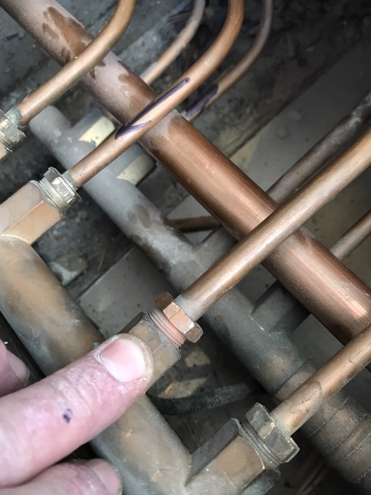

Hi I have an old Yorkshire linear manifold, I need to change the feed and return from 8mm to 10mm. Does anyone know what this is called
and can I still get one? Don’t really want to change the whole manifold if I can help it. Please see photo.

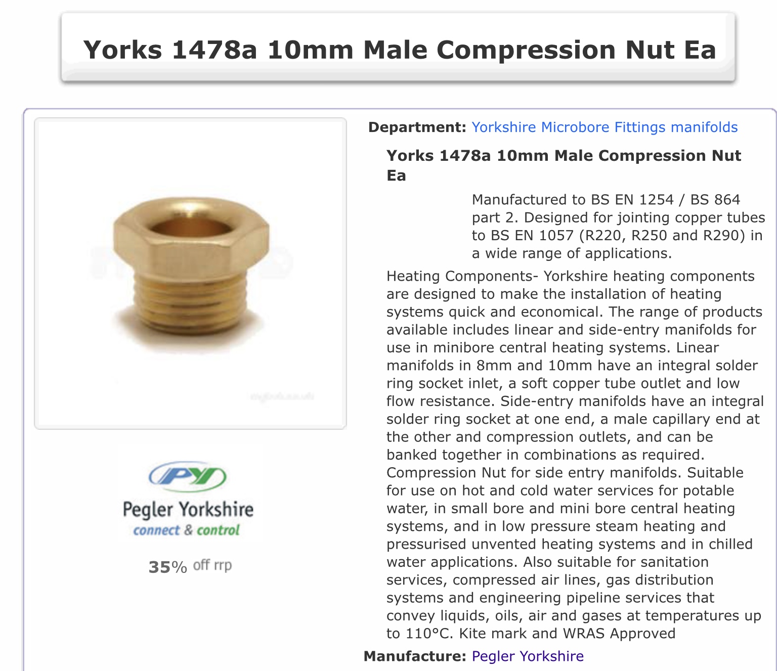

I suspect, but am not sure, that all you need is a pair of 10mm Pegler part No. 1478A. Wolsey and "MyTub" do them, amongst others.
Thanks for the reply Exedon, I’m just after the screw/connector, don’t know what they are called. Don’t want to replace the whole manifold for the sake of two connectors.
Why not fit a tee with reducing branch and go with your plan rather then chance the manifold
Thanks guys found what I need now. Very impressed how quickly my question was answered.
