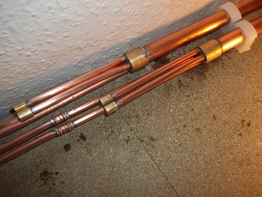

Linear manifold 22mm x 2- 15mm
View attachment 122832 Most installers would install a magnetic filter but :mrgreen: has invented his own device to collect system debris in the dead ends :idea:

Hadn't thought of that, I could fit isolation valves at the ends of the stubs to allow the debris to be removed. Would these stubs be as efficient at collecting debris as a magnetic filter in the return to the boiler wpuld be.

so you have managed to take a 4 port manifold and blank two of them off ????? think I was
about 10 stone lighter when I worked that one out
Why not just carry on the two pipe? I can't see any reason why you couldn't have fitted tees
