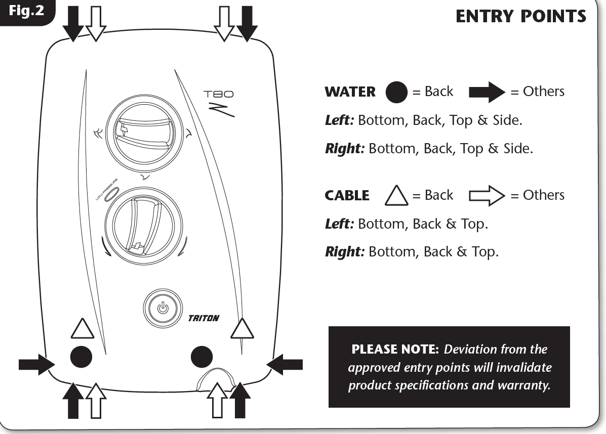

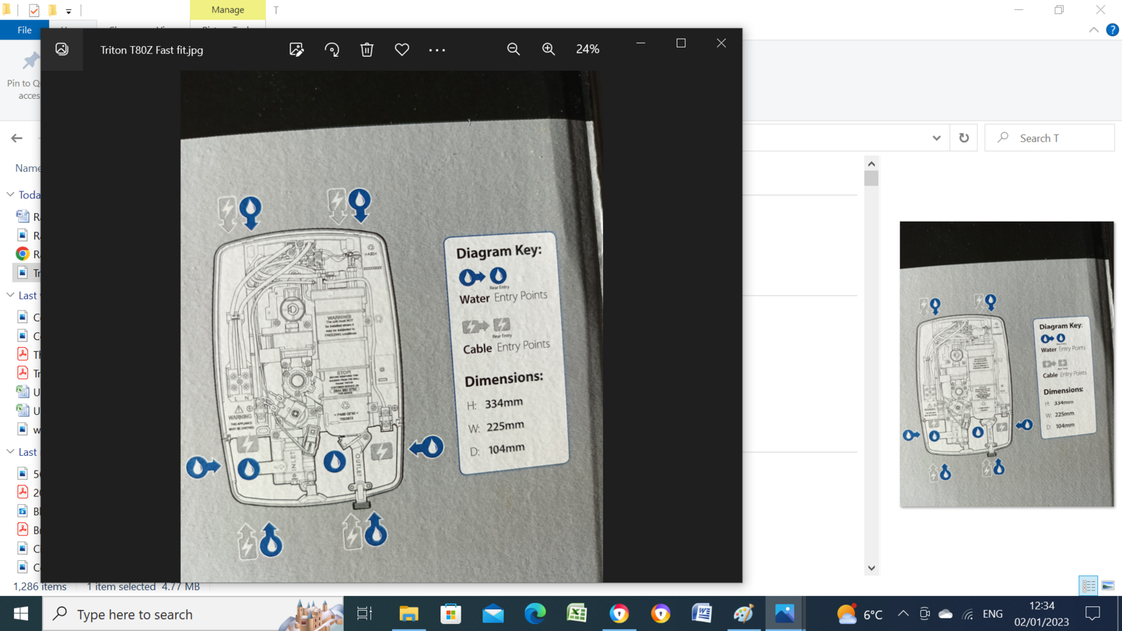

If you are retro fitting a replacement shower ,you need to give consideration to the positions that the cable and supply pipes are in,particularly if they come through the wall and there is no access behind to change their position. All showers are not the same in terms of the connection points for cable and pipe.

The Triton T80Z fast Fit will accomodate most if not all water and cable positions, I replaced by 15 year old Mira Sport last week with this shower, no problems whatsoever.
