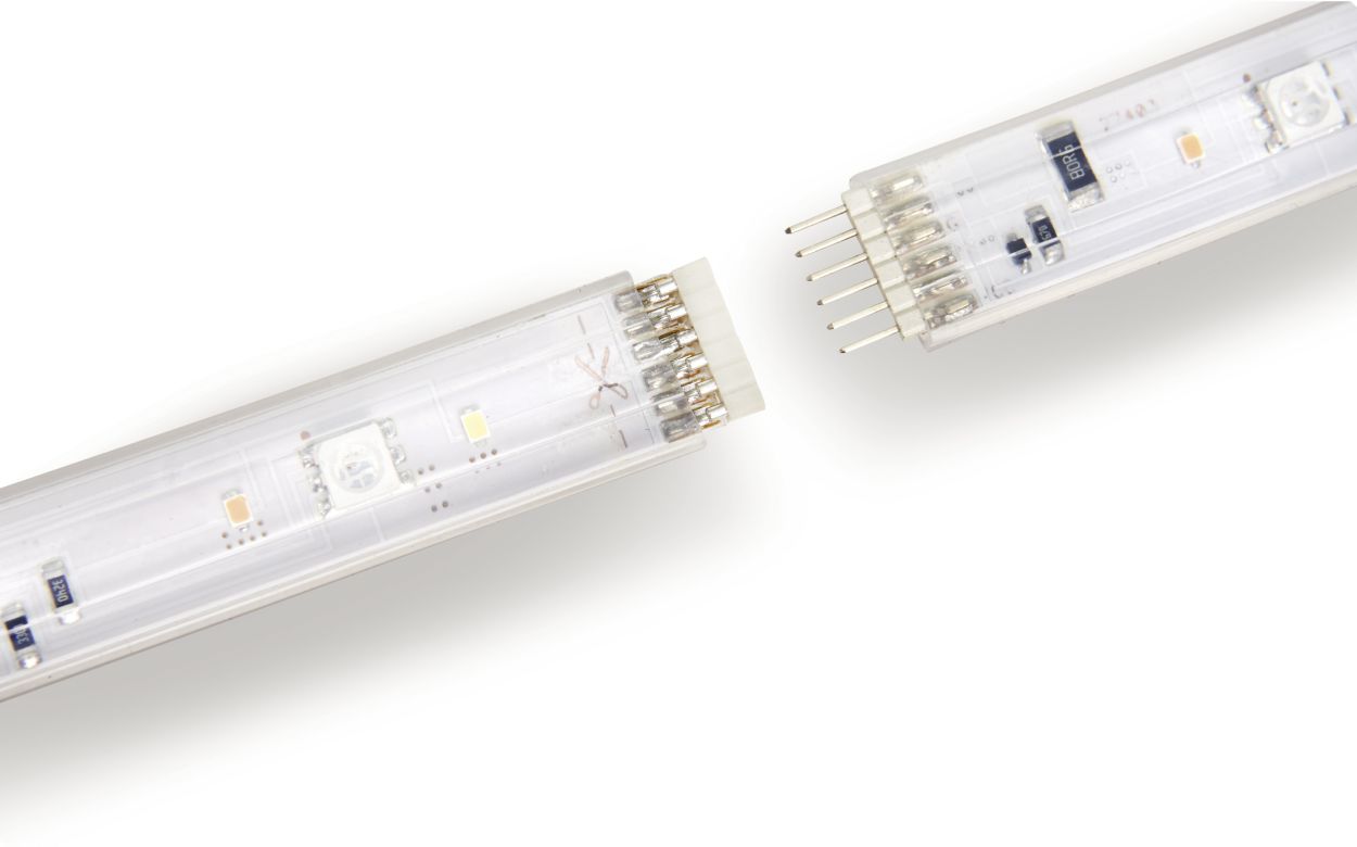

I was starting to doubt myself after some of the posts with the 13a socket on the lighting circuit and wondering if I should just take a feed form the sockets below the cabinets up the wall into the new single sockets and just ignore the wiring the building left to the switch!
Well that would be a better way of doing it. Or else change the power supplies on the hue lights for ones with wire ends rather wall worts.
The switched will be permanently on to be fair. Rarely switched off, the whole kitchen is the Philips hue system which is controlled by a wireless switch mounted right beside the actual light switch. The hue lights dont like having the power switched off to them they resat back tot he 100% white setting on all bulbs and the kitchen is like a floodlit stadium.
