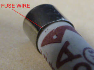

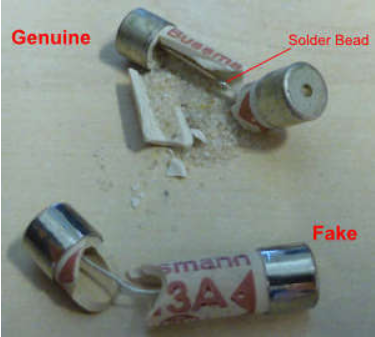

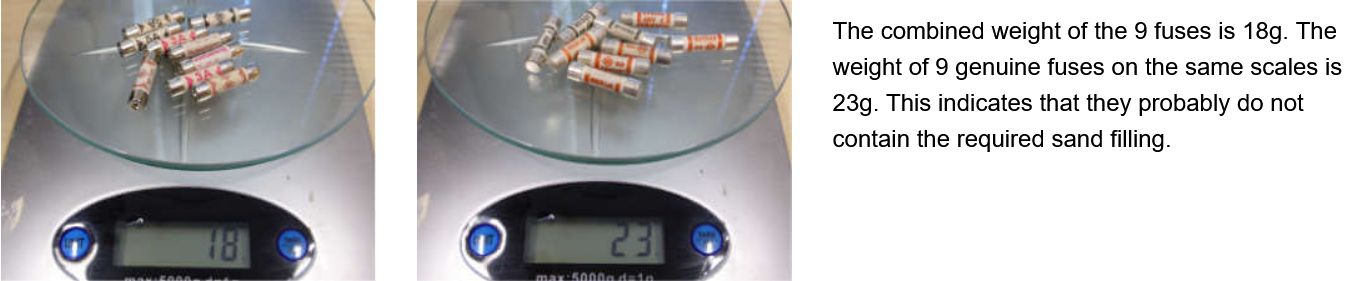

Fake 13 amp fuses make this worse
we are told we need to weigh them,
Yes and we are really going to do that? There are other signs 1733715401841.png1733715430353.png but most of us expect fuses bought over the counter to be genuine, I find I buy 3 amp and maybe 5 and 7 amp, but 13 amp I gain as changed when wrong size found, so my 13 amp fuses could come from anywhere.
