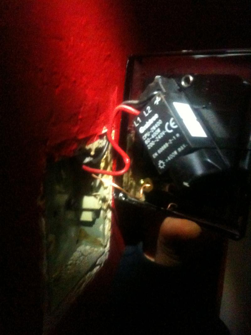

on the bottom picture of the switch, is it normal to only have one red/black/earth cable?

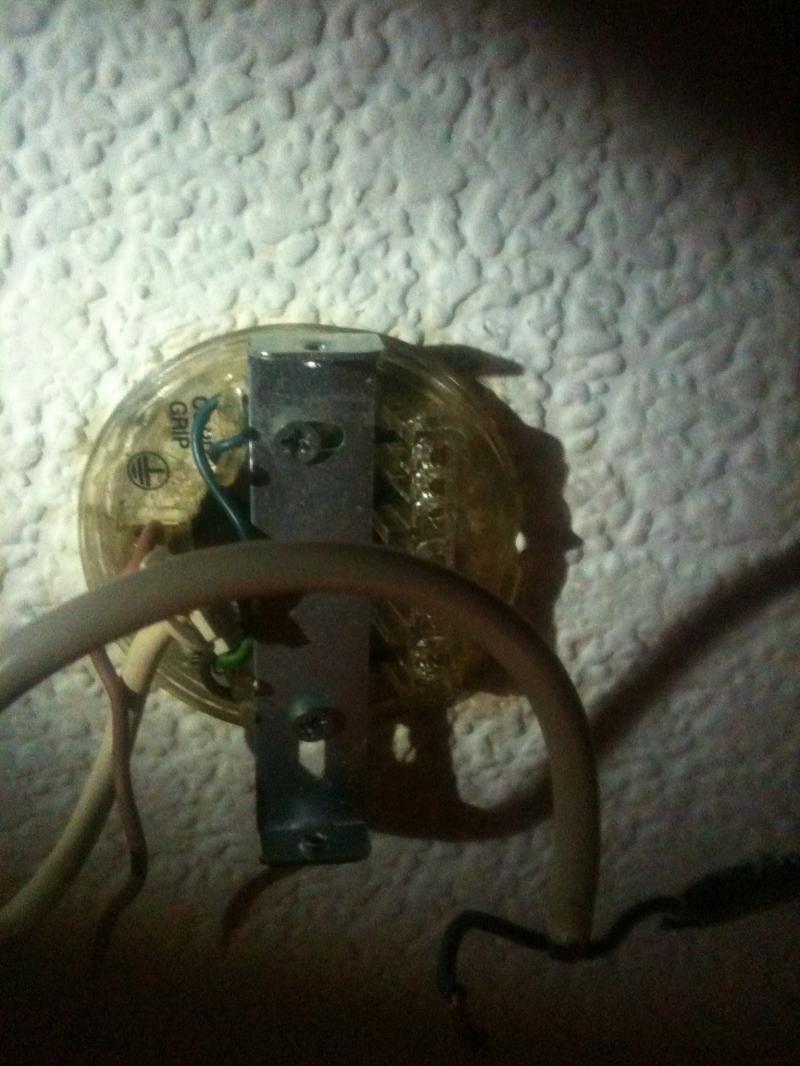

Is the switch not wired up properly? Will try get a better picture of the ceiling as well.
Not abnormal, ideally your earth should have a green/yellow sleeve on it and your black be marked up as a live conductor with a red tag or sleeve.
I assume the red cable was indicating voltage?
If you can turn the electric off, try linking the switch out and connect both red and black together in a connection strip, then power back up. Just to check your lights do work. No touchy cables while live though and touchy cables to anything else. IE back box or earth cable.
Then at least we know if the rest of circuit is operating and it's down to the switch.

yea red had the power.
just going out now to get a strip....bit worried about putting the red and black together but if that's ok will do.

ok i've put both the wires together and nothing. I seem to have lost the power now (red wire) to the switch. I've also tried a new switch and still nothing.
again nothing has tripped on the consumer unit. this is all very strange as all the other lights work in the house.
please help !
