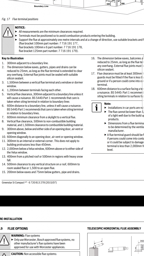

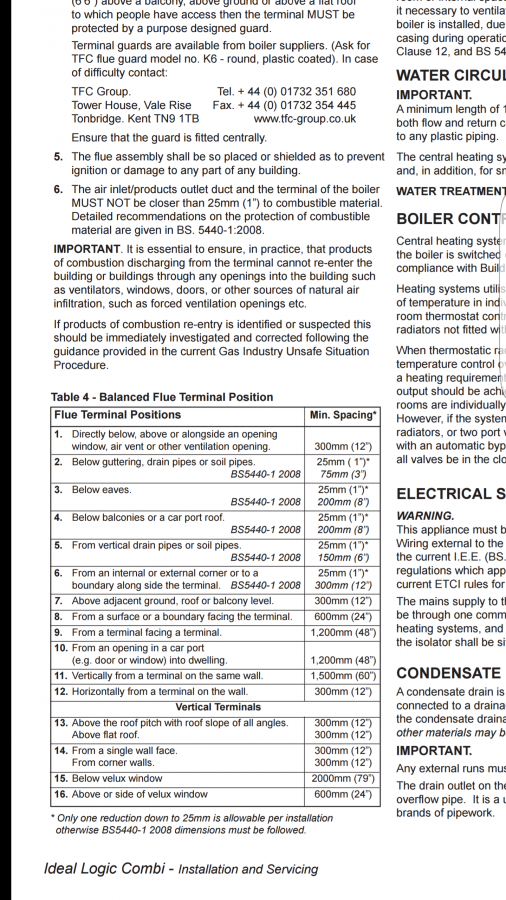

We called Gas Safe and they say only that Building Regs "Approved Document J" says that no flue can be put "within 600mm of a boundary". But that's not the wording in App Doc J. It says the flue terminal cannot be 600mm "From a surface or a boundary facing the terminal". The boundary is not "facing" the flue terminal, since in fact the boundary wall is behind the flue outlet (the flue comes through it).
Others have posted here about neighbour's boilers venting towards their properties, sometimes directly at windows and such like. Obviously dangerous and obviously what the Building Regs are there to prevent. But in this case it is not venting towards anything.
It seems we have found a problem in Approved Document J. At best, it is not clear. Gas Safe just refer back to Approved Doc J, saying it is a Building Regs issue.
Our local Building Regs (much friendlier than Gas Safe) agree that the App Doc J is unclear.
So we've got a situation where everything is safe, the neighbours are happy, but the plumber is (rightly) concerned that he will be doing something wrong.
