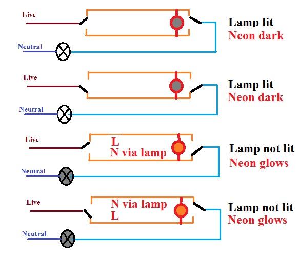

As far as I can tell, the only time when either L1 or L2 is not connected to anything - either live or the neutral fed through the lamp - then the lamp would be lit anyway.
Draw it out, I think Bernard was right...
At each switch connect the neon between L1 and L2.

When the room / carport light is off.
L1 is connected to live line.
L2 is connected to the lamp neutral.
It's only when the room light is on that a terminal is connected to nothing.

I think it should work. With the lamp off, one end of each neon will be live, the other end will be effectively at neutral through the lamp filament.

Referring to Fig 2 in this link: http://www.lightwiring.co.uk/tag/2-way-lighting-circuit-diagram/ and calling the switch to the left A and that to right B and where the light is off:
A com = Live (permanent)
A2 = Live
A1 = nothing
B com = switched live to lamp
B1 = nothing
B2 = Live
There's no neutral present - unless by that you mean a neutral leak through the 'off' (fluorescent) lamps.
Curiously, both neons illuminate in one of the two possible 'lamp off' settings.

As far as I can tell, the only time when either L1 or L2 is not connected to anything - either live or the neutral fed through the lamp - then the lamp would be lit anyway. ... Draw it out, I think Bernard was right...
Oh, I see your point. Yes, I agree - so long as the light is off, it will work. That might be OK for OP, if the switches are both in positions which are illuminated by the light. I thought that he wanted the neons always to be lit.

As you will see, there has been some 'talking at cross purposes' at work. I thought that you wanted to neons to always be on. If it is acceptable for the neons to be on only when the light is off, then bernard's proposal will work.

Don't mind if the indicators are always lit.
R
But you're ok with the neons being unlit when the main light is on, aren't you?
After all, you shouldn't need the neon indicators when the main light is on.
If the op really wants the neons on all the time and the conduit is big enough he can run two extra wires, live and neutral, to serve just the neons.
