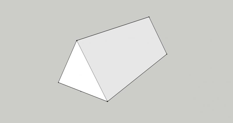

Err, I'm a little confused, you're working out the volume for your loft and treating it as a pyramid like this:
Using the calculation for a three sided pyramid: 6m x 3m = 18m x .5 = 9 x 3.2 = 28.8 x .3 = 8.64 cubic metres.
Yet here, you're working out the volume for your loft treating it as a shape like this:
However, if I calculate the area as a cube, ie 6 x 3 x 3.2 = 57.6
divide this by 2 then by half again (since half this roof space was already in existance) the answer is 14.4 cubic metres.
and you wonder why you're getting different results? :confused:
Or have I lost the plot? :p

Wish I could do the drawings - anyway no its not like that!
Looking at your last diagram - if you remove the blue part, imagine drawing a line back along the ridge of the roof 3m, drawing a line from this point to where the edge of the floor and front wall would meet this makes the pyramid shape.
The widest point of 6m is from side to side as you look at the gable end.
Does this make it any clearer? :confused:

As the volume of a pyramid is 1/3 B X h, where B is the area of the base, and h is the height - that works for a pyramid with any shaped base.
The original hipped roof would have had a volume of 1/3 X 6M X 6M X 3.2 M = 38.4M^3
Splitting the present roof into two volumes,we have:-
A pyramid, 3M X 6M X 3.2M
And a prism, 3M X 6M X 3.2M.
For the pyramid, B= (3M X 6M ), and h = 3.2M
the volume of the pyramid is 1/3 X 6M X 3M X 3.2M
=19.2M^3
For the prismatic section, the area of the triangular cross-section is 6M X 3.2M / 2 = 9.6 M^2 (the area of a triangle),
multiplied by the length, 9.6 M^2 X 3M
=28.8M^3
Adding the two volumes together gives a total volume for the roof of 28.8M^3 + 19.2M^3 = 48M^3
