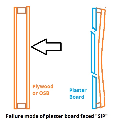

I was making the point that there are several ways to build a house with timber as the load bearing material. It is cost cutting in the mass housing construction industry that has "muddied the water".
SIPs were designed with two skins of plywood or OSB. Changing the design to have one skin of plaster board has reduced over all build cost but adds a failure node to the "SIP" SIPs with two plywood skins resist bowing in any direction, "SIP"s with a plasterboard skin have much reduced resistance to bowing as the plaster board when under tension will crack.

I wouldn't even contemplate resting a steel on them as is, I am just trying to get an idea of the different methods (if any) of converting this kind of roof as timber kits are the most common build these days and every loft conversion company seems to convert them no problem, yet all the videos and pics available all have block walls for the beams. I don't mind opening up walls to put in more studs if that's the only way to do it but that's eight areas of the house to open the walls, 2 of which has a staircase and kitchen in front of them!!
