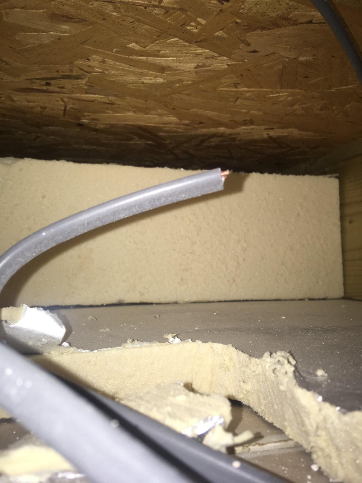

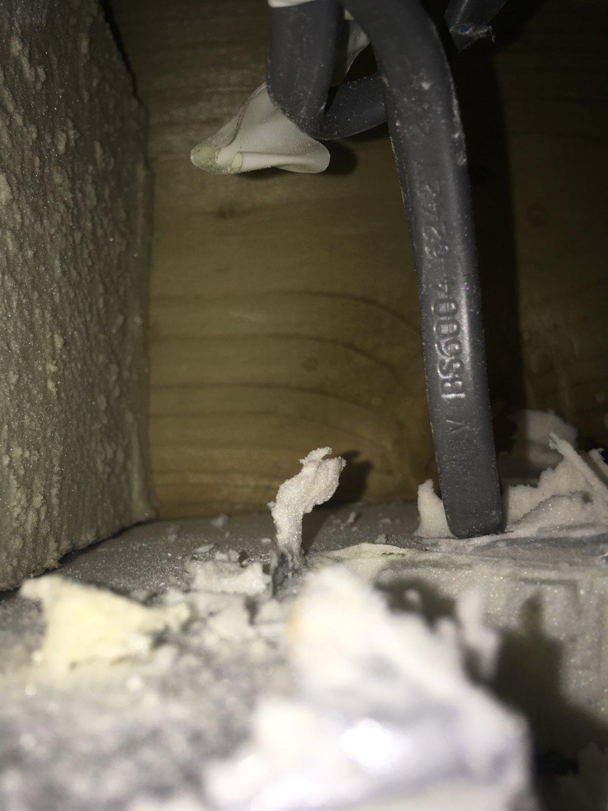

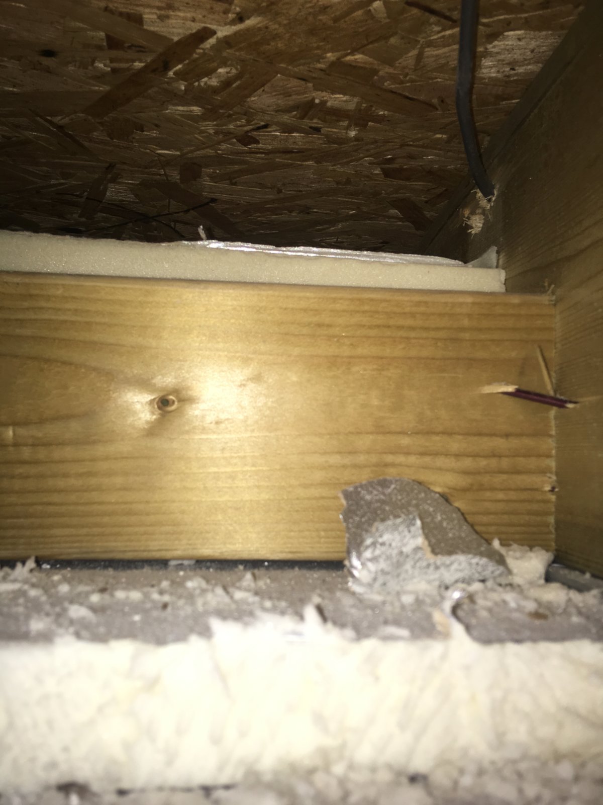

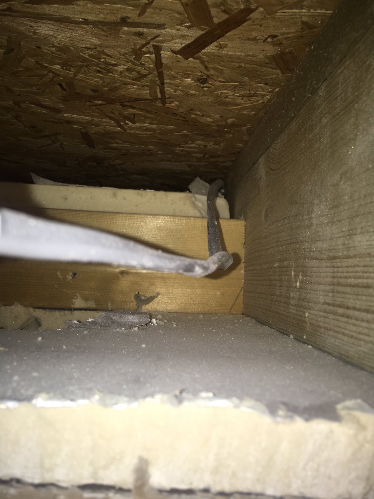

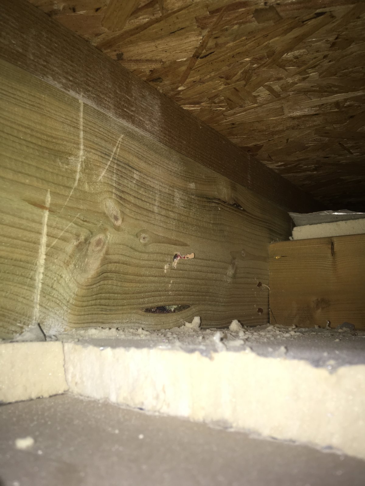

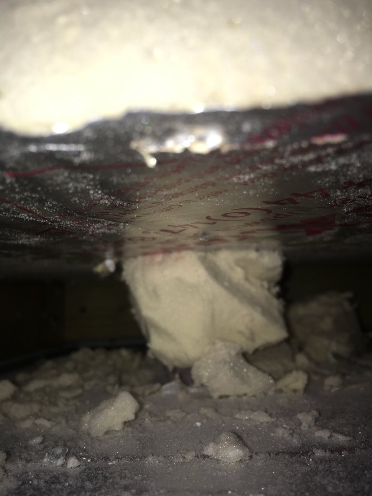

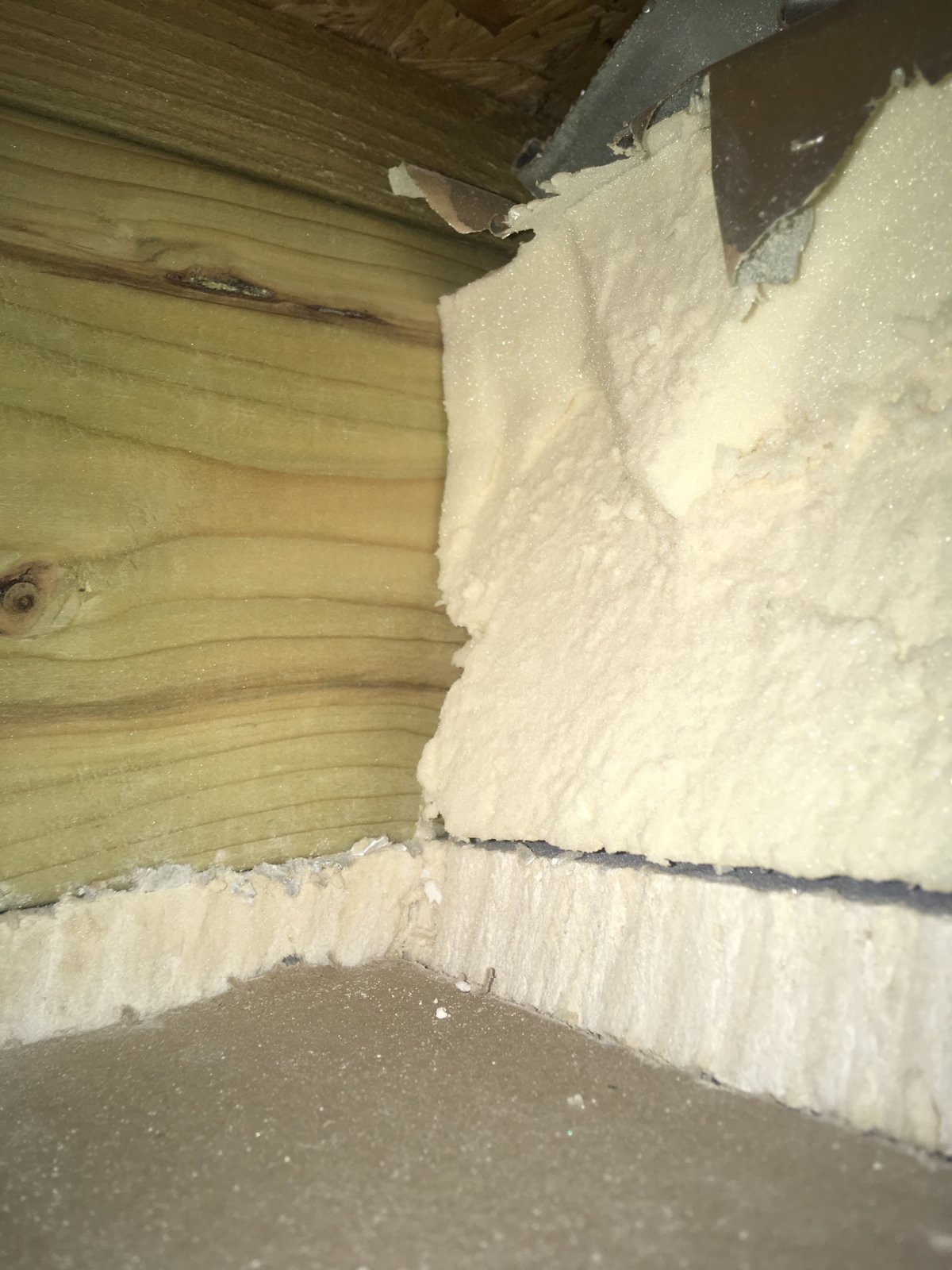

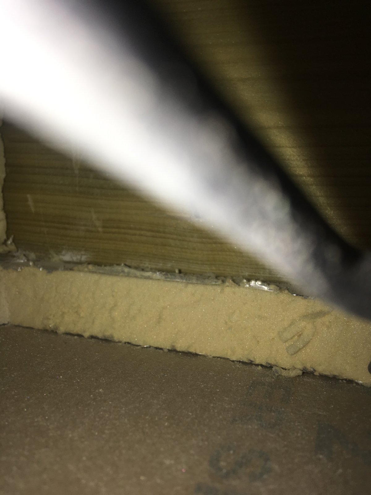

IMG_4032.JPG IMG_3794.JPG IMG_3795.JPG IMG_3796.JPG IMG_3797.JPG IMG_3798.JPG IMG_3804.JPG
Here's some photos taken with my phone through a number of different spotlight holes showing underside of flat roof, and the insulation.

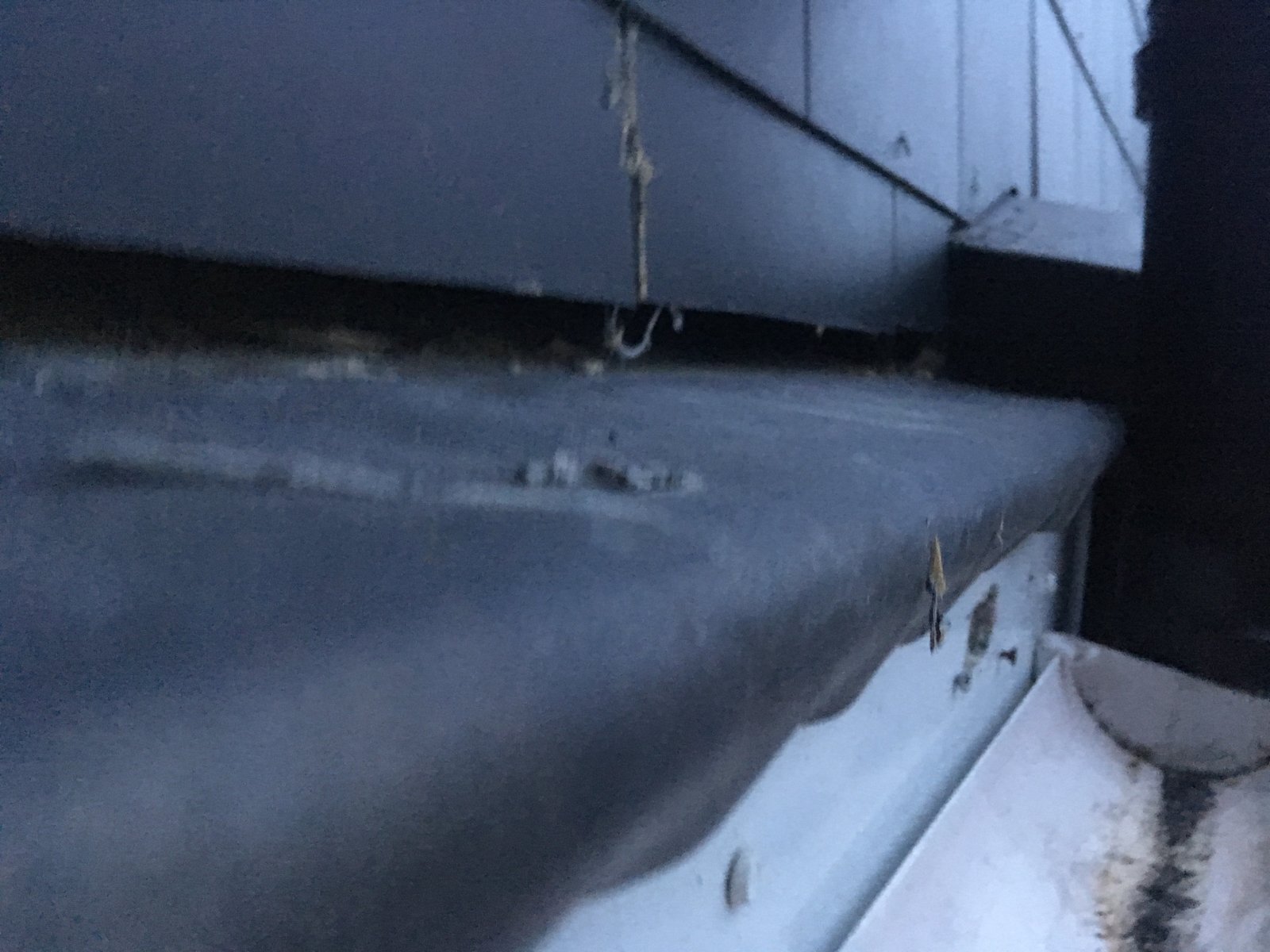

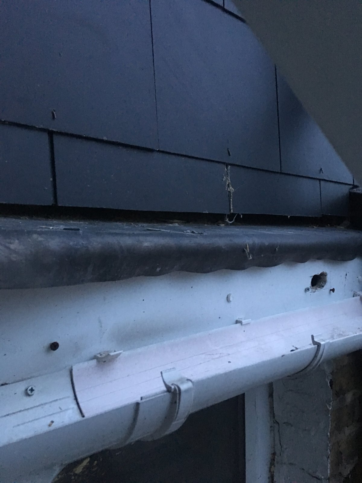

It’s very very close to the gutters. You would struggle to get any insulation in there unless you lifted the floor inside and put some insulation between the dormer wall and ceilings below.
This was something I was told by a loft builder.
If you think my loft company do around 30 lofts per year.... at £700 a pop for the Private Building co.... That's over £20k p.a. of business the builder is giving the BC company.
Why else would my builder recommend them? .... there's something in it for the builder no question about that. Perhaps a financial kick back or BC turn a blind eye here and there.... enough to raise my suspicion and ask questions.
Main advantage with using private is the ease of use, I used one for my build, they were happy in most instance just to recieve photo's of work progress. Saved me lots of time as no waiting around for council officers.They don't work for the builders but with them , subtle but important difference.
We did that in fact where we could before the bathroom tiles were laid. My question is - should the slate tiles not be flush/all the way down to the lead flashing? Rather than there being a gap there?
I don’t know. I guess if they touched they could damage the lead over time.
