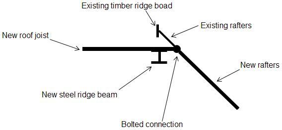

Dear all,
I have a question regarding structural calculations for a loft conversion.
When converting a loft the original structure supporting the front half of the pitched rood is essentially left in place (except for the purlin replaced by the dwarf wall). Below is a typical detail.
My question is: how much of the weight of the front slope is supported by the new ridge beam and how much is supported by the existing structure?
Is there a rule of thumb / industry practice when doing these calculations?
Many thanks,
Max
Calculate the loads on plan by square metre but allowing for roof slope. e.g. one square metre of roof at 45° pitch is 1.4m on plan. Do a sketch of the roof plan and mark the load points. i.e. this is where the load is taken to. In a simple beam supported at ends, 50% of the load goes one way and 50% the other. A roof is treated exactly the same. Once the loads are calculated as above you ignore the slopes and distribute the loads on plan.
