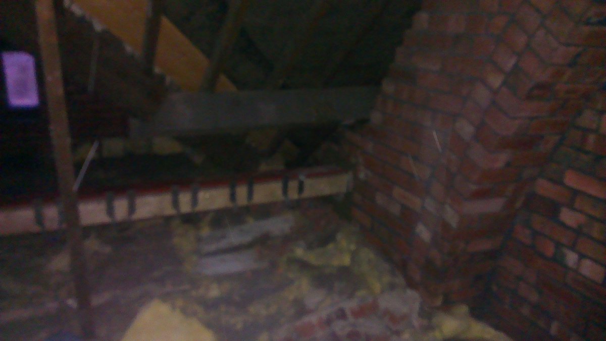

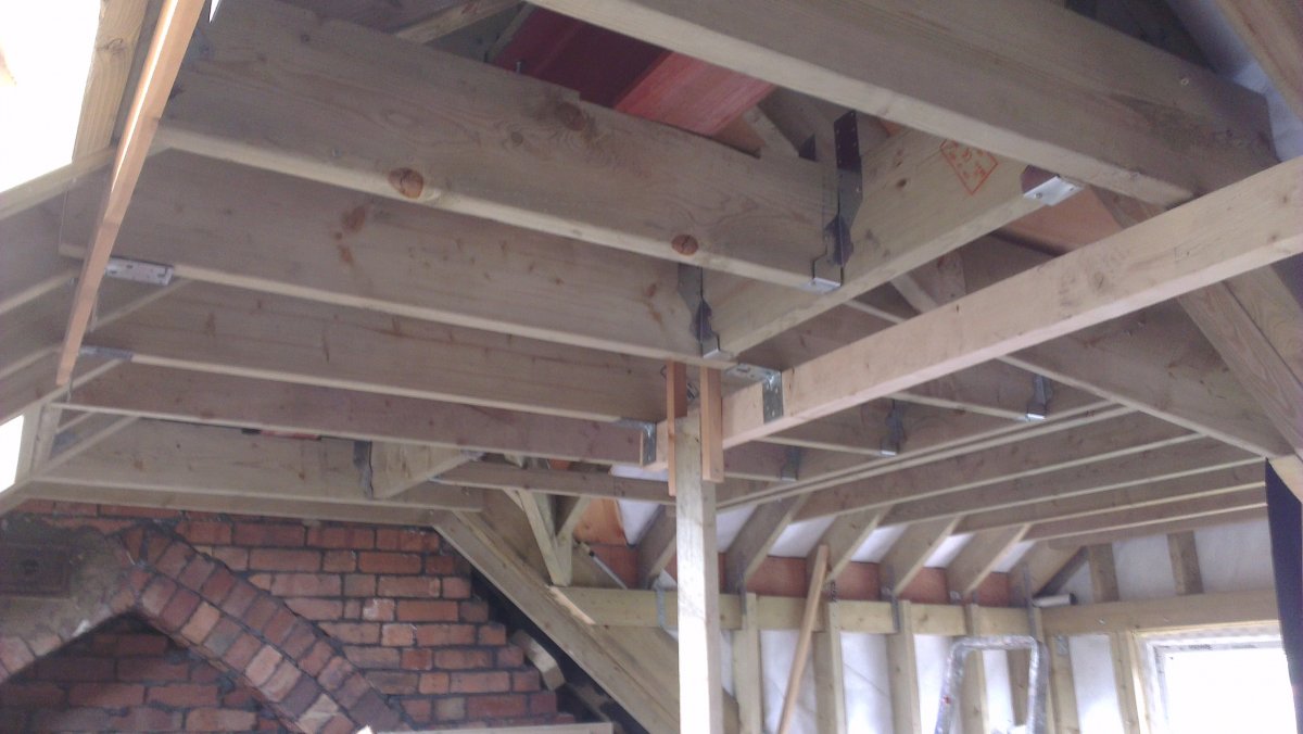

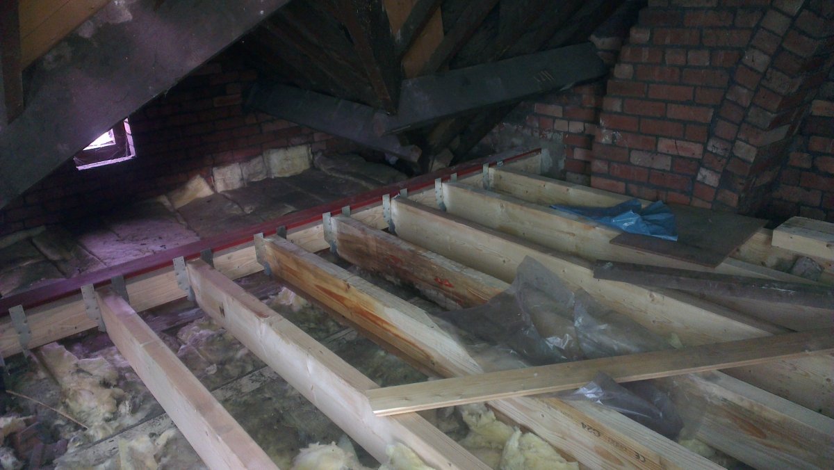

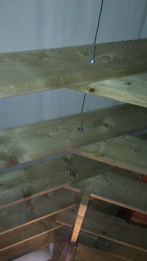

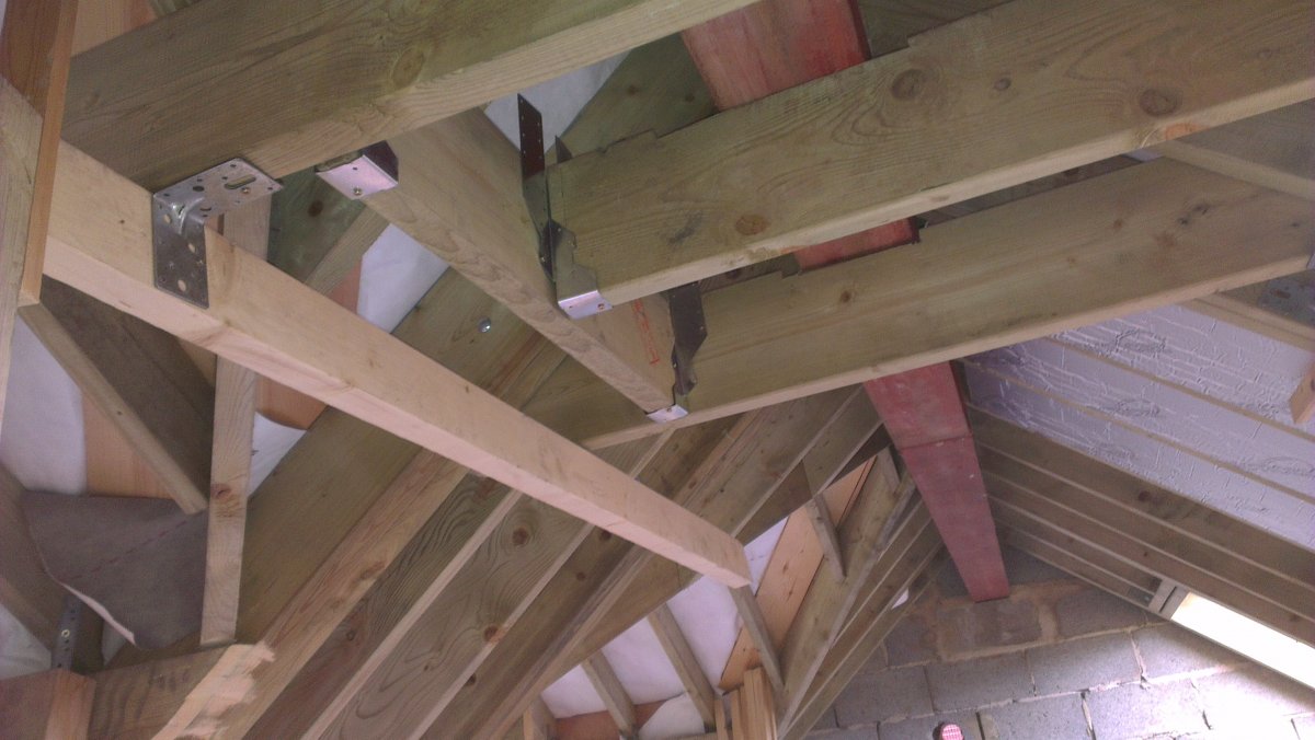

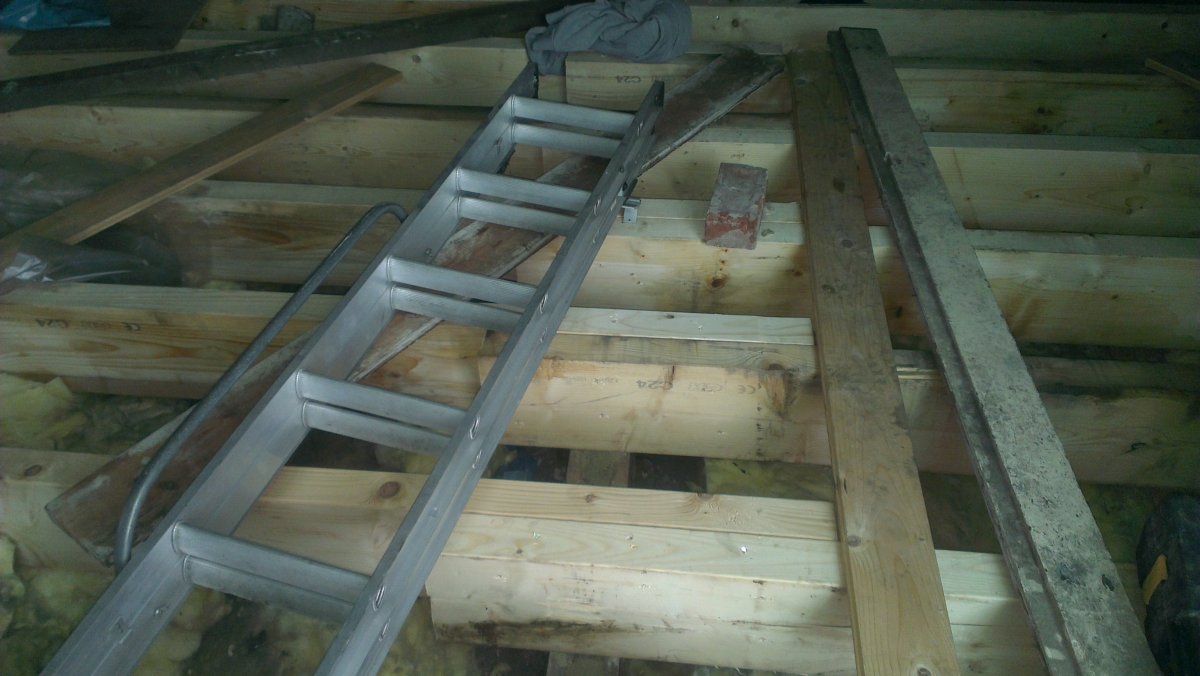

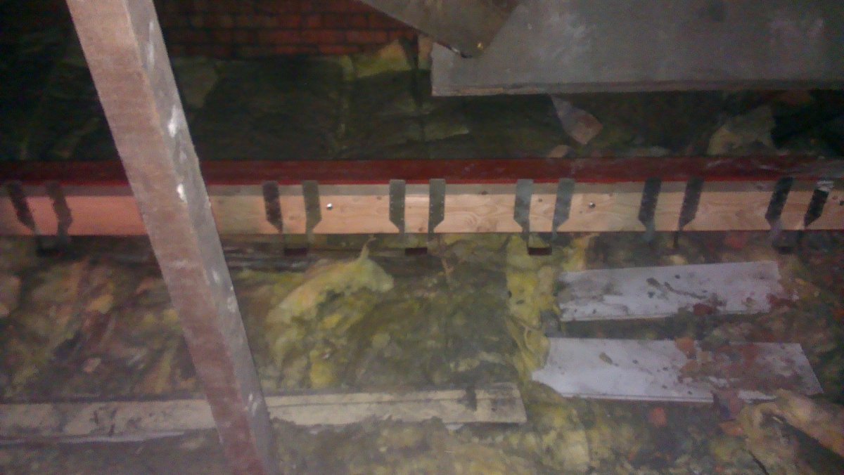

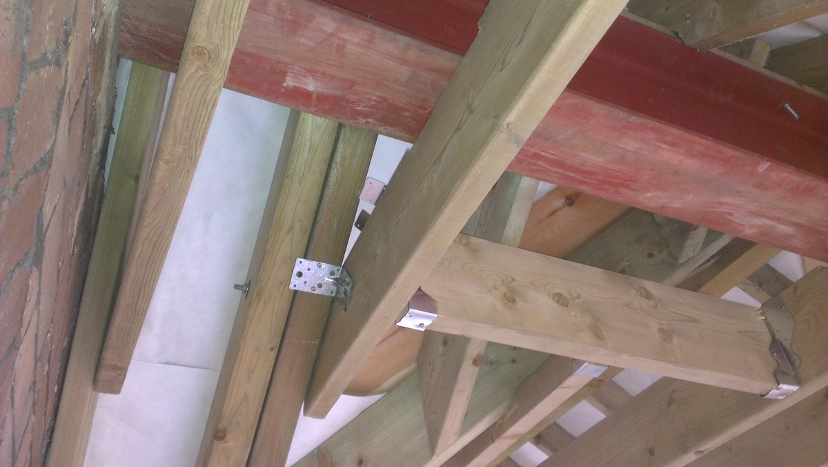

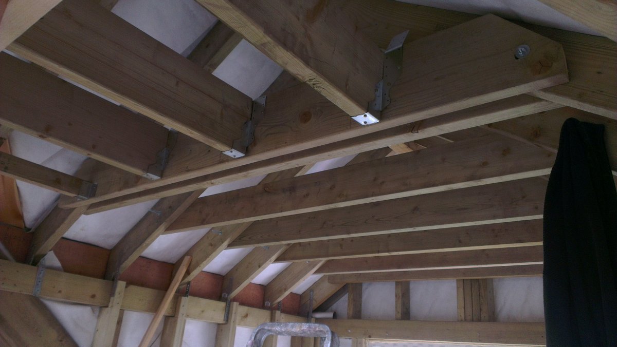

Well guys,
I live in a semi detached house that had a hip roof. I had a conversion to a gable end and have been working slowly on the insides on the past few weeks.
I am going to try and do as much as I can DIY apart from gas and electrics.
My latest update is the ceiling I am installing using 8x2 and 6x2 on the dormers.

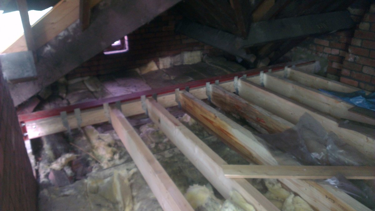

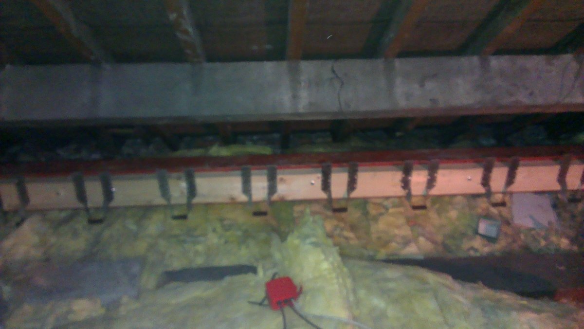

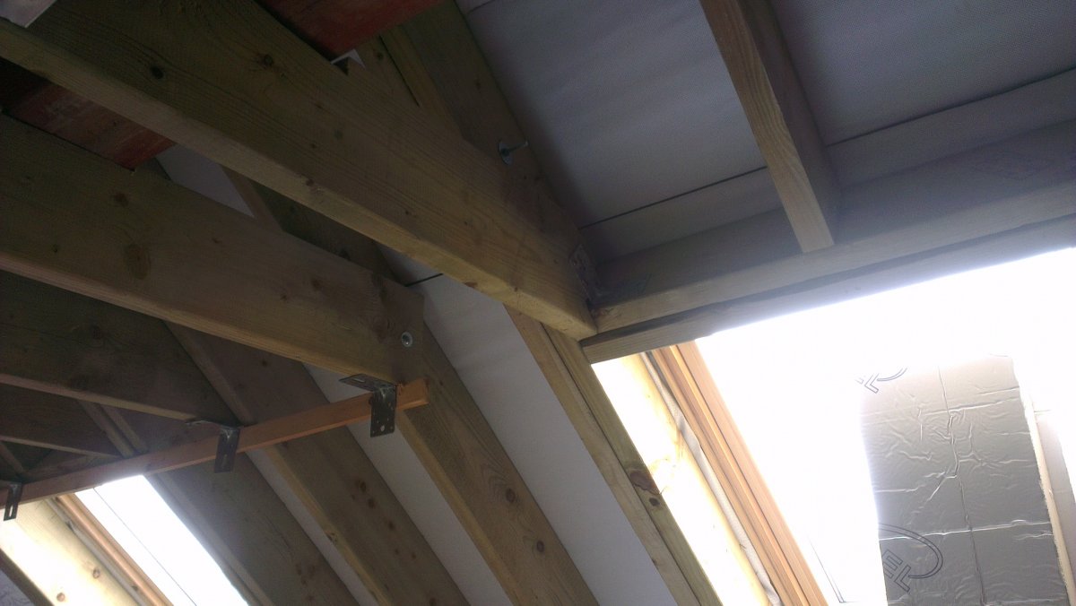

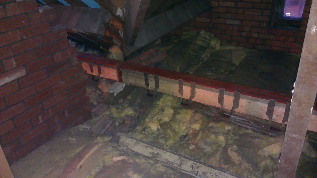

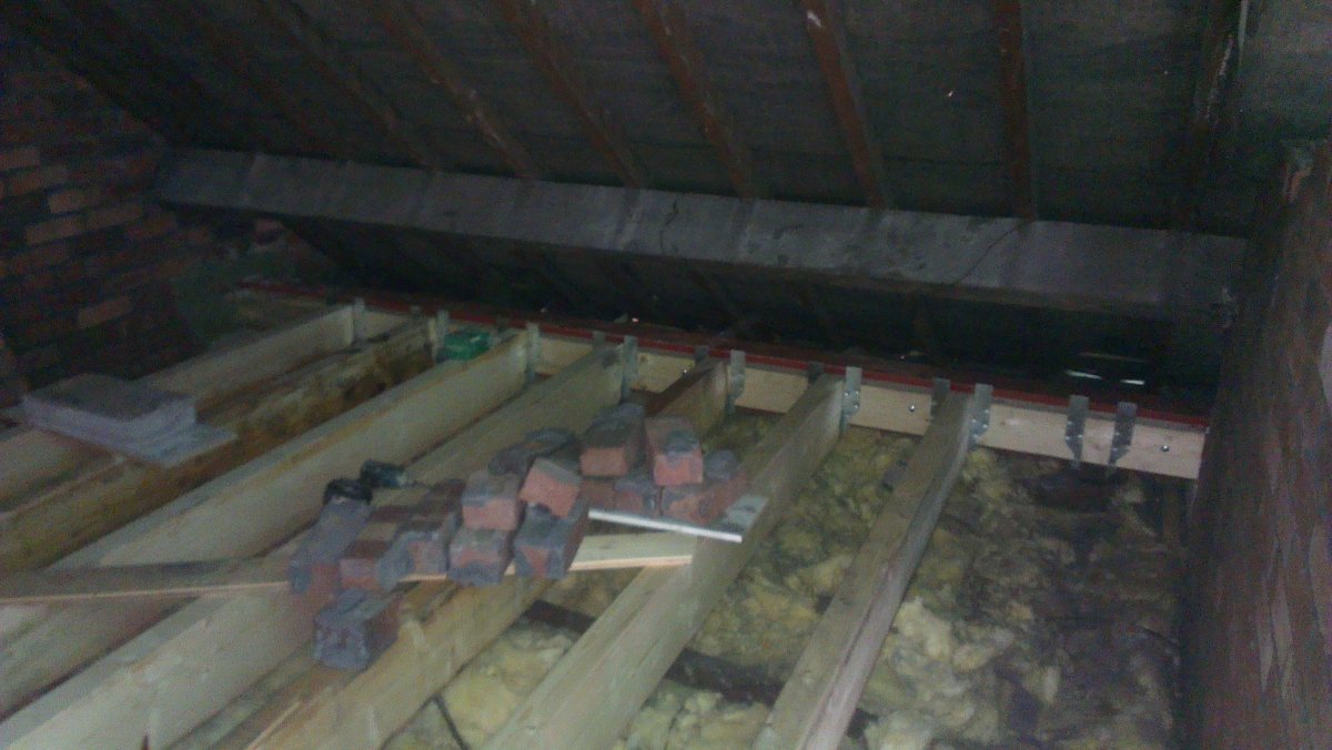

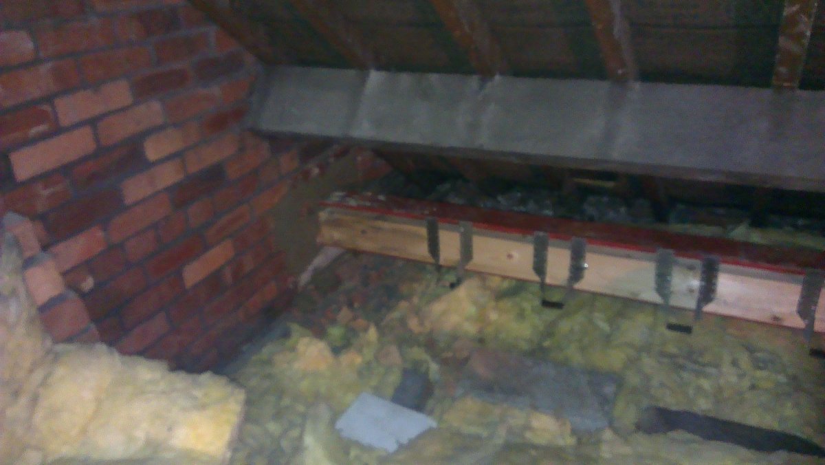

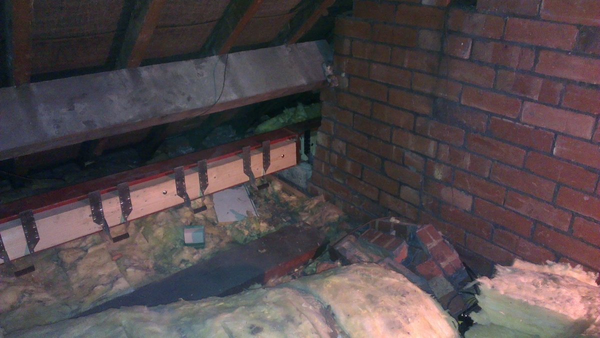

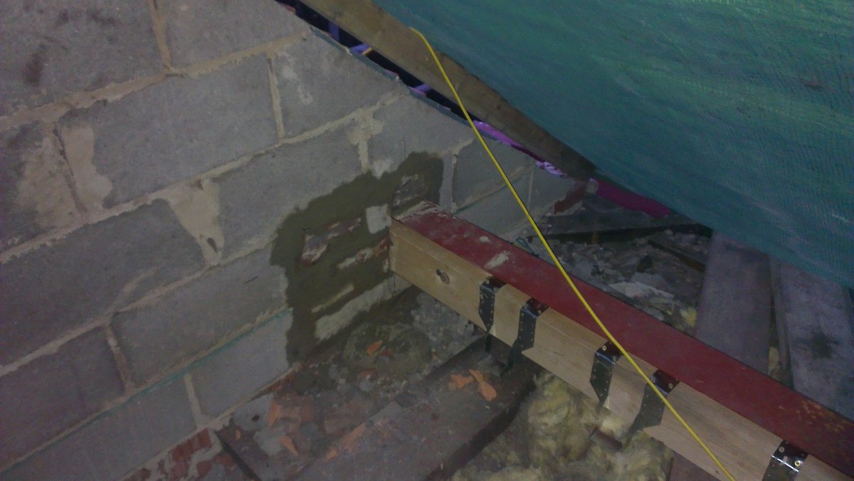

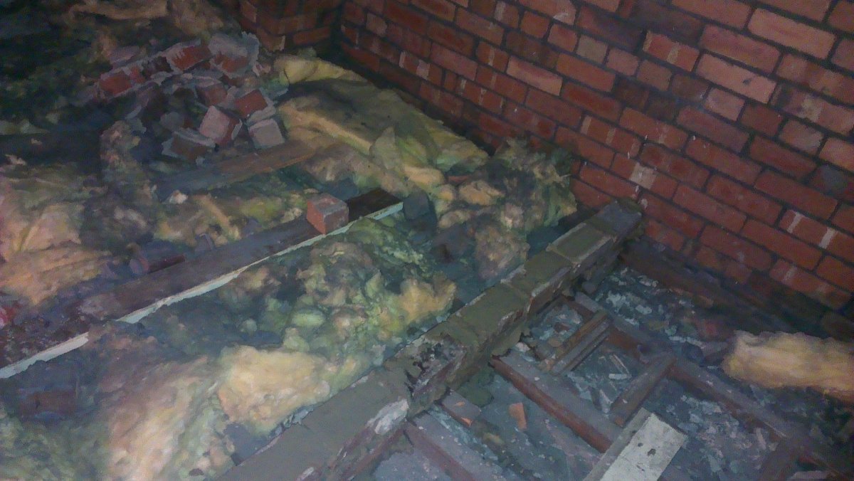

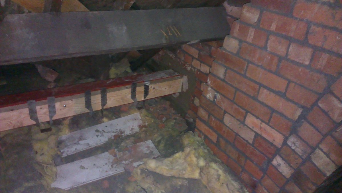

It was hard work getting the RSJs up.
Only took pictures of the floor and nothing really of the dormer construction... but it is not easy work! The timbers you work with are pretty heavy and require multiple hands!.

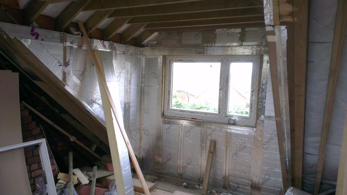

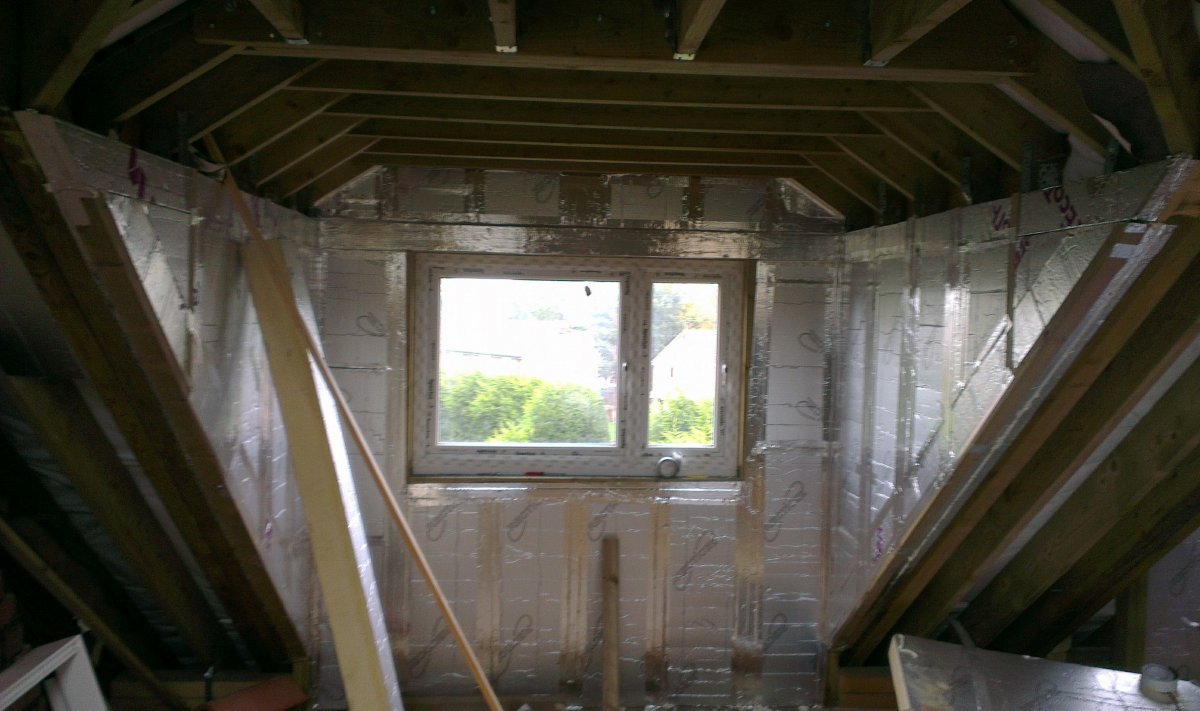

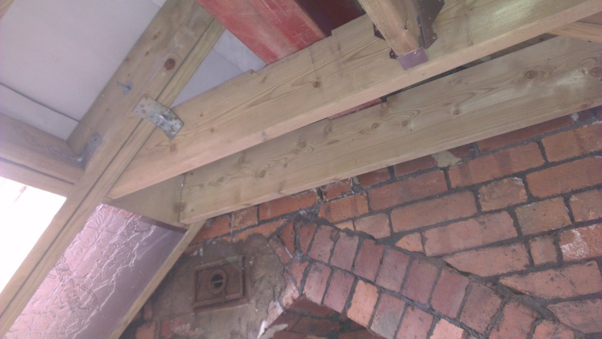

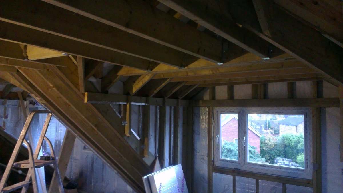

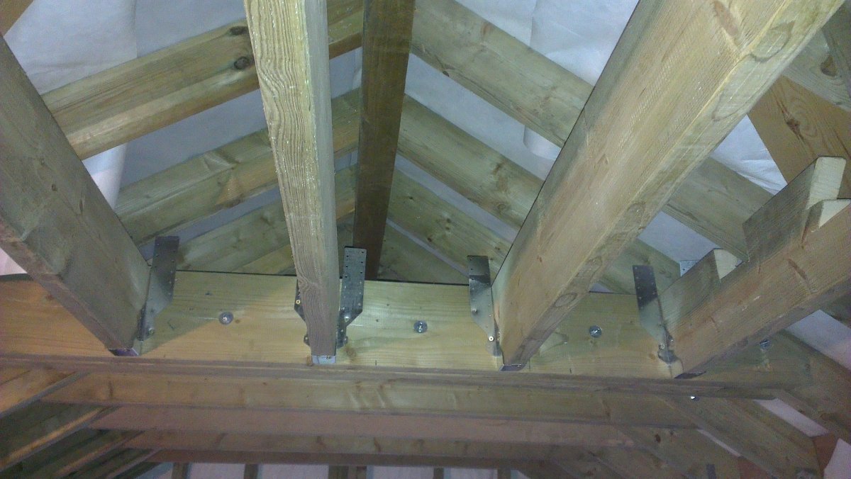

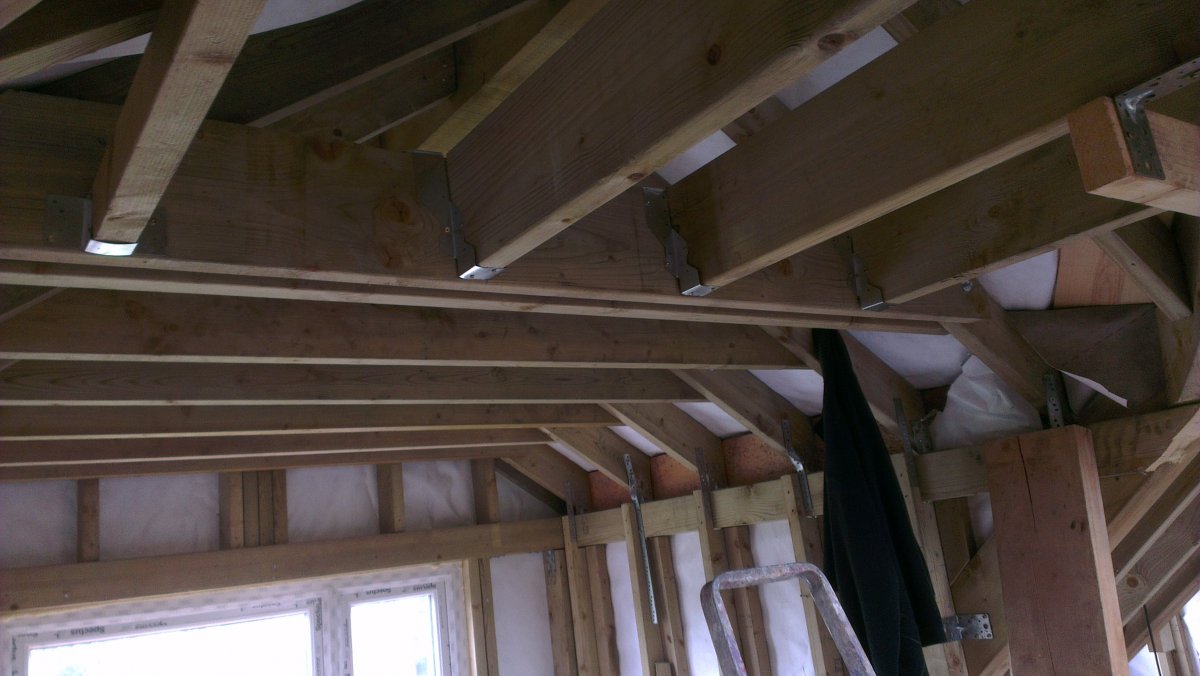

Update from last few weeks of work!
Dormer 1 insulation has been inserted.
Ceiling level is complete... through out the entire loft have a few more bits of wood to measure up and deploy.
Timber bolts in to hold everything in tight. (I dont see the point as i cant see a 8x3 @ 6 meters moving on its own!
Working on my own.. its slow progress!
