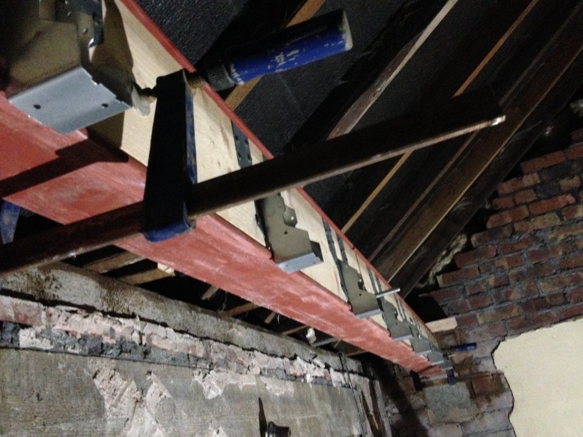

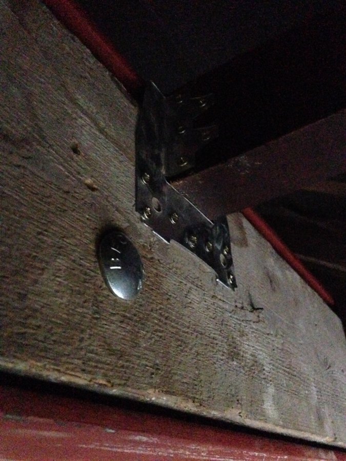

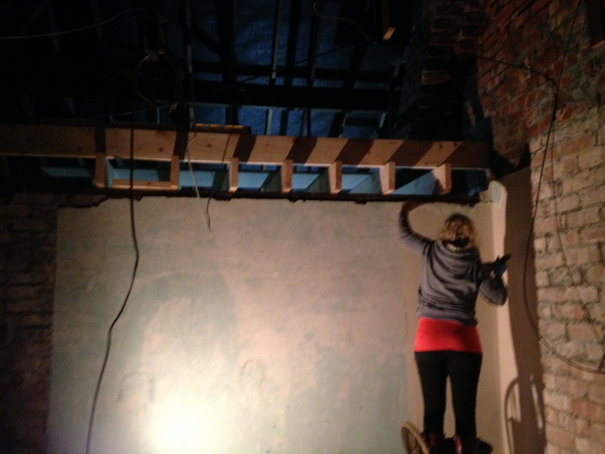

I nailed the hangers onto a 7x2 and bolted it into the steel. I bolted another piece of wood to the back of the steel too and reinstated the ends of the old 3x2 bits to the wall plate. They were originally fixed with a single nail which came out with a push up, I had a sleepless night after pulling them down so did that for piece of mind. They were not attached to the rafters.
Then I removed 2 layers of brick from the centre wall and my apprentice bedded on a piece of 4x1.5.

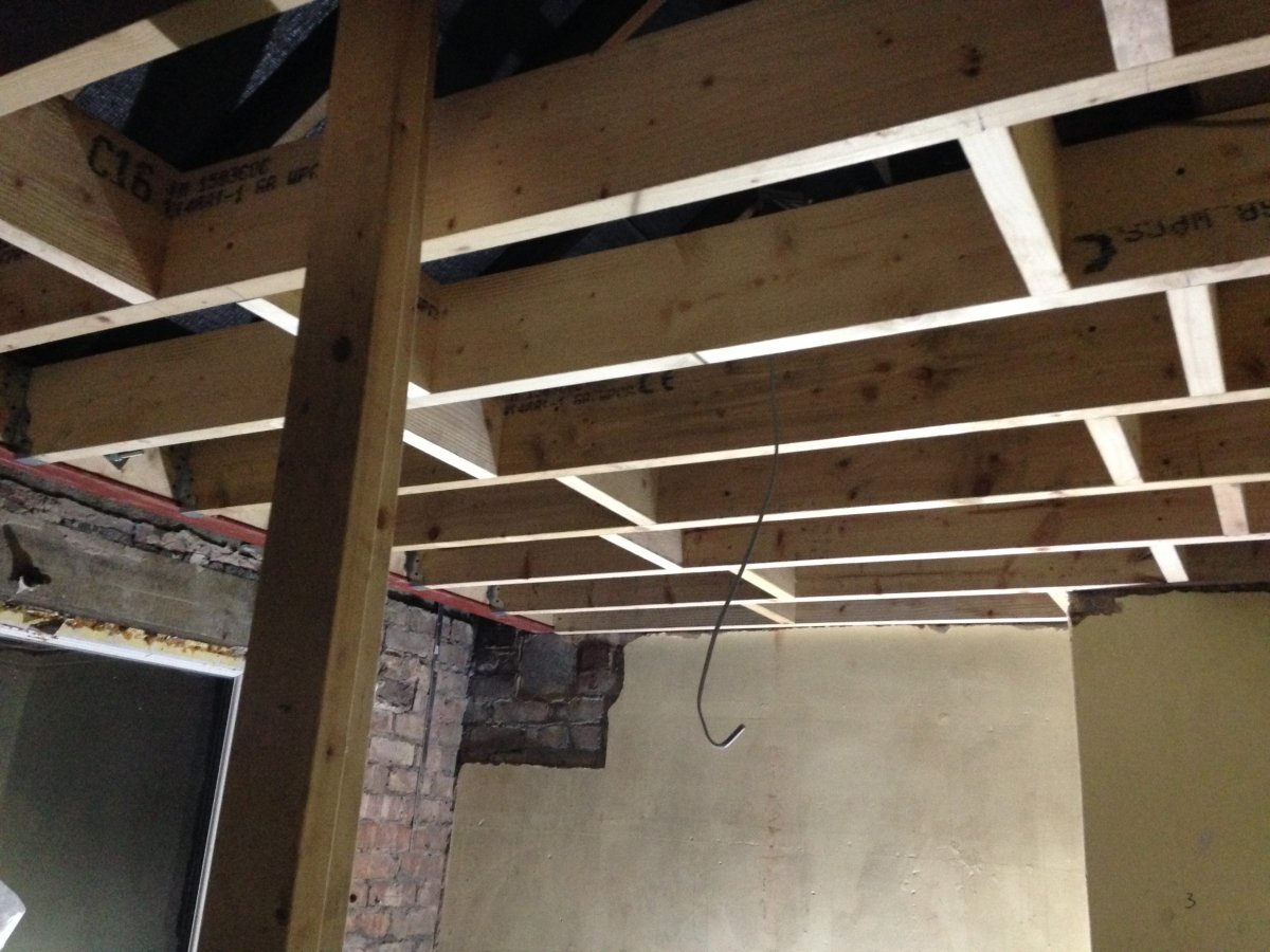

I ran the 8x2's from the hangers to the centre wall. I got the 8x2's in a 3.6 mtr and cut 35cm off each to use as a noggin. I bolted the furthest one to the wall.
I got a long L-strap which I fixed to the wall and first 4 joists.
Few questions.
Should I also strap the new wall plate to the centre wall or could I fix through it into the brick?
Should I nail the 8x2's to the 7x2 near the top where they are out of the hanger?
When I clamped the 7x2 if lifted itself to the flat vertical part of the RSJ, should I now fill under it with mortar or something else, small wedges??
Any other advice?
Thanks.
The centre wall plate should have been bedded onto a layer of cement, and should be going anywhere with the joists sitting on top of it, and I assume nailed down on to it as well.
It won't hurt to stick a screw or nail either side of the 8x2s in to the 7x2 for a bit of added stability, but with the noggins in place, they shouldn't be going anywhere.
It's looking good, well done.
Thanks :)
The centre wall plate is on sand/cement but not fixed down or fixed to the new joists yet. It was a bit of the old roof and a coincidence that it was the perfect size!!
Put a couple of screws in each joist on to the wall plate, and you'll be fine. The weight of the joists will happily keep it in place.

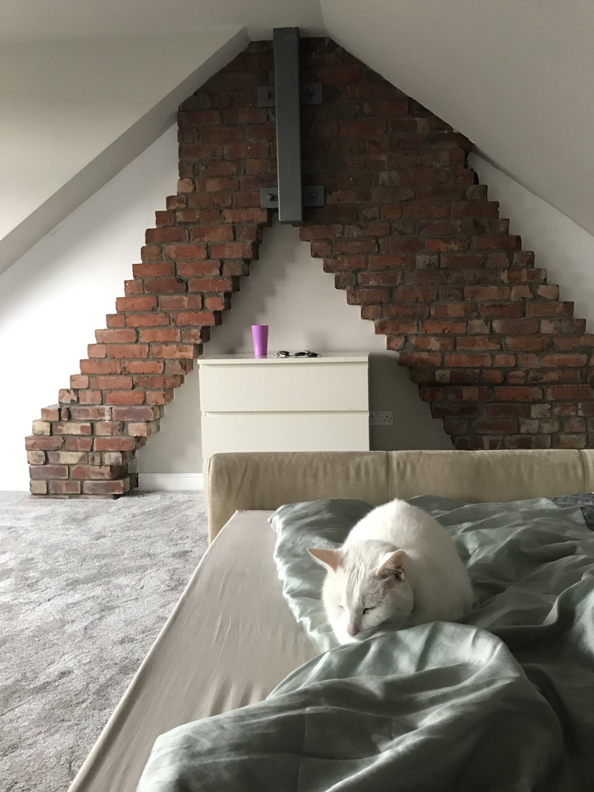

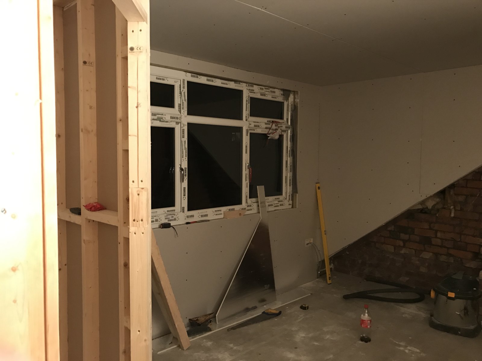

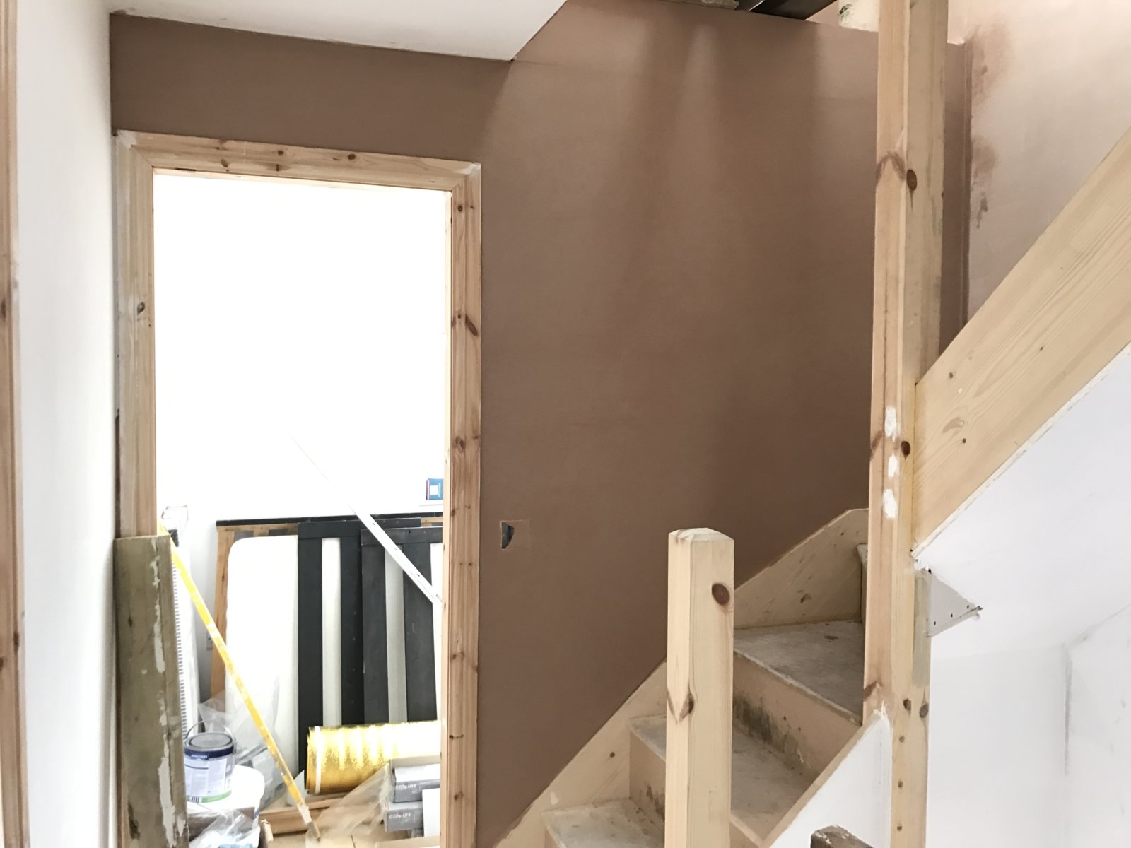

Not bad, I sleep in there now :)
It's give a big bedroom, decent walk in wardrobe, onsuite (not done that yet) and storage.
Love that exposed chimney breast! It is the new master bedroom now? assuming it's your house.. lol

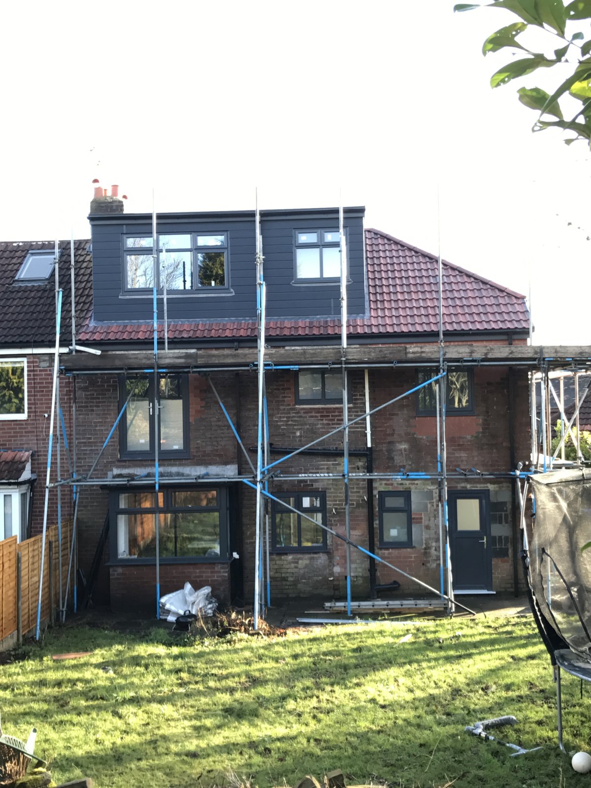

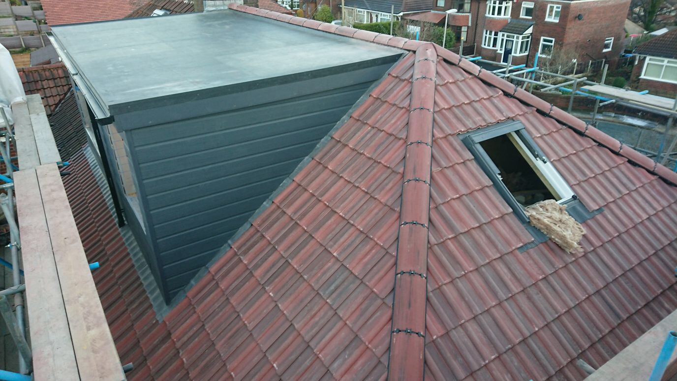

Is that dormer roof GRP? And may I ask how was planning success with such a large dormer? Looks to be over PD threshold size?
beers!
Yes, new master bedroom. The dormer just squeezes into PD, it's something like 560mm back from the eaves, the roof is extended about 30mtrs over the extension and the dormer is about 18mtrs.
