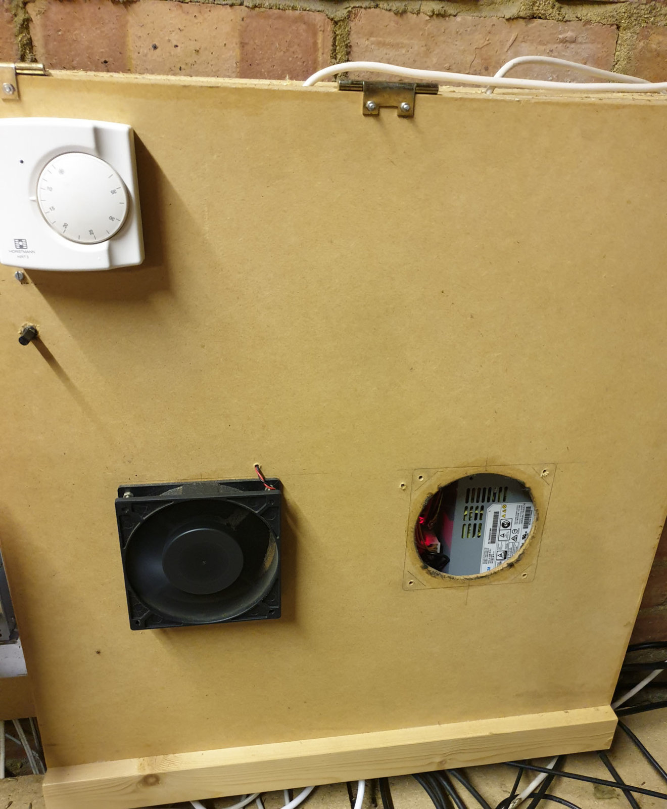

Here's the fan board with thermostat that hangs in front of the vertically mounted Hikvision DVR. There were originally two fans fitted but we found only one was needed. The thermostat turns on the fan above 12C. Below that no air cooling is needed.
As you can see through the hole, the fan is very close to the uncased DVR.
At the time of measuring, the outside air temp was 33C and the air inside the loft was 44C.

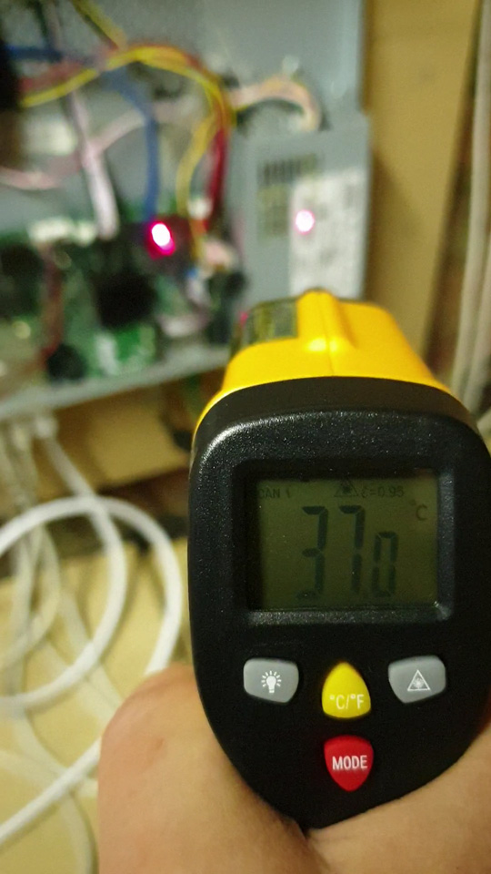

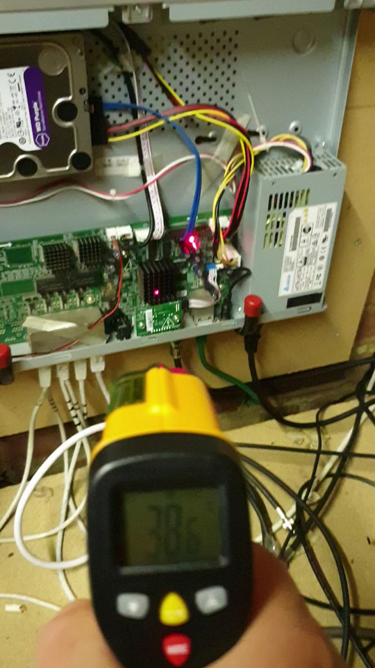

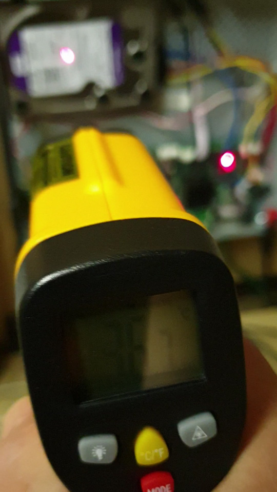

With the fan lifted out of the way, the CPU temp was 38C, HD was 36C, PSU was 37C, as you can see in the pics. You can see the laser dot in the pics, and the board LED to show that it was switched on!
Excuse the poor quality pics - I had the thermometer in one hand, phone camera in the other, and I had to take the pics quickly because with the fan removed the CPU temp was shooting up - 43C after just one minute.

Our outside temperature at 4pm yesterday was 36C. I briefly entered the loft where the ambient was 48C. None of the DVR components measured over 40C on the laser thermometer. I think this fully justifies the cooling method, which used a £20 thermostat, a redundant computer fan and an old cupboard door.
