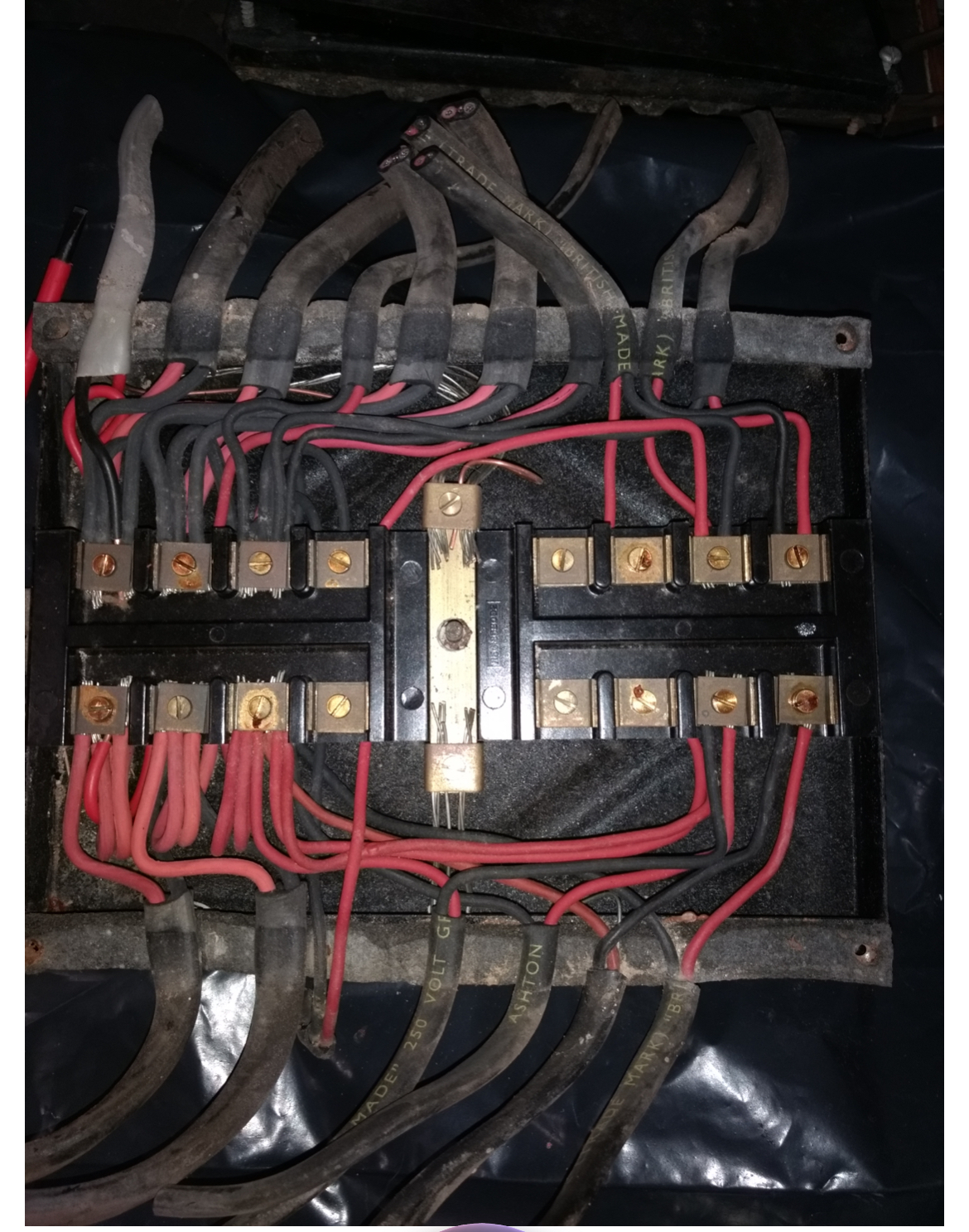

Any advise greatly appreciated.
Had old ceiling rose connector what a mess when wanted to changed light, 5 cables to all rooms, anyway got a
Hager Ashley/ Klik Ashley J501 16A Downlighter Junction Box Terminal Connector​
is good but yup too small cant get all the cables in as crazy small but good as got the LOOP...so know where to put the cables.
Can someone please advise a box that would fit multiple cables I can stick inside loft above celling like this, if not got LOOP do I just put all LIVE together same as LOOP, already got the switch and black switch live on working with the Hager but only until I get the bigger box.
Thanks a lot!

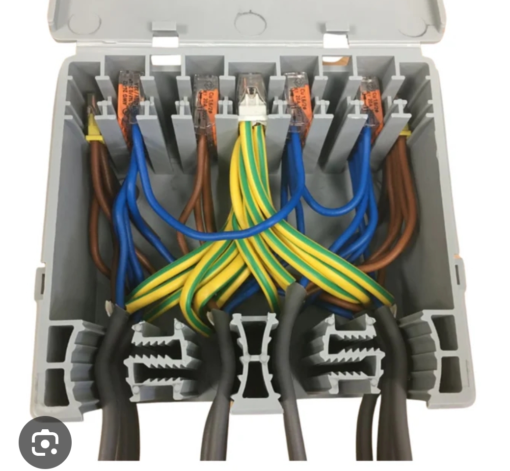

Ok so XL wago with normal size assume all same size connectors, for the LOOP on the rose, is that same just adding the loop cables into the same connector block
only need 4 but 5 will do and then 2 and a 3, so these fit into the XL box...thanks again
Yea seems wago the modern way now, always said why are we still doing old screws method...always seems a bit primitive now, but then radiators big metal things on wall, whats that all about, is it not the future lol, thanks both.
