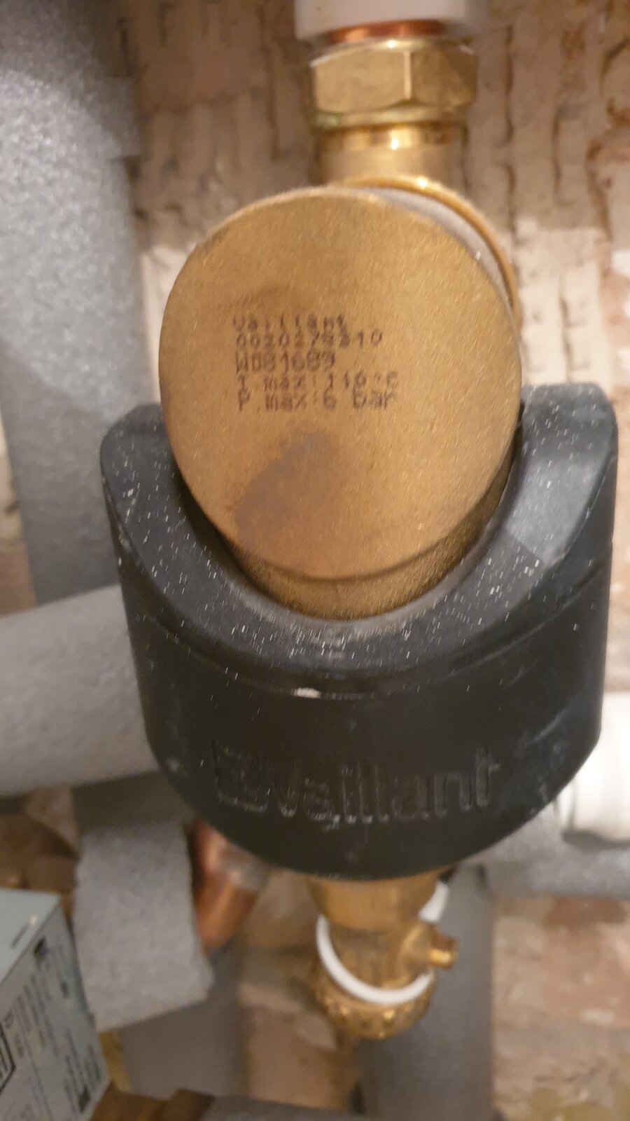

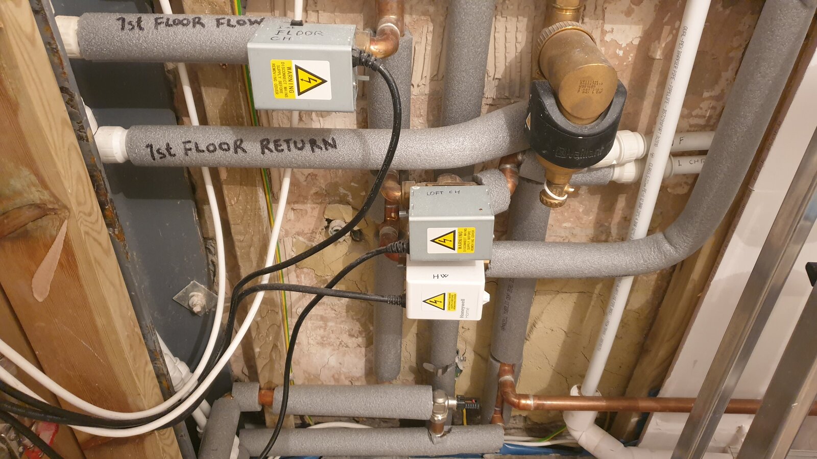

Boiler, stuff under it, pump attached to tank, manifold, manifold pump.

What does the Wilo supply?
Is there another pump that maybe supplies a low loss header?
Can you see which one supplies the rads.
What is the boiler system pressure?
The Wilo loops in and out of the tank. So no factor.
Only that orange pump attached to the manifold I can see. Otger than the black and gold Valiant block, nothing else.
Boiler pressure 2.0 bars but its on right now, I would say 1.5 when off from memory.
The Orange ("Warmer") pump is the UFH mixing UFH manifold pump so IMO can't circulate the rads, there may/must? be another pump maybe in the boiler itself that supplies water to the UFH pump and probably circulates the rads, the Vaillant is a system boiler so should have its own pump I think. I can find a emanual for a 376/5/5A but not for your 386/5/5A. You might look at the "d" parameters, around d.027 etc for more info.
