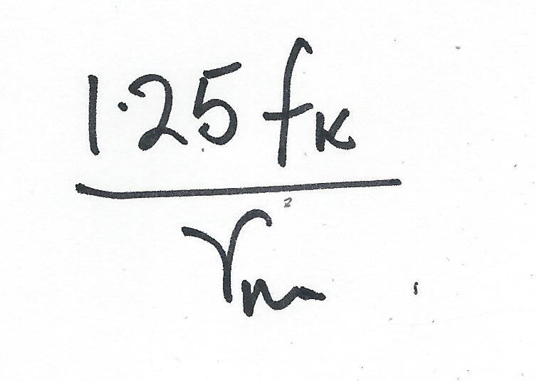

OK, a 36.2kN load on a 900x100 bearing gives a stress of:
(36.2 x 10 ³)/(900x100) = 0.402 N/mm ²
Allowable stress:
Assume worst case of 5N brick in M2 mortar, fk = 2.2N/mm ² .
Assume worst case partial safety factors gives:
fb = 1.25 x 2.2 / 3.5 = 0.786 N/mm ²
As you can see, the allowble stress is almost double the applied stress.
So...
Area of bearing required for a load of 36.2kN
36.2 x 10 ³ / 0.786 = 46702mm ²
You need a 550x100x300 high mass concrete padstone.
Or if you can, make it 440x110x215 high.
Use prestressed concrete lintels and they will be OK at 140mm high.
As for the calc on steel bearing plates, the calc is simple for an SE.
Simply take the maximum allowable stress (or reduce it slightly), and treat the plate as two cantilevers from the centre of the beam (the flange can also be taken into account). Then work out the bending moment. Choose a plate thickness that has sufficient capacity to withstand this bending moment, but also look to keep deflections to an absolute minimum.
A 500mm x 100mm x 20mm thk plate would be sufficient for a load of 36.2kN on 5N brick in M2 mortar.
