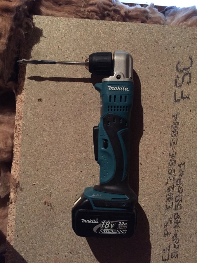

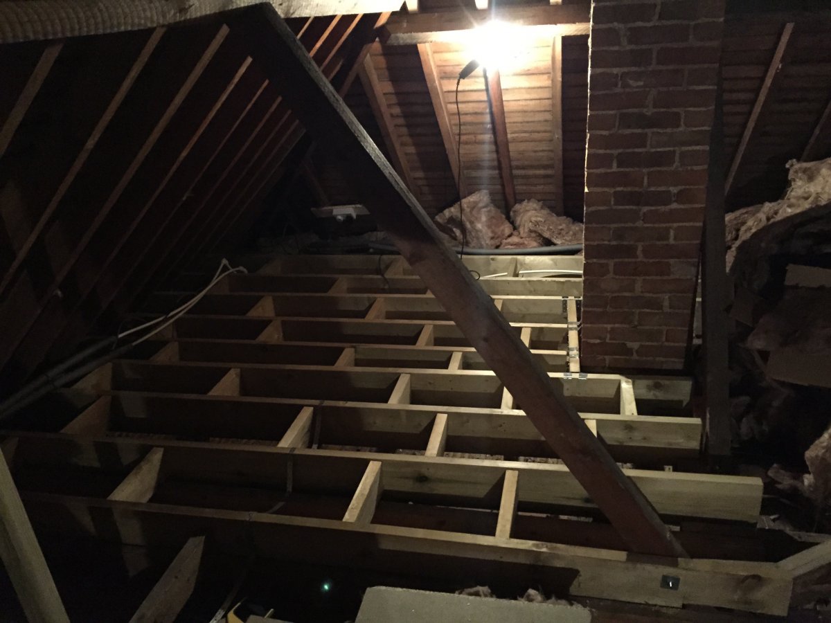

Got a few more joists in over the past few days. Cut the first couple of sections from the ceiling binder too and strapped the ceiling joists to the new floor joists roughly in line with where the binder was - all good so far!
The angle drill is AMAZING!! Don't know how I've lived without one before.

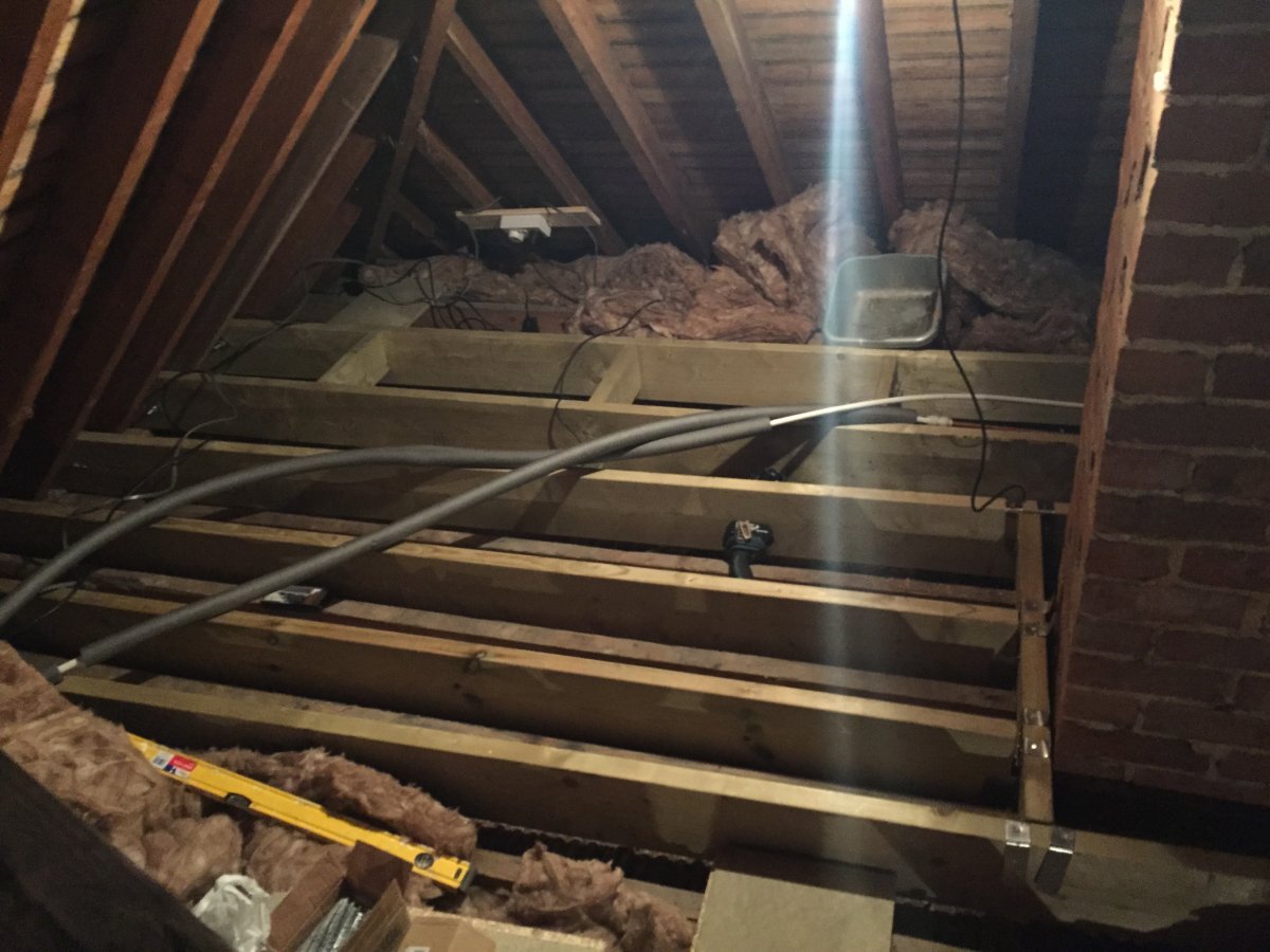

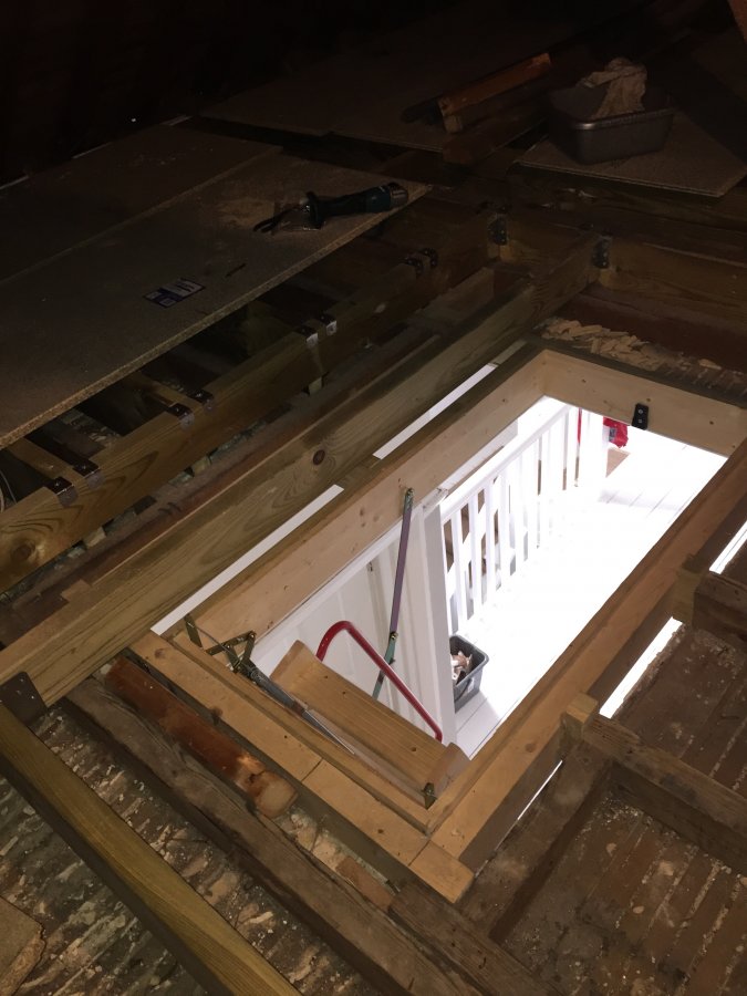

Update time...
The floor joists on the right hand side (looking at plan) are all in :) Still have a few noggins to add but that's about it. I moved the loft hatch a little to make accessing the bathroom below easier when the ladder is down as it seemed a logical time to do it also. The strapping is in place to replace the ceiling binder and all seems OK so far. I've also re-run the pipes in the first few pics through the joists. I was going to be lazy and run them on top of the floor deep in the eaves but they'll only annoy me when I'm trying to use that area for storage.
Need to move everything around now and start on the other side. In theory it'll be easier going over there as I don't have so many obstacles and only the main chimney to trim around but we shall see.
Pics attached.

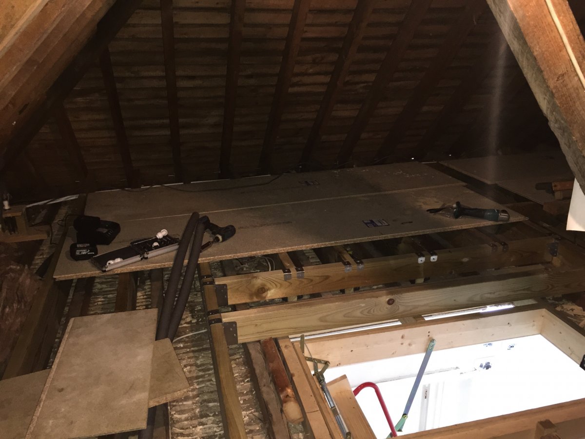

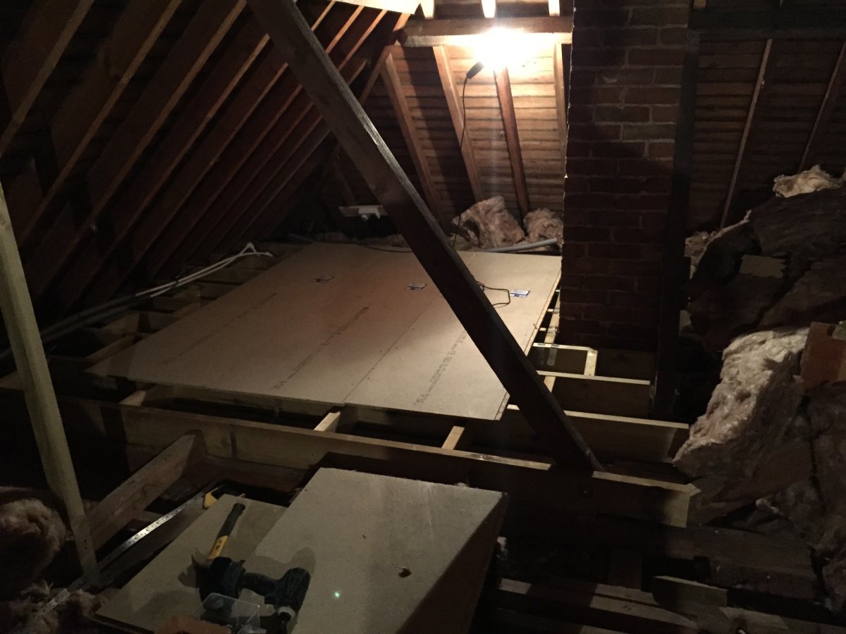

Update time!
- All new floor joists are in place
- 2/3 of the floor itself is in (2400x600 sheets are a pain but worth it!)
- Started adding the battens to the inside of roof rafters to take the new insulation
- Started on the stud work to show where the walls around the perimeter will go and hung the first ceiling joist to get an idea of final height
Next
- Velux fitting if it ever stops raining for long enough
- Finish floor
- Finish stud work
- Fit insulation in rafters (80mm kingspan leaving 50mm gap then membrane then 25mm gap then plasterboard for finished surface, no plasterboard inside eaves storage. I know this isn't enough for regs but then this isn't a regs build and if down the line I want to go there I can add celotex backed plasterboard
- First fix plumbing (2 rads) / electrics / LAN etc..
Feels like I'm over the hump, maybe not :)
