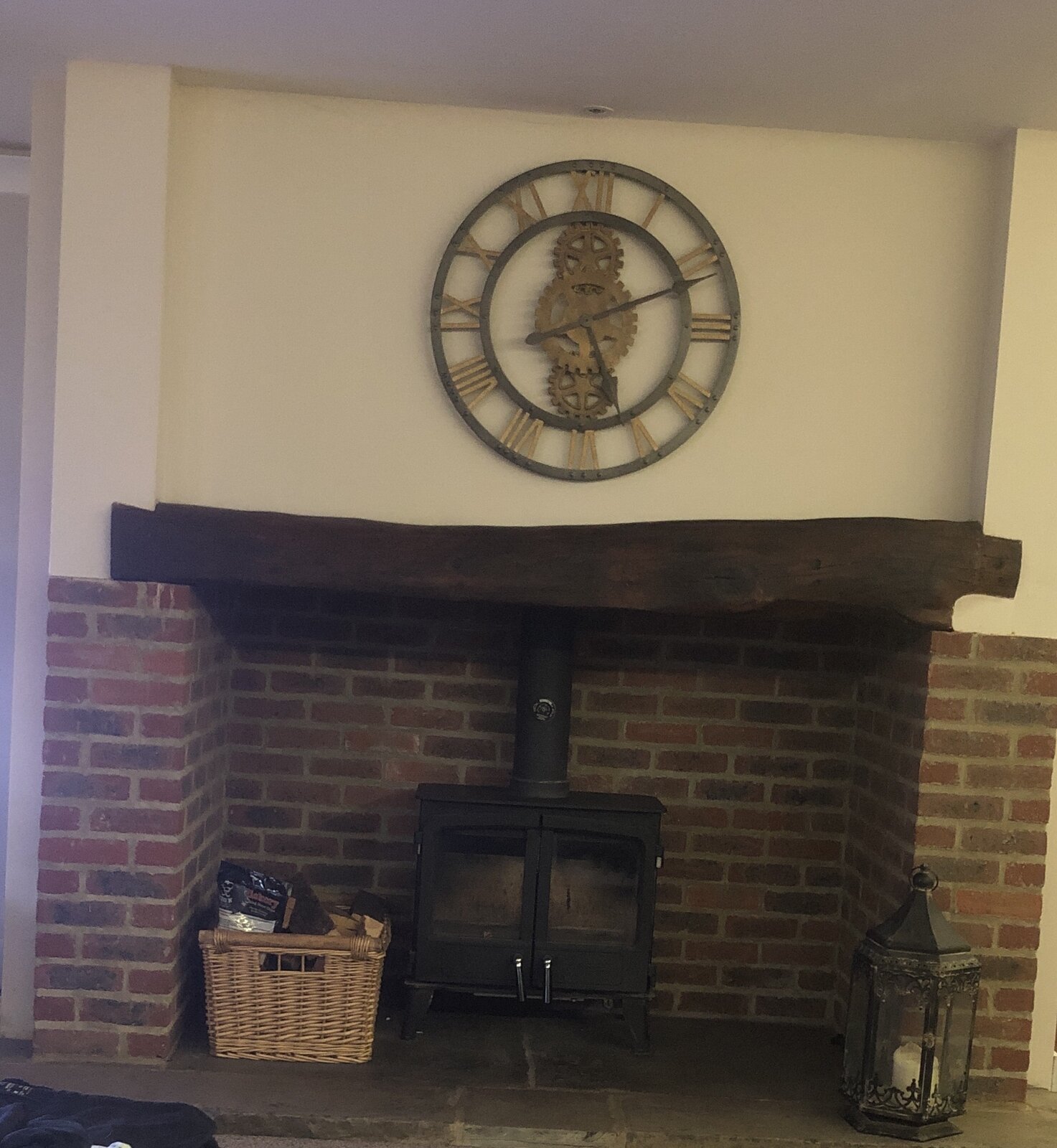

Sorry, just re-read your original & subsequent posts and I am now under the impression you are going to build a brick or block chimney breast, 3+ meter high, in which you will insert the log burner on top of an existing floor of T & G boards or chipboard. If that is the case then I agree with the first guy that you need a cast concrete base underneath it.
There’s nothing there currently and we’re building a tall chimney breast to house it.
Built a faux fireplace at my previous home, fire board above brickwork and then plastered.Used yorkstone for hearth.

If you are building a proper fireplace then yes, you will need the right foundation under it
We may need to reconsider the construction to lighten the load a bit but either way it’s going to be a lot of weight in one area so it needs some decent support. Thanks.
