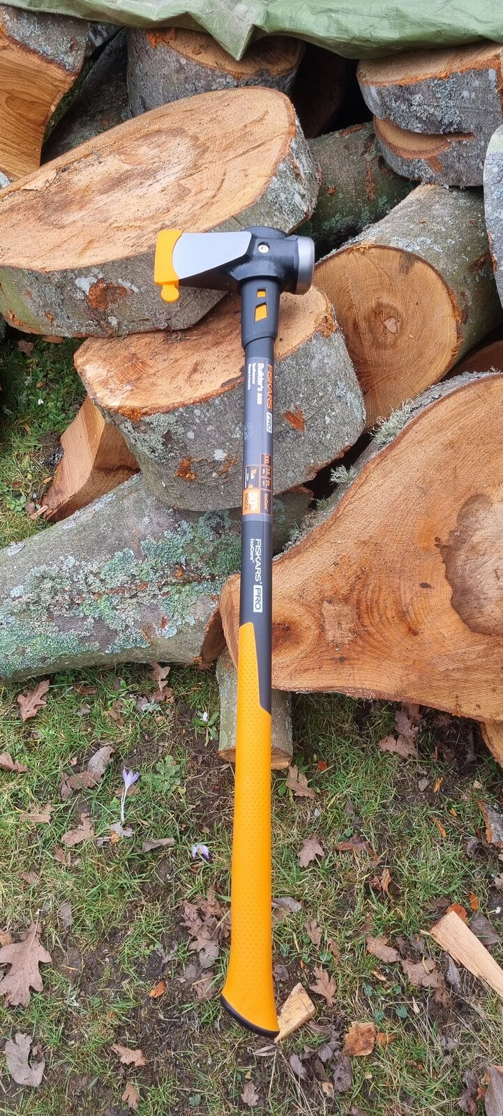

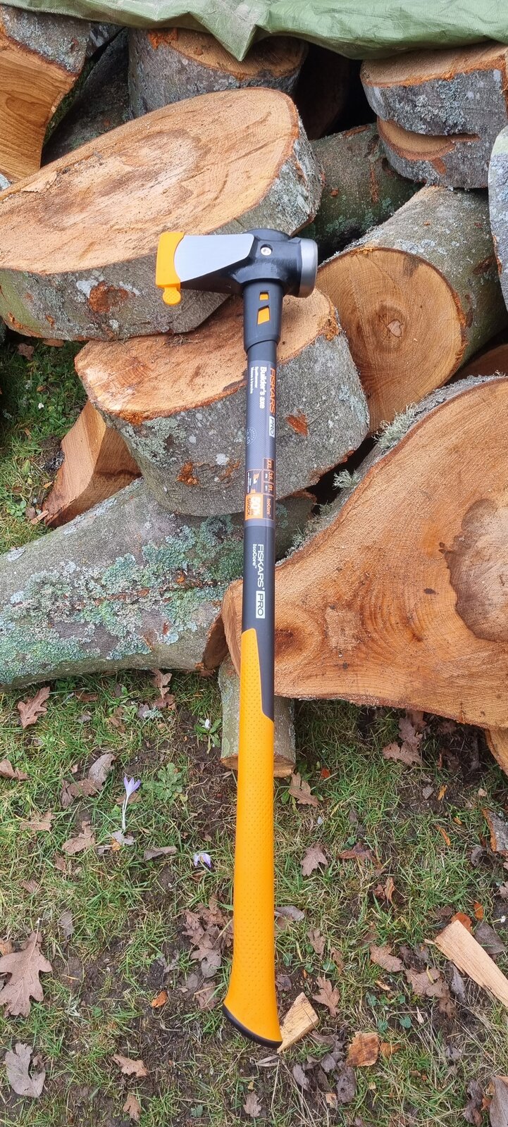

Ok im so excited my Fiskars Logging Maul is arriving today. Will share some pics when it arrives and my thoughts on how it compares to my oldish Maul which ive gone through two of them now, both times the fibre shaft splintered near the head. Ok maybe my aim has been a bit crap as times but still, they should last years. I have a feeling this one will. Well it better be because it cost over £100 with Pnp..
Ok it arrived. Wow blows the **** out of my previous Maul. Slightly heavier but effortless drive through some heavy stuff, and more importantly way less shock through the shaft when chopping. May cost 3 times more but this feels like a Rolls Royce in comparison.
