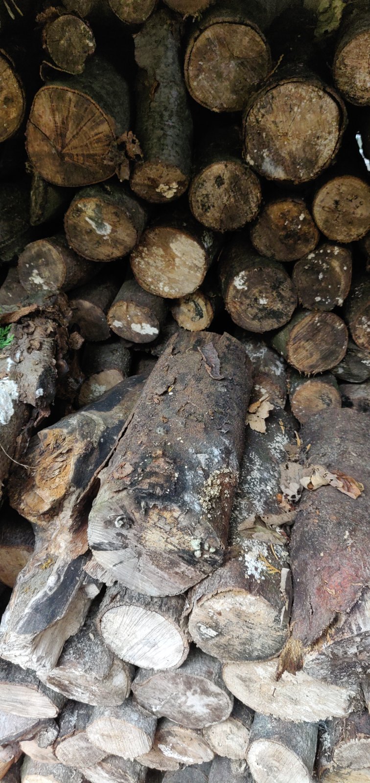

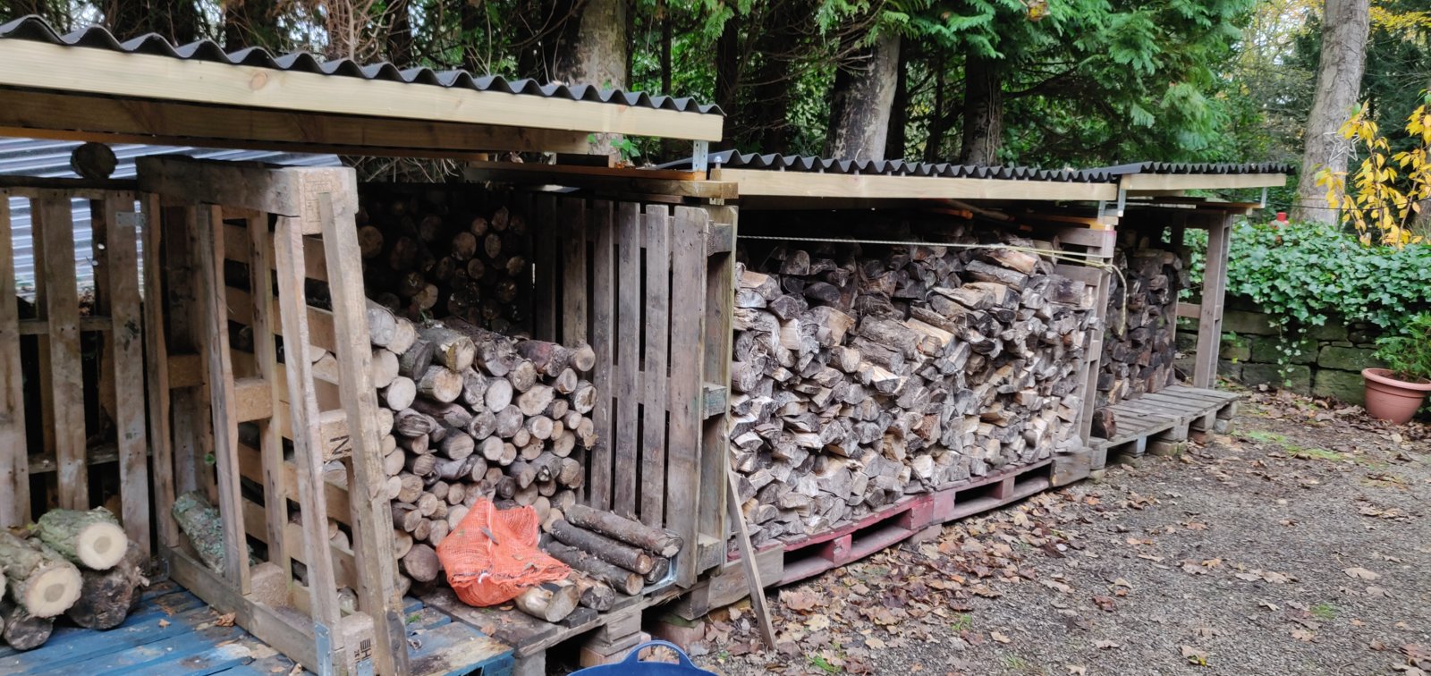

Logs in log store have mould
20% moisture is allegedly the optimum.
The optimum is zero - any water in the logs will use up energy to boil off in your burner/fire, but sub 20% is ok.
I'm wondering which way the open side of the log store faces, relative to your prevailing wind? If it's southwest you're likely to be getting rain blown in - I'd be tempted to extend the overhang.
The logs will dry better if split when you get them - water doesn't move easily through bark (varies between species)

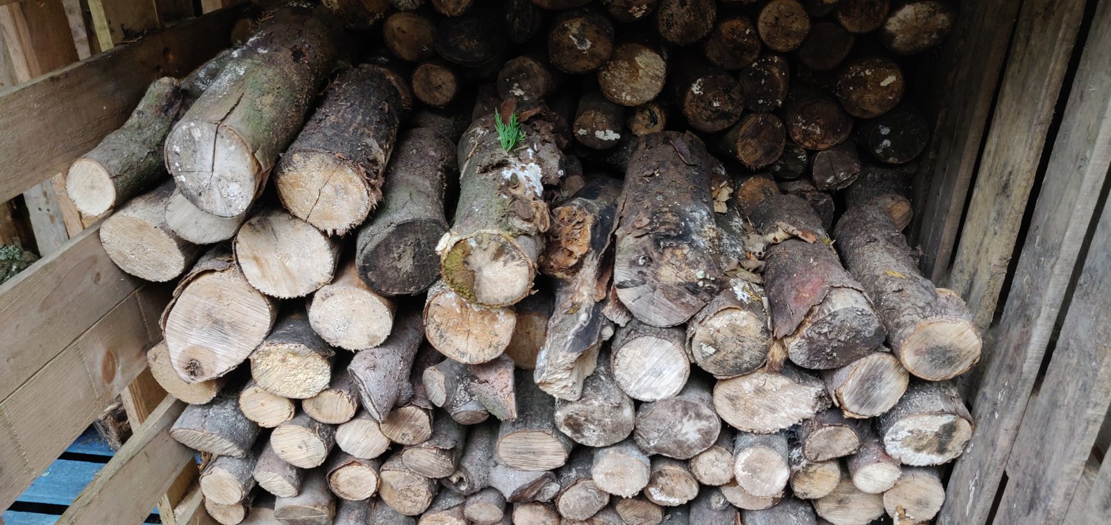

Is that a green leylandii stalk in the third picture?
It's probably worth splitting a few, to check the moisture level in the middle of the logs. I'm not sure I'd expect unsplit hardwood logs to season properly in one summer.
I'm also wondering whether, if these are the logs you had lying around getting mouldy last winter, they're more likely to get mouldy again more easily.

So here are photos progressively zooming in. It's the round logs I'm having issues with, next to the orange bag, the others seem ok.
They look great until you get up close.
View attachment 174697 View attachment 174698 View attachment 174699
Your wood looks like Beech or Sycamore but would bet on it being the latter. They are both highly susceptible to going mouldy very quickly in all but ideal conditions with Sycamore getting covered in green or soot like deposits.
