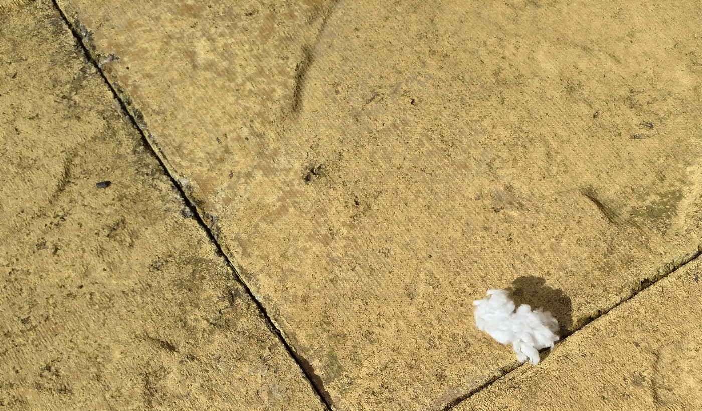

Ok, this morning the bird is trashing something else.
It looks like polystyrene balls but made of paper?
1. What is this material and what is it used for?
2. What damage is being caused by it being removed?
3. Will it need replacing / repairing?
I am still waiting for the missing bricks issue to be fixed. The developers sent the original builder around to look at it. He confirmed that the carpenter removed the bricks to install the roof work but did not replace the bricks. Said he would contact when ready to do the job but I have not heard anything since.
Could the large gap cause tile chattering to be worse than normal? The winds last night made it sound like a domino run going on up there.
Yes the gap could allow the wind to cause tile uplift through the exposed soffit.

Absolute w4nk finish. Only quick fix way is to bang a 9mm flat board against that wall and up to the soffit or the birds are gonna have a field day in there.
This has now been resolved. The soffits were removed, insulation refitted, new bricks installed (taking notches out of bricks where it would have infringed wood) and new soffits installed.
As for building control the council want nothing to do with this. They state they are not part of this development, and that NHBC would have signed it off so I needed to contact them. I asked the council if they think they have any responsibilty to ensure houses are built correctly but then I got no further reply.
