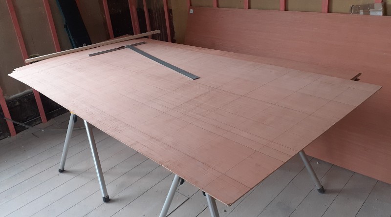

If you really need a longer square get yourself a dryliner's T-square. These are metric graduated only (because plasterboard comes in metric sizes) but are 1200mm (nearly 4ft) long to the tip. I often find mine (Marshalltown) to be handy for setting out sheet materials, but super accurate it isn't (although why would it be? A few millimetres gap in a joint will just disappear when the plasterboard is scrimmed and skimmed or taped and jointed). So OK for doing floor overboarding, etc
Just to clarify, here is a ppicture of the 1200mm dryliner's T square being used to mark out an 8 x 4ft (2440 x 1220mm) sheet of 6mm plywood being used for floor over cladding. Big enough and accurate enough for the task
Against a combi square these are huge, but the accuracy is really only moderate
