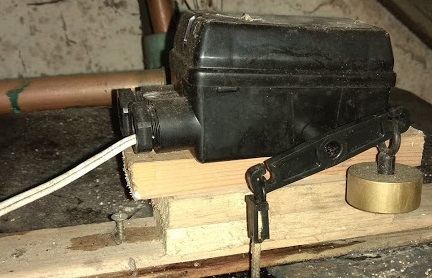

I would like to replace the relay which triggers a water pump, with a relay which times out after, say, 10 minutes. And if it times out, it stays locked out until reset.
Needs to be 230v AC on both sides of the relay.
If it doesn't time out, the next time it's triggered it should come on normally.
I've spoken to everyone from RS to Farnell, and they have everything but. I even found a specialist called Quasar who were very helpful, but again, had everything but, although these came close... https://quasarelectronics.co.uk/Category/kits-modules-multi-mode-delay-timers
I've got about 10cm by 12cm space to replace the relay currently inside the box.
Some pics here: https://photos.app.goo.gl/18RiWUcP5Hz9dCo29
Yes, I know I could probably roll my own with an Arduino, but if it all went wrong, not sure what the insurance would say!

It looks like this switch responds to a low float by turning the pump ON ( are there two cables or two single wires coming from that switch
and this switch responds to normal high water level by turning the pump OFF
The red mark highlights debris in the hinge of the switch which may have prevented the float rising far enough to operate the switch. There is a magnet in the float which operates the switch when float and body are in line. It is not a good idea to use this type of switch with the float below the body and water lifting the float up to the body.. They are more reliable when the water lifts the float away from the body.
Or the black box may contain two switches , low level START and high level STOP.
The answer to using a timer to limit pump run time could be complicated if in normal use the flow from the tank is greater than the rate the pump can supply and flow from the tank runs for longer than the pump's allowed run time.
Can the pump be allowed run into a closed pipe ? If it can then fitting a standard ball cock to the tank would be a way to prevent the tank over filling if the pump control system fails

Exactly - it's a Stuart Float Switch - in fact, it's so old, it was actually made in England (how about that!).
Found the manual - it can switch 3 amps inductive load, so I wonder why a relay was added?
Easier and cheaper to replace a relay. Switch operates only the relay coil hence minimum contact wear in the switches so very long life time.
