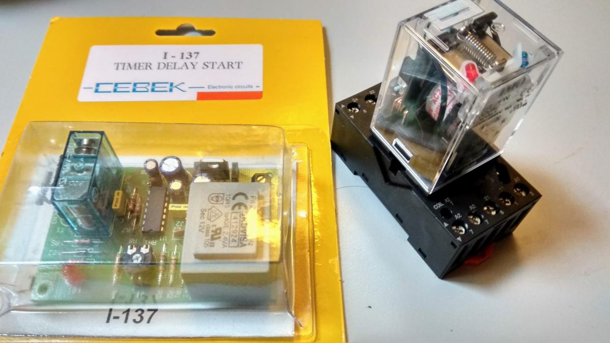

Well, in the end after a lot of thinking, I came up with this lot:
Total is £34 inc VAT and postage. I already have a box to house it in.
Timer switches ON after 10 mins, triggering latching relay to BREAK the circuit.
The problems is resolves are:
Someone leaving tap on
Float switch failing
Outside well running dry
Pipe burst and leaking
For £34 I think this is reasonable. I just need to build it now - #weekendproject
Will post end result!
