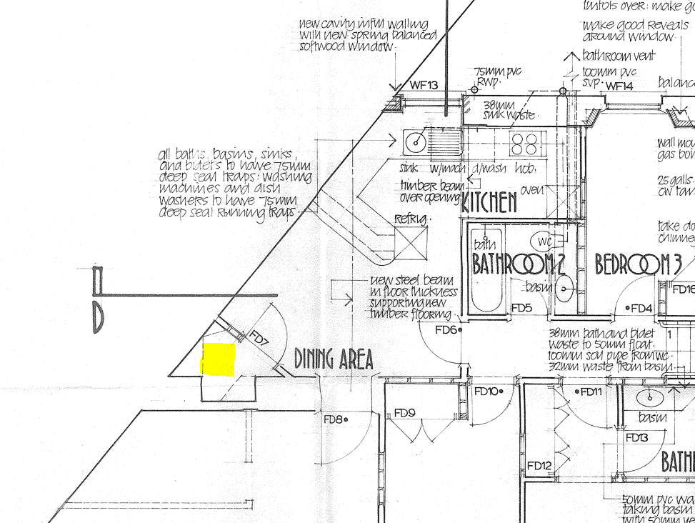

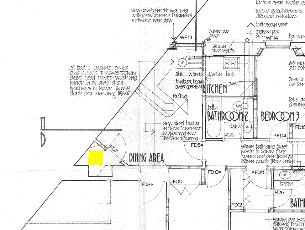

Here is where the boiler is in my flat.

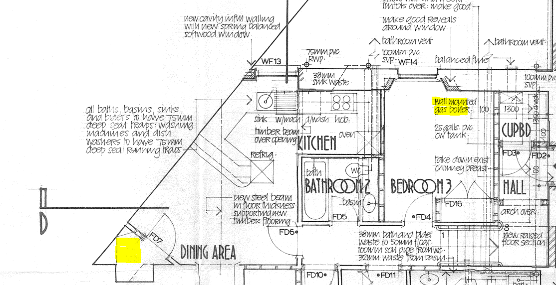

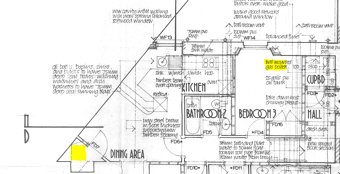

EDIT: Just noticed on the plans, they actually have the boiler located where my water storage tank is! But the boiler is definitely in that bottom left corner (as is the boiler in the flat above me and the flat above that.
The plans identify the boiler as a wall mounted gas boiler with a external, through the wall flue.
those drawings say you have a wall mounted balanced flue boiler, you dont you have a floor mounted conventional flue boiler
Yes, you're right - the plans arent accurate in that respect. I guess that was their original intent, and for whatever reason changed their minds.
That would be a more sensible place to have the boiler and all the water hookups will be there at the moment if the hot water cylinder is there. Even then, space dependent, there could be a system boiler and the cylinder could be retained. Hard to be specific not being there of course. Only thing it may need is the gas run.
