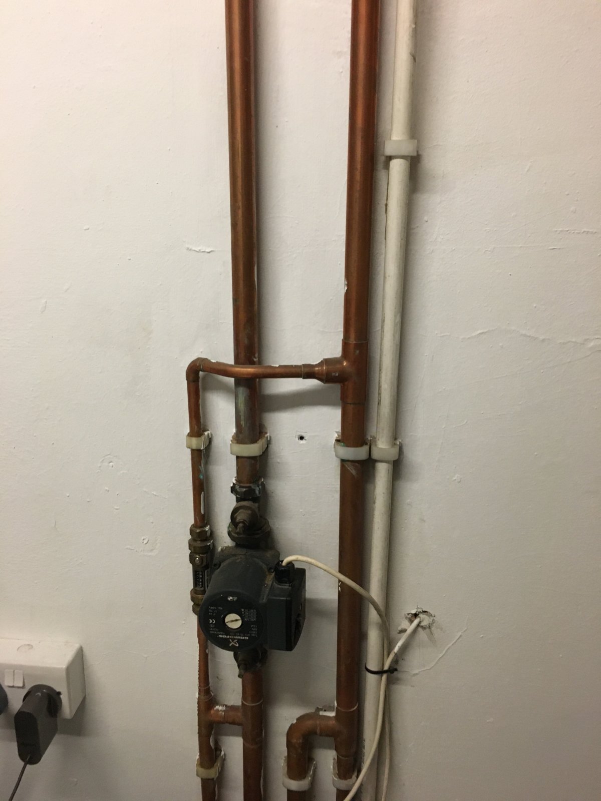

It looks like there's a lockshield valve for the cylinder return next to the Honeywell wiring centre.
Take the red handle from the illegal gate valve fitted above the boiler and see how many turns the lockshield is open...there's a faint chance it's insufficiently open of partially blocked.
I can't see a boiler pic :unsure: I guess the system is fully pumped, having been converted ( by the size of F/R pipes)

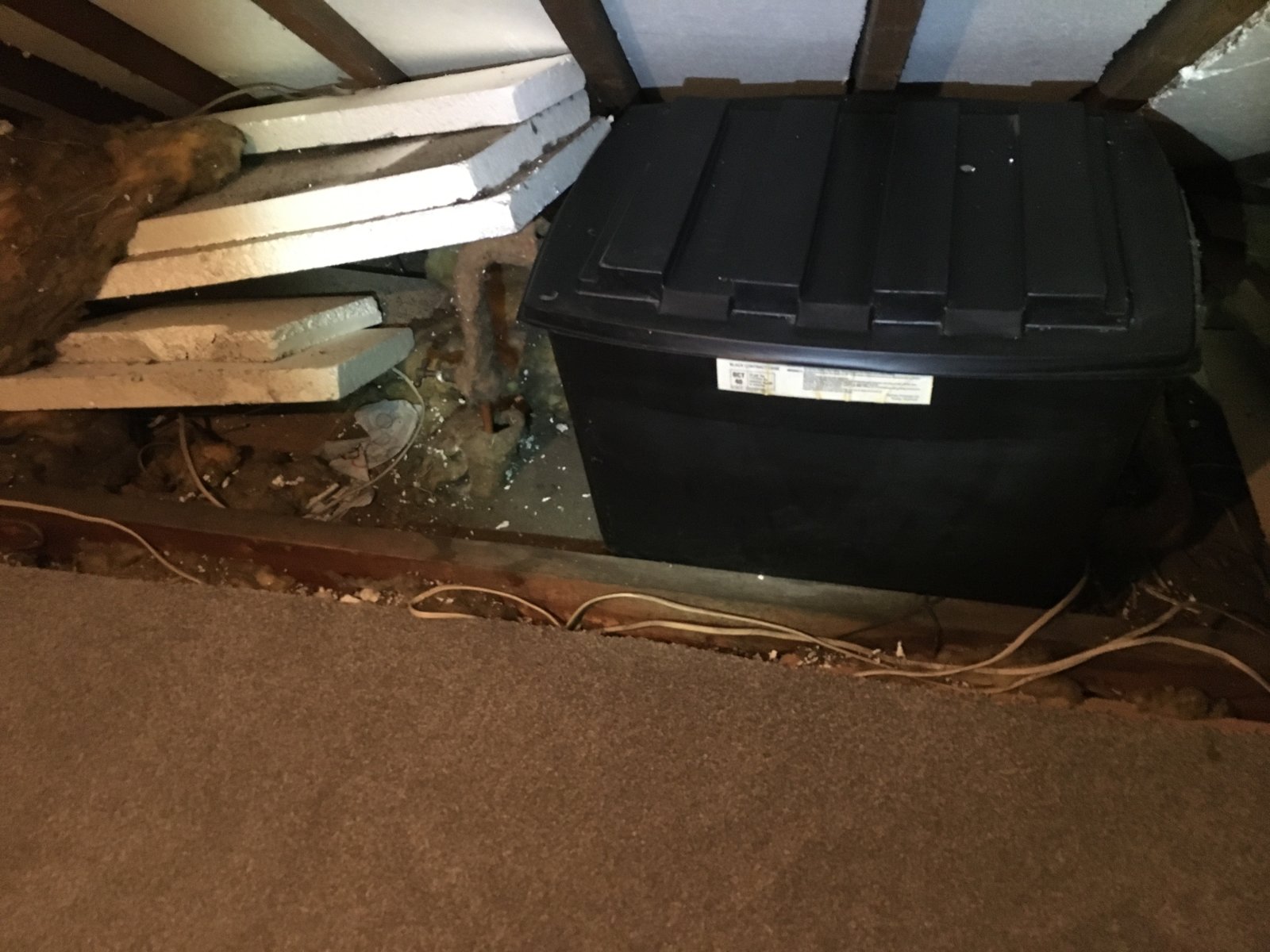

I also have 2 cold storage tanks in loft which is odd? I recently purchased the house so don’t know the plumbing setup one cold storage tank is on the loft floor the black one and supply’s the upstairs bathroom taps bath and sink and the one which is high up on the platform supply’s the hot water cylinder and downstairs hit water taps and boiler I think is that normal? Thanks
The small cistern on the left is the old feed and expansion cistern for the previous boiler that operated as an open vented system.
The new Vaillant operates as a sealed system hence the red expansion vessel/gauge/safety valve.
The white cistern on the RHS looks to be in operation feeding the cylinder below (and maybe the cold taps). The overflow pipe (aka warning pipe) in case of float valve failure dips into the old F & E cistern (a common bodge).
The F & E cistern is now not plumbed in meaning if the float valve fails you will have a potential flood. You can see the original overflow was plumbed to the outside (top left on small white cistern) before being cut off for scrap.
Diy/builder/bodge plumber work at its finest.

Otherwise that cold cistern looks undersized (normally a 50 gal capacityfor a typical home) and replacement should be considered to bring it up to regs. (lid, insulation, flyscreens etc).
The support structure looks iffy...the lack of triangulation, it's made from scrap wood, a poor base for the cistern etc. what's it sitting on ceiling joistwise?

First thing I'd do is check the Motorised valve for the Hot Water circuit is opening as it should, that may be your issue, rather than a problem with the cylinder and/or a blockage.
Secondly, sort those cisterns out if you're keeping it open vented. Needs a proper base/platform, remove that dead leg of the old feed to the F&E cistern, (the small cistern could be removed altogether now, its not serving any purpose), and reconnect the overflow from the Cold Storage cistern, so it wont leak water everywhere if a problem arises.
If you're going along the Unvented route, the lot will be redundant, if you're keeping the current open vented setup, then I'd replace the cistern with a modern version with sealed lid etc.

Any new boiler will have to be fitted on a clean system anyway, and it could well be crud in the system that's causing a lot of your current problems. If you are out of your depth, get a Pro in to have a look, a good service and system flush may well sort out your boiler and cylinder issues. Have you looked at the motorised valve on the HW side and checked its operating?
A good start ! the valve can be locked open by sliding the lever and catching it behind the notch in the metal case
