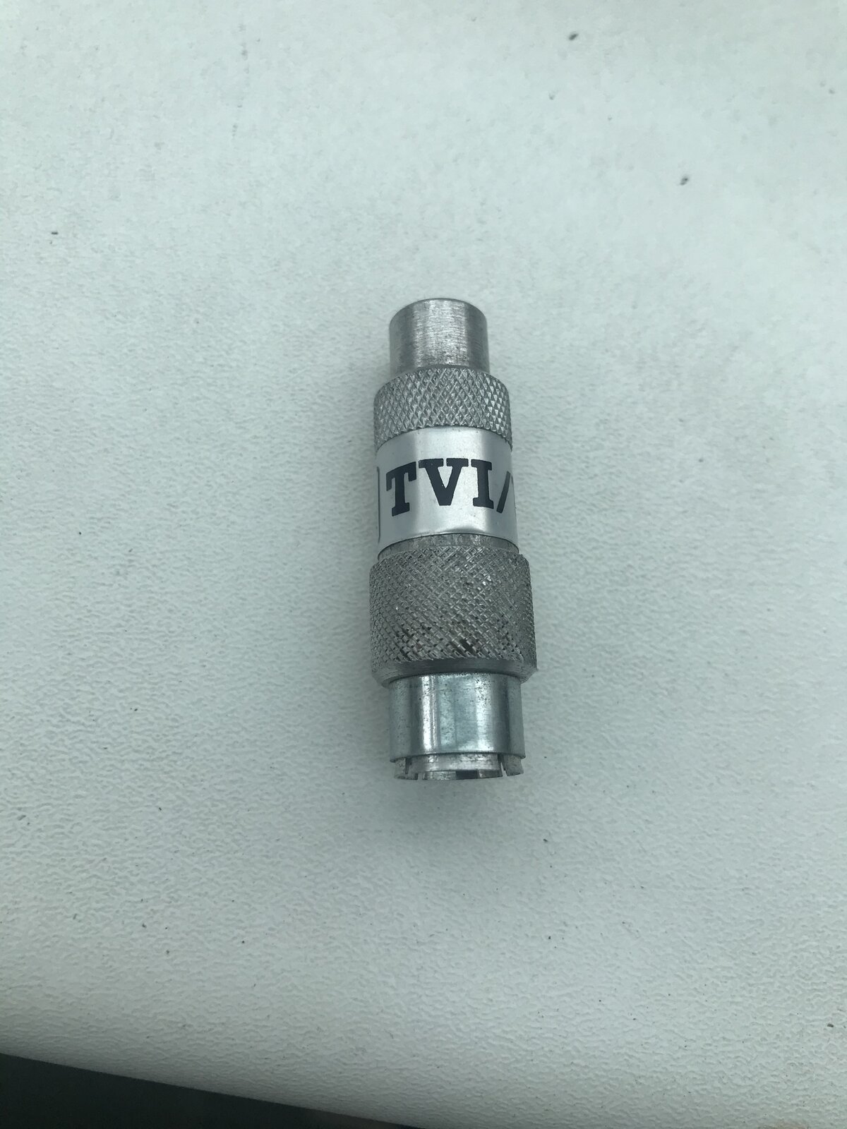

C46FB817-6ECB-4DCE-9AE6-CE2412631377.jpeg C46FB817-6ECB-4DCE-9AE6-CE2412631377.jpeg Thanks. I’ll try and move tv to another position, although the current position in the conservatory is clearly “too good” for the Panasonic. Yes, I did speak to guy. (Guy who did original job) This is where “snippets” of info can be a good thing. Ie- risk of being challenged about what/why he said x or y, struggling to recall technical detail etc.
Gist is, he said too much signal in his experience was an issue where 70db or more. (In our case his meter was showing 50-pretty good in view of loft splitter and long cable run) He advised me to try another filter before the attenuator. (Photos attached) This seemed to work for a few days, but issue reappeared yesterday.

This is what I mean by snippets of information. At the beginning of the thread you said your signal strength and quality is very strong. Now it turns out you're running at 50dB or thereabouts, which is a decent signal, but it's not "very strong". This isn't the sort of signal level that oversaturates TV tuners, particularly not ones from a decent brand such as Panasonic.

50 dB as a signal level doesn't tell me much about what's going on with your signal other than what's happening with one of the muxes. Is 50dB the signal from one of the strongest muxes or the weakest? We don't know, and I'm guessing you don't know either because you didn't know to ask. The fact that the PVR is working fine would suggest that the aerial is at least reasonable match to the local transmitter otherwise you'd have problems with that too.
The point here is that 50dB isn't going to oversaturate a tuner, so your original comment about the signal being very strong was a bit of a red herring. That's always one of the pitfalls of trying to diagnose remotely; we have to deal with an OPs impression of what's going on, and that might not accurately reflect the reality.
The bottom line here is that your don't need to reduce the signal level for the TV. It's only going to make things worse, not better. You've eoither got a problem in the signal chain from the PVR to the TV ( and that includes the possibility of a broken RF input on the TV ), or the tuner in the TV is failing. I have to be honest and say I haven't yet encountered a failed tuner unless something catastrophic has happened such as a lightning strike. That doesn't mean to say it will never occur, but it's incredibly rare in my experience.
I would start by taking the TV to another aerial point in the house, one that isn't connected to this new aerial, and one that you know works fine with another TV. Whilst you're about it, check there's still a centre pin in the TV RF input. If the TV works fine in the new location then you know the issue is something in the conservatory. Where the TV still struggles in the new location then it has to be something in the TV itself. I take it you've checked the tuning?
