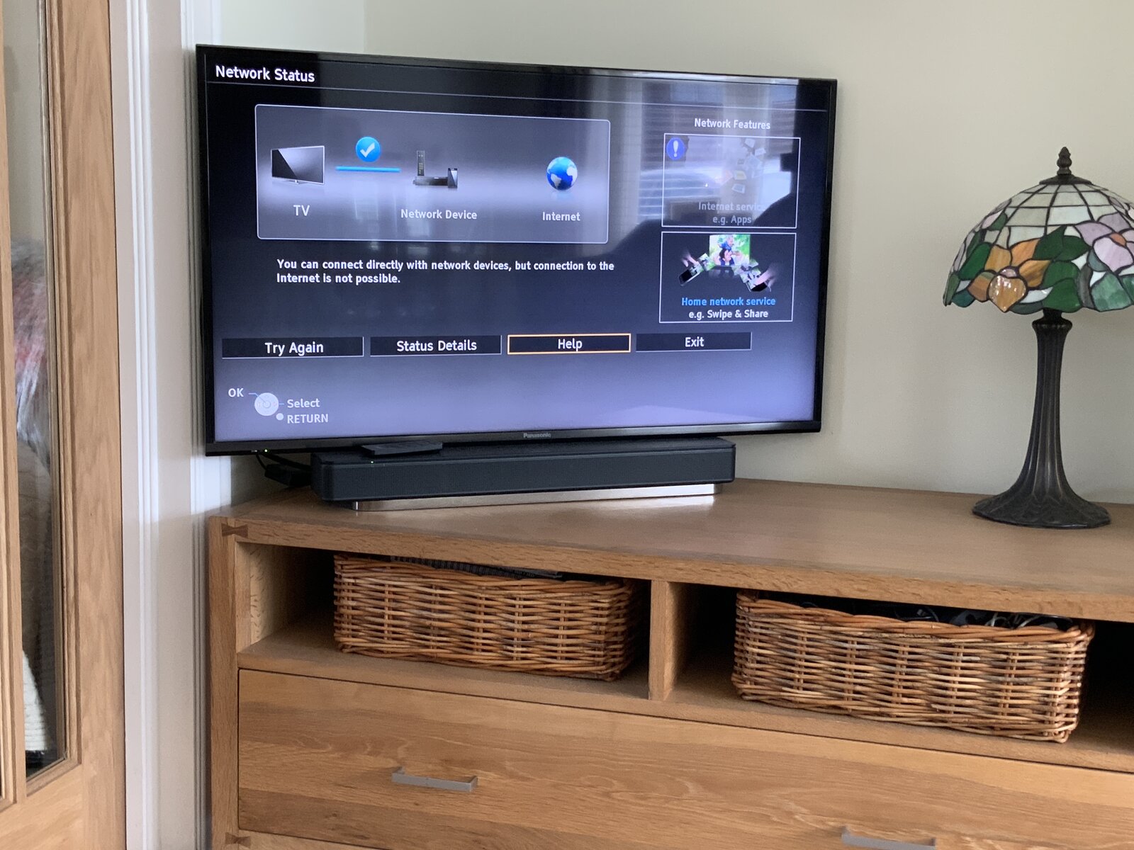

As above, I have a Panasonic TV, probably about 8/10 years old. Unable to get Netflix, iPlayer, Freeview play etc. Not too much of a problem as other than Freeview play, we can watch everything on else on our firestick. Cannot get any network connection using both the Wifi and the wired connections. Normally have it on ethernet connection. Tried swapping the cables over to the firestick but no difference and firestick works fine with the ethernet cable previously connected to TV so that rules out ethernet problem. Tried resetting everything but still nothing. Could it be one common component inside the TV?
What is shown under status details? Does it have an IP address and the correct gateway / DNS IP's?

Take a pic of whatever is in "status details". It seems to be connected OK to your home network but not the internet for some reason...

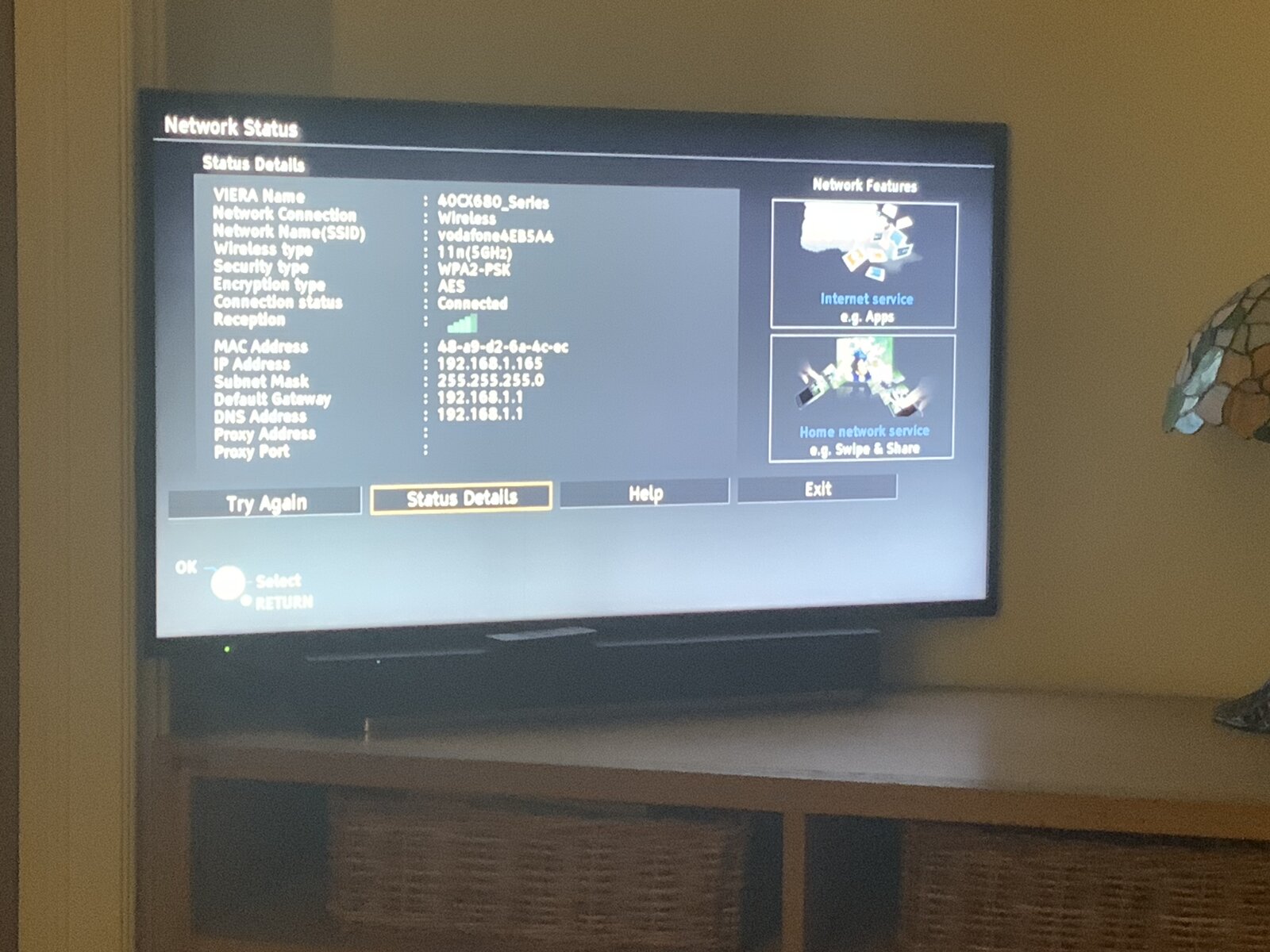

Well you are right about me not being too tech savvy but I know for sure that nobody has fiddled with anything. Anyway, not being able to sleep, at 4.00 am I've had another fiddle and it's now sorted - on Wifi at least!

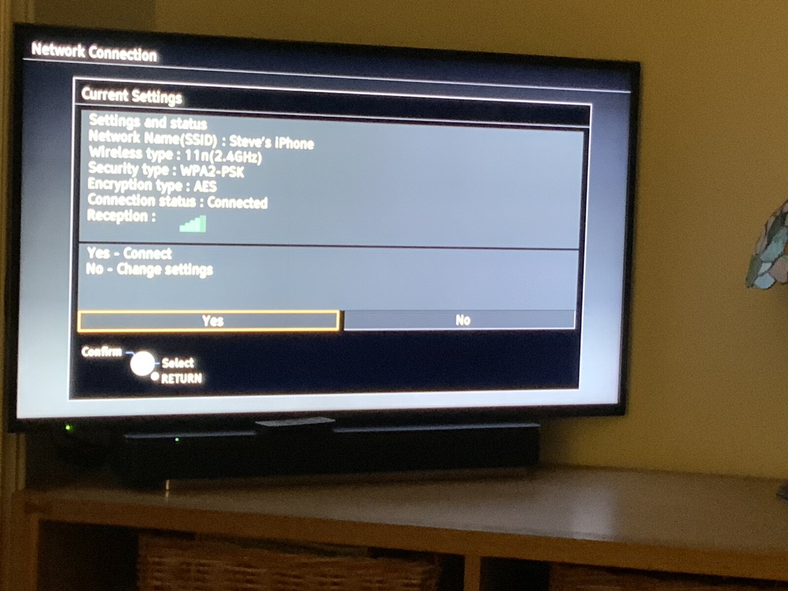

I have two ethernet sockets by the tv - one for the tv, the other for my firestick. Swapping them made no difference - firestick still worked but the tv still didn't - so I think that ruled out connections etc. I definitely couldn't connect to Wifi despite resetting router and re-entering Wifi settings. To rule out the router I tried connecting to my iPhone Wifi hotspot....and it worked! I then tried again to connect to the router Wifi....and that worked! Tried the ethernet connection again and still no joy so I'm back on the Wifi connection and I'll leave it at that. Thanks for everyone's help.

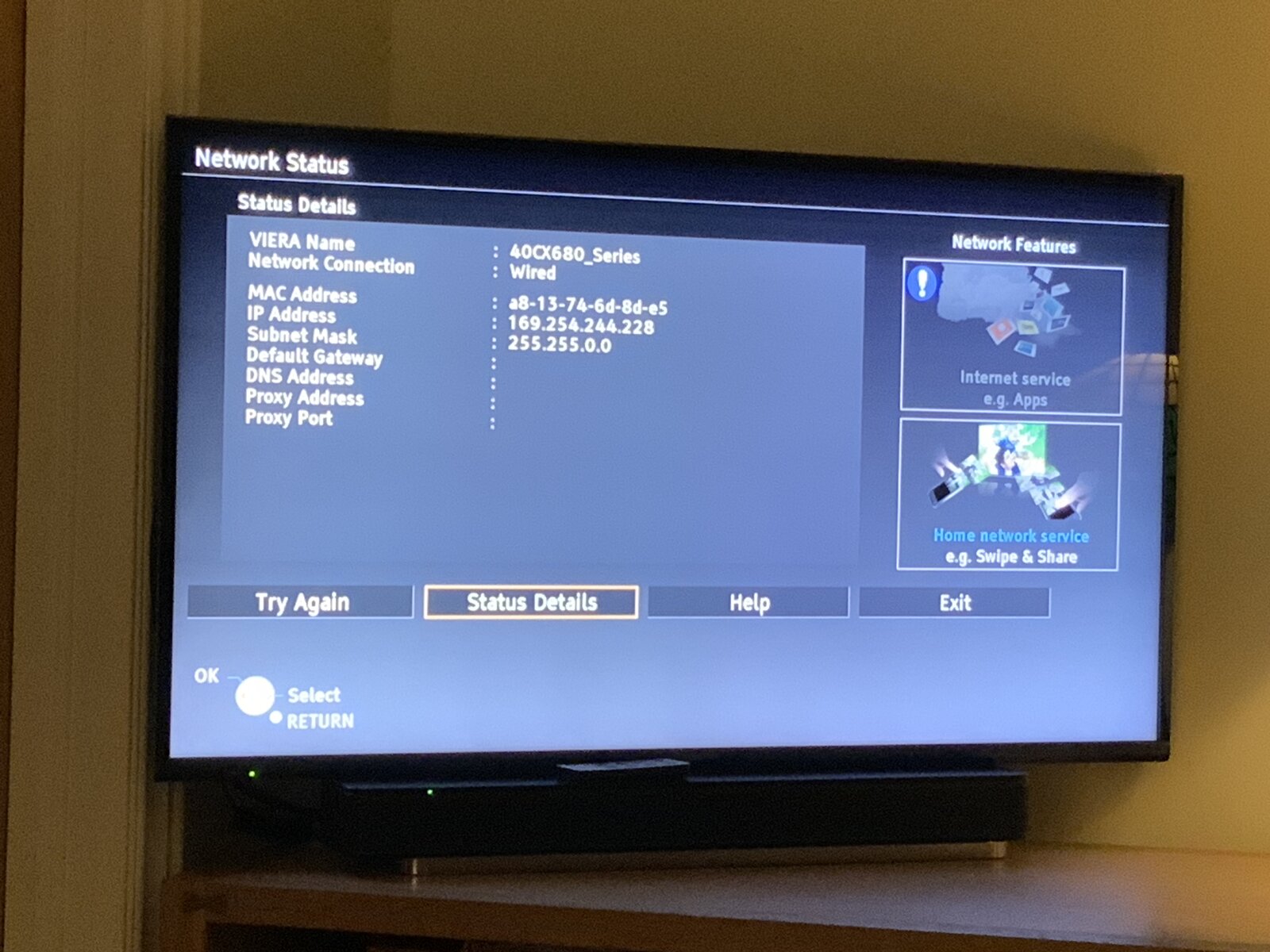

For some reason on the wired connection its not getting the info it needs from the DHCP server (your router). It doesnt have the correct IP or any gateway settings. Bit odd. Did you try and reboot the router?

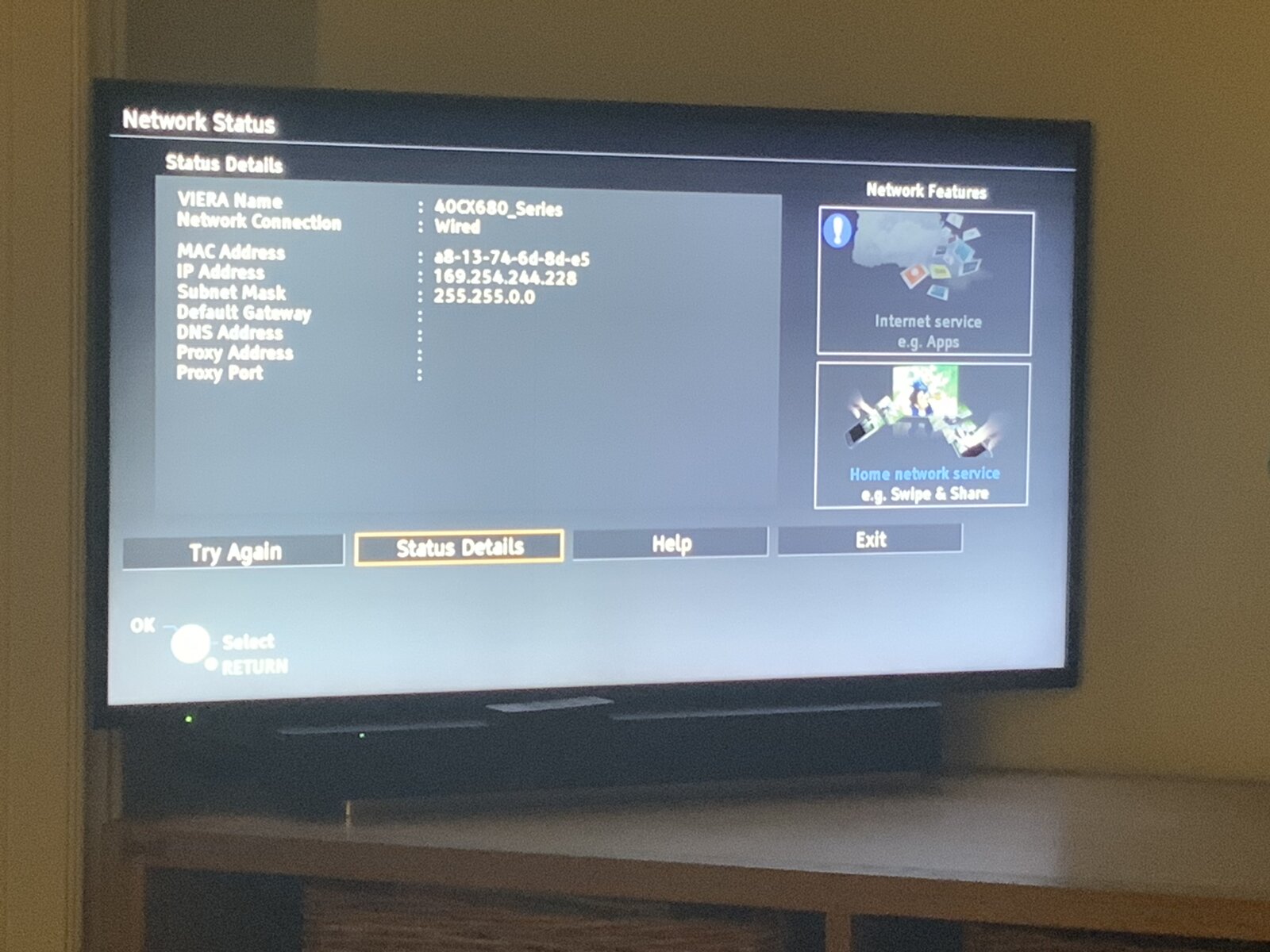

That’s a strange address on the wired connection …..169.254.244.228
Yet the WiFi looks correct at 192.168.1.165……a common router address
As soon as I see an IP address beginning with 169.xxx.xxx.xxx I am fairly confident that the router is not "playing ball".
When you had the ethernet connection (in the first image) your router either refused to give the telly an IP address, or the TV didn't ask for one.
When face with such scenarios, I set up a static address in the router.
Not wanting to bore you... (but)...when a device talks to a router, it asks for an "address". The router, ordinarily, assigns an address on a lease basis, often 3 days.
I normally recommend telling the router that you want a lease free (ie. static/ non changing) IP address for printers and TVs.
If you want to go down that path, we can help you.
IP addresses starting 169 are the defaults on client machines relying on DHCP when a DHCP server cannot be found on the network. (DHCP is Dynamic Host Control Protocol and is what allows client devices to connect to a "server" which gives them all access to (say) the internet. In the main, home routers will assign (give out) IP addresses in the range 192.168.1.x The router's address will normally be 192.168.1.1 or 192.168.1.254. There should be a facility on your TV to set a static IP address, but you will need to know your router's address as the "default gateway" and whether your router has a section of IP addresses reserved for manual allocation.
