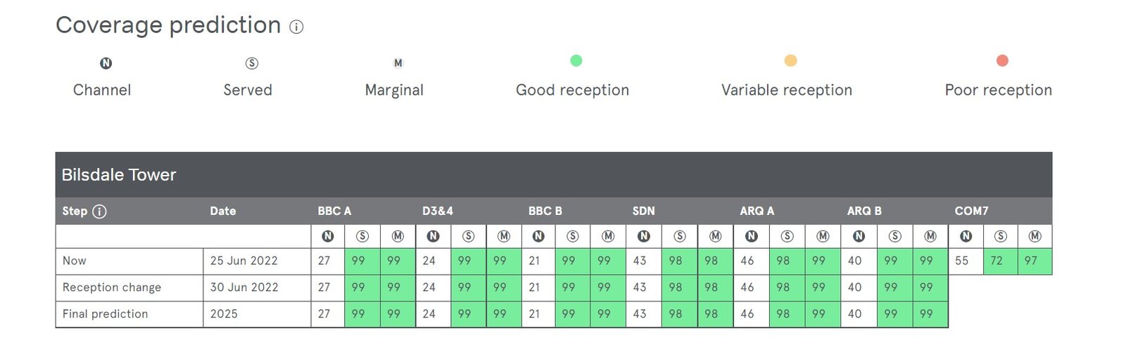

Thanks again for your reply. I checked out the transmitter using the link you provided and my postcode (TS5 6AX) and it gives the most likely transmitter as Bilsdale Tower. In the column "Reception Summary" it gives 2222, which means nothing to me. You were asking about my aerial so I've attached a photo of it here.

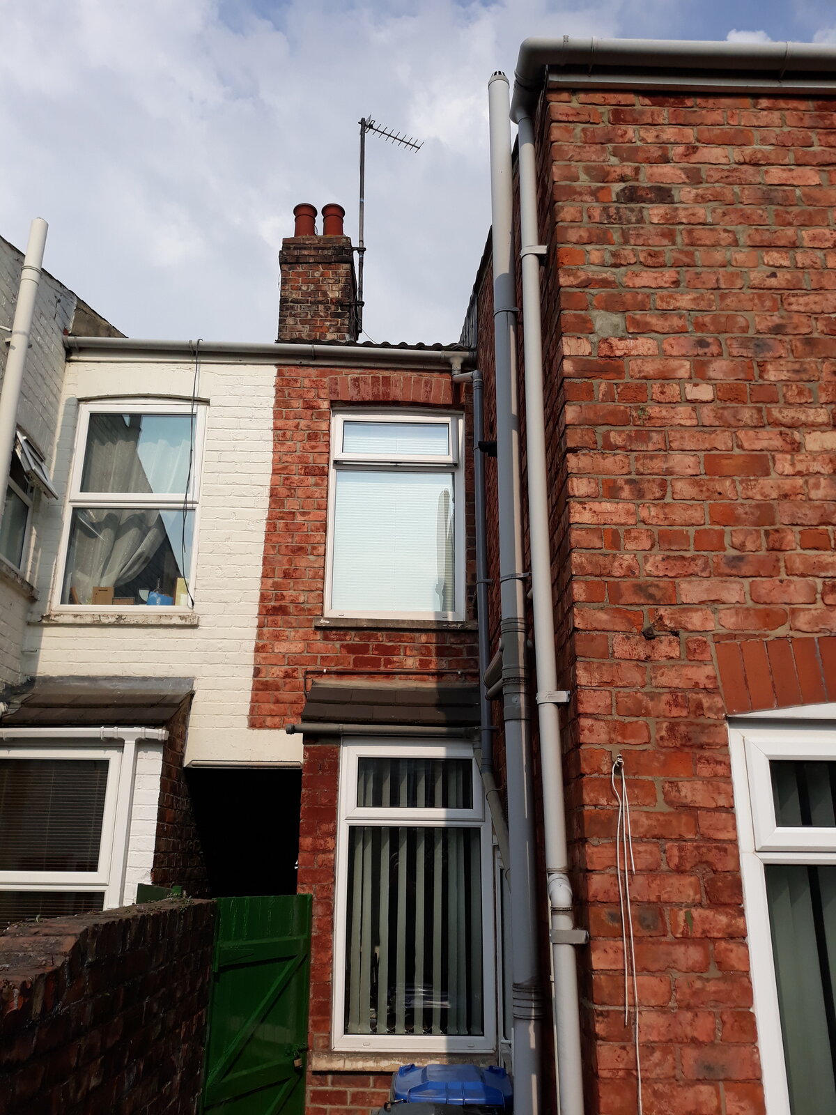

Thanks for the picture. That's really very useful.
I skipped the local transmitter summary list and went straight to the Bilsdale info a bit further down the page. This is the bit that's most useful to you:
From your point of view you're just interested in whether the boxes are green, amber or red. Yours are all green. This doesn't mean you'll get great reception regardless of the gear. If an aerial or the cabling is broken, unsuitable, incorrectly aligned or in some other way buggered up (that's a technical term ;)) then you can still end up with little or no signal. Similarly, if your aerial is pointing directly at a huge stand of trees or there's some other by physical obstacle such as a large building then that will affect reception too.
The prediction is saying "all things being well, the general signal strength in this area is good".
Looking at your aerial, I can tell it was aligned at some point in the past on to a main transmitter rather than a relay. This confirms that Bilsdale is your most likely transmitter rather than one of its relays. I can tell this because the little bars of the aerial are parallel to the ground. We call this horizontal alignment, and it's to match the horizontally polarised signal from a main* transmitter. Relays mostly use vertical polarisation.
Summary so far then: You're on a main transmitter and, local conditions not withstanding, you should get a fairly strong signal.
Looking at the aerial itself, I can tell you it's very likely that this is a low rent contract aerial. That would match with the bodge-it solution of drilling through a window frame to install an aerial cable. I suspect it's pre-digital era, so it's been up at least 25 years, maybe much longer. This reduces the chances that you'll have nice clean wire clamps inside the connection cover. Even if the cover is still in place, atmospheric moisture over a quarter century or more will have taken its toll.
Being a contract aerial means it wasn't top-quality high-performance deal. Quite the opposite in fact. These were built to the lowest price possible. Compared to an ordinary Yagi (a common type of aerial design), the contract aerial will have pulled in far less signal. That didn't matter so much in a strong signal area, but after 25+ years of outdoor exposure and digital TV's more fussy signal preferences then it may be a consideration.
The masting to the aerial looks really quite sturdy though. That means if you change the aerial then - if it is as good as it looks - then you're literally just swapping the aerial rather than the whole system. I would strongly recommend you change the aerial - either you or an installer. Pre-digital-era aerials weren't 75 Ohm and the cabling was only single shielded. You're going to have a fight on your hands to get the old cable off and fit new on to an aerial that's really quite poor. If you want to keep the costs down then fit a Log Periodic and some new coax. Hacksaw off the U-bolt from the old aerial rather than trying to shift the rusted nuts.
