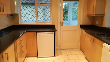

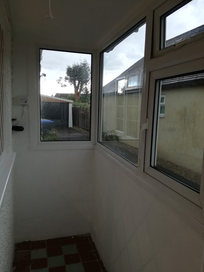

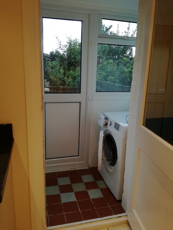

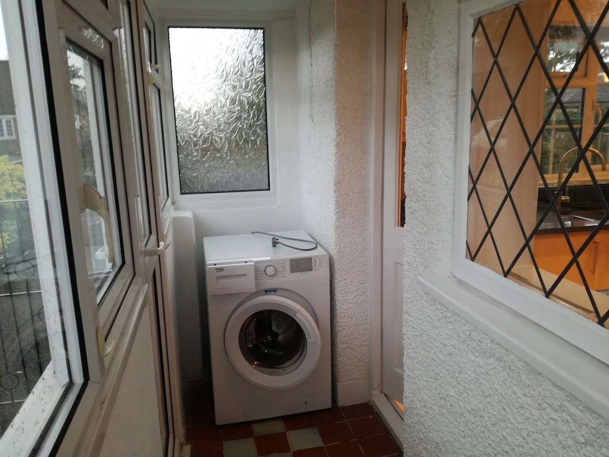

The washing machine and the dryer are in a small room, off the kitchen. This room has been added to the bungalow something like 20 years ago.
The walls are single-layer red brick and inside there's no insulation or plasterboard, the brickwork is just painted. There is a flat roof of felt.
Tenants usually have also a fridge in that room as there is only an under counter one in the kitchen.
This "utility" room is cold in winter and can be extremely damp. Recently it had gotten so mouldy that all the walls were practically black. This is just condensation as there is no problem when no dryer/washing machine are used (ie when the house is not occupied).
I cannot insulated from the inside because the room is long but only wide enough for the white goods to fit.
What could I do to solve the heavy condensation problem?
Would a fan be of any use?
I have a dehumidifier but it is a big box that take space, not sure if tenants will use it anyway.
Could I install a kind of permanent dehumidifier on the wall, does it exist?
Should I install a small radiator in there?
My other idea would be to buy and install a vented dryer instead of letting a tenant installing a condensing one, would it make a difference?

Needs ventilation as does the kitchen and door kept closed or all the warm damp air from the kitchen condenses on the cold uninsulated room.

An extract fan with humidity switch will run based on the level of humidity in the room. Condensing driers do not produce much humidity, washing machine probably cause more. I am not aware of any cheap wall mount dehumidifiers, but could you fit one on a shelf or bracket? I have one which I mounted on a TV bracket, not a flat screen bracket, an old CRT TV bracket. This in our poorly insulated utility room keeps it dry, despite my installing several lines for clothes drying to avoid using the drier.
You would need to use a dehumidifier with an optional drain, rather than a water collection tank and pipe it away - no point relying on tenants to empty a tank. It would also need to have a humidity switch included.
