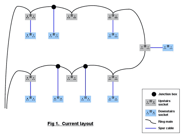

Fig 1 shows what I have now with 7 sockets on a ring, and 8 spurs, which is not OK? The exact details of which spurs are from sockets and which are from junction boxes are not accurate, but it's the type of setup I have.

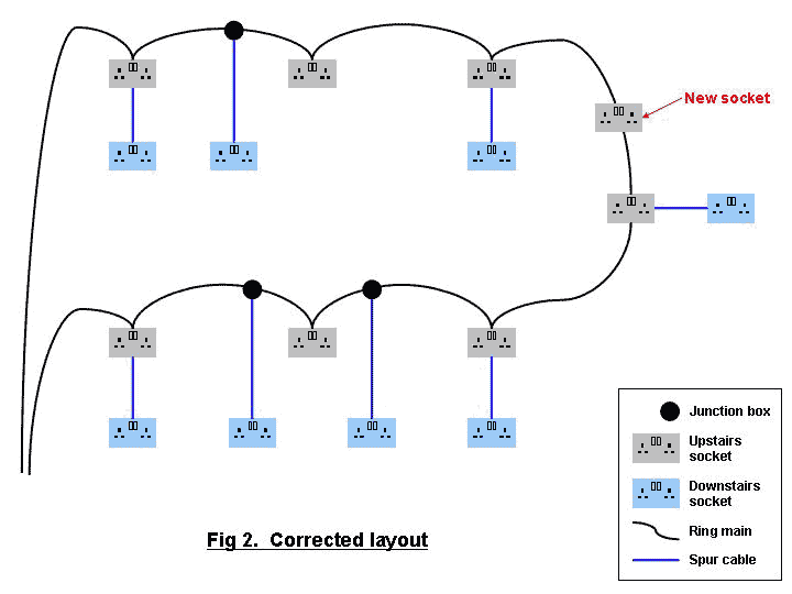

Fig 2 shows how I could fix the problem of 7 sockets and 8 spurs, but I don't see how it makes any difference to the spurs?
Fig 3 shows what would happen if I made a separate "ring" - no sockets and all spurs. But if the new ring had 8 sockets instead of the 8 junction boxes that would be OK? If it would, this is where I get really puzzled, because if nothing was in those sockets directly on the ring, it must still be OK, so it would be OK if I left the sockets under the floorboards and if I did that then what is the difference with junction boxes?
DIAGRAMS:
Ring layouts 1
Ring layouts 2
Ring layouts 3
Each socket on a ring can have a spur, (single or twin). Me, myself , I, if I was ripping up boards to look would add a ring, if for one socket, splice in, makes life easier

I can't see why, in terms of the current flowing at any point in the ring, or down any given spur, this //www.diynot.com/img/forum/spur-man2.gif is any different to this //www.diynot.com/img/forum/spur-man1.gif, i.e. why No 2 is OK because it has one more socket on the ring than No 1.
Also I don't understand why Breezer and Scoby are saying "yes, have a second ring", when that second one couldn't have any sockets on it. It would be a loop of cable with nothing but spurs. It would have no sockets at all directly on the ring. From what everyone is saying, that's not allowed, you can only have the same number of spurs as sockets.
Which leads me to the completely nonsensical conclusion that if I did what is shown here //www.diynot.com/img/forum/spur-man3.gif, but where that shows junction boxes I had sockets, that would be OK. If I never, ever used those sockets, nothing would change, but they would be doing exactly what the junction boxes would do.
