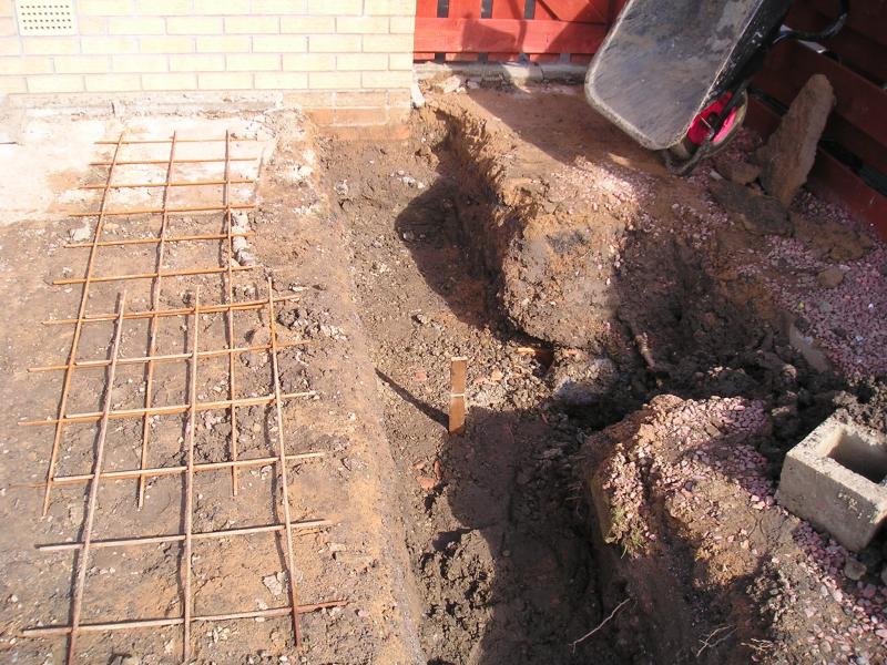

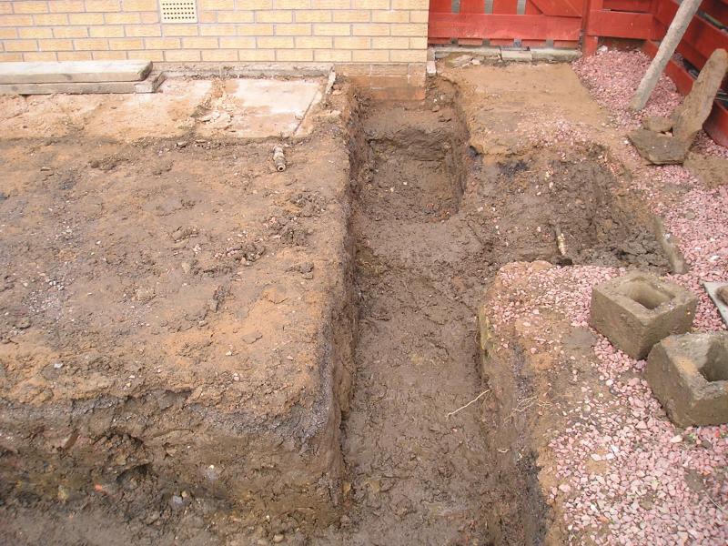

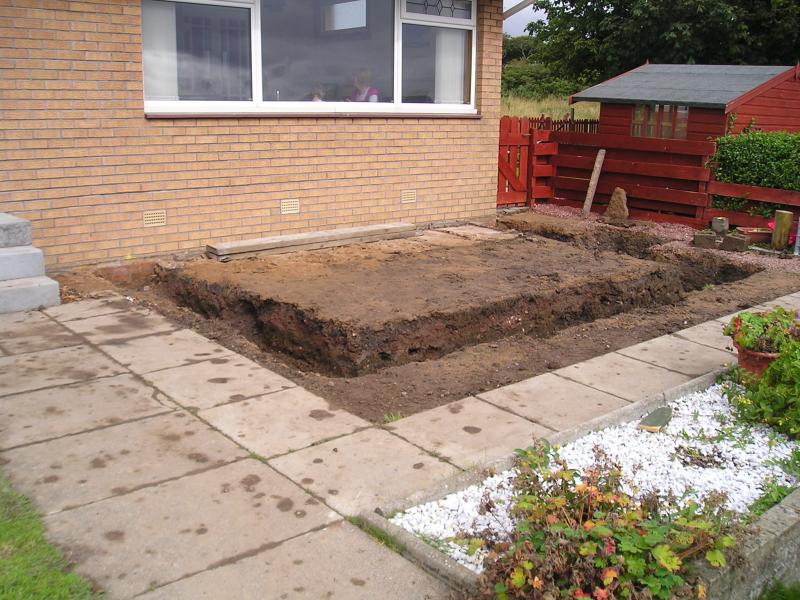

strip foundations 600x200mm
stop cock had to be moved
from founds.

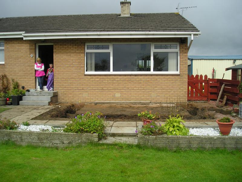

front elevation existing
mesh for founds (clay soil)

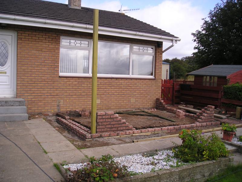

steel post and found walls.

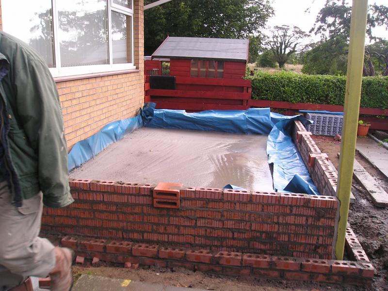

150mm hardcore.
nearly ready for dpm.
floor ready
100mm concrete.

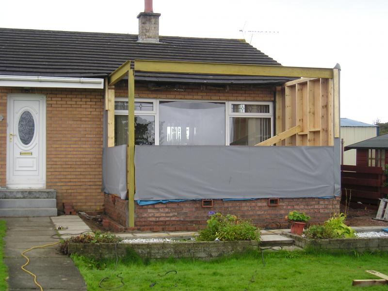

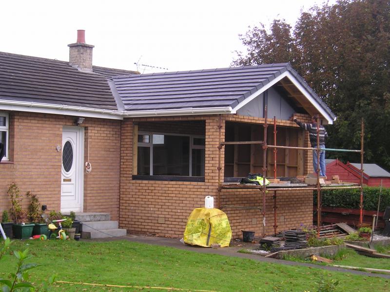

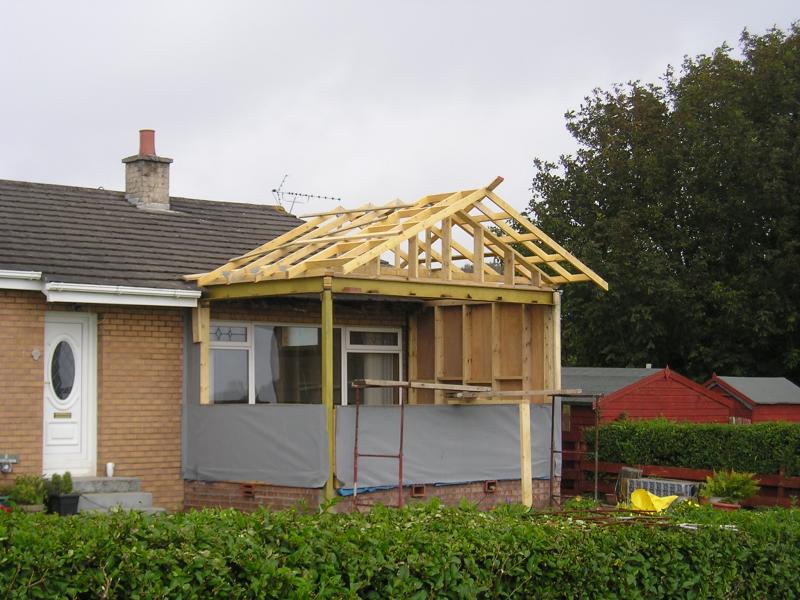

steel up and kit started.
roof trusses up.

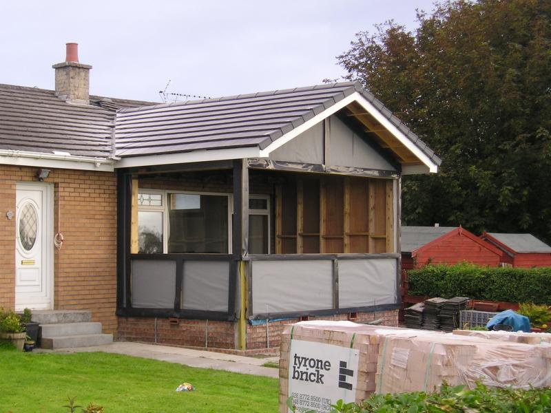

roof tiled.

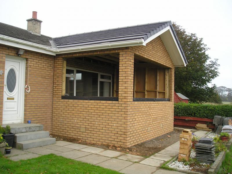

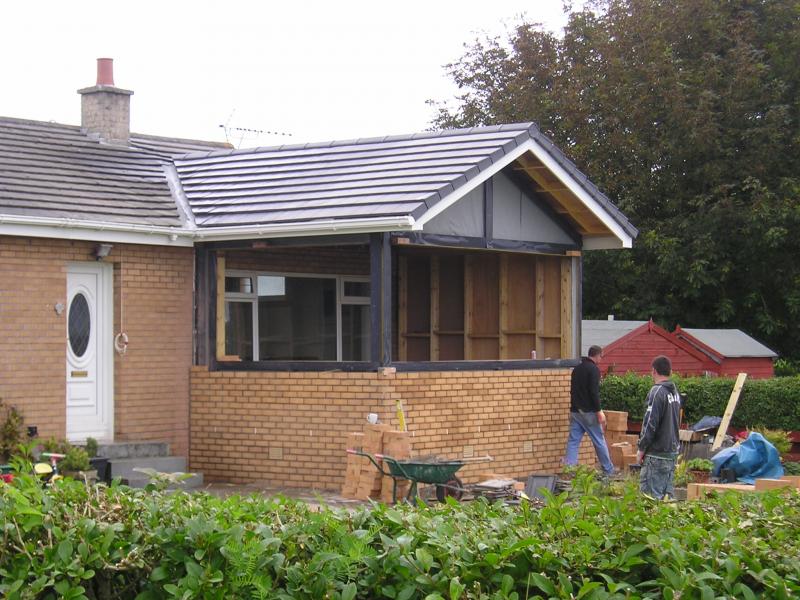

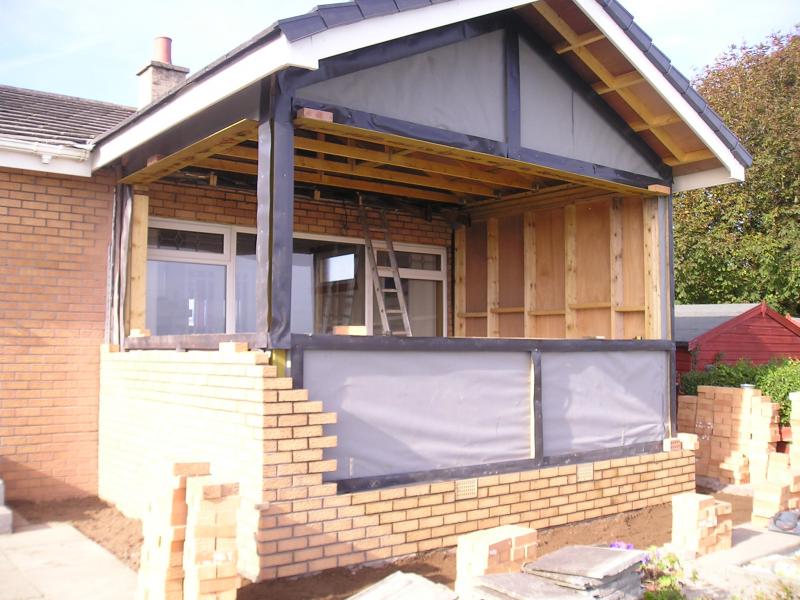

brickwork started.

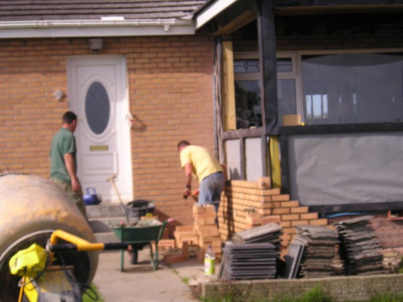

brickwork.
getting there.
1 more day on brickwork.
brickwork complete.

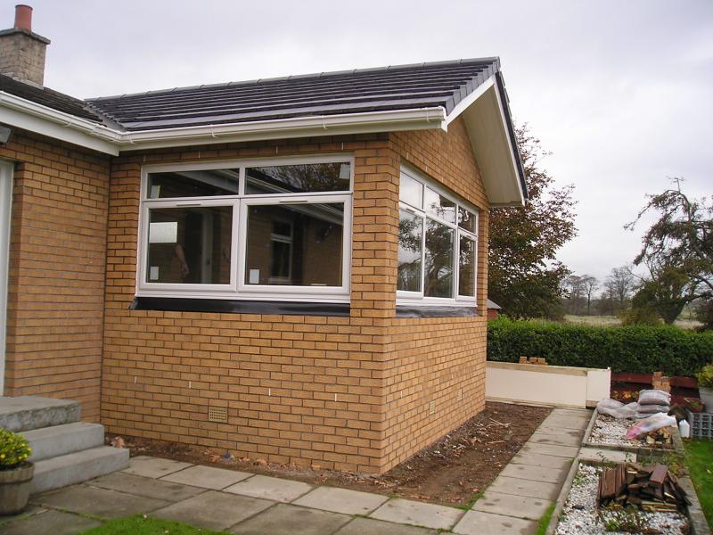

windows in.

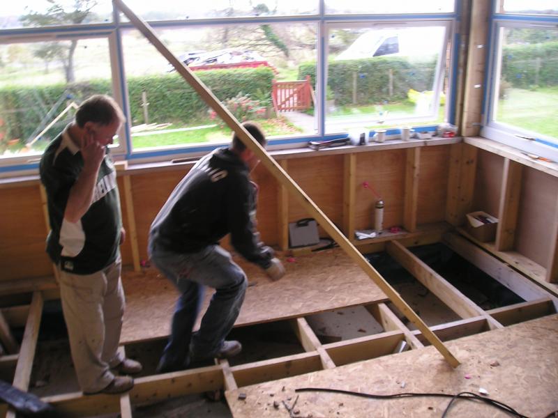

inside now.

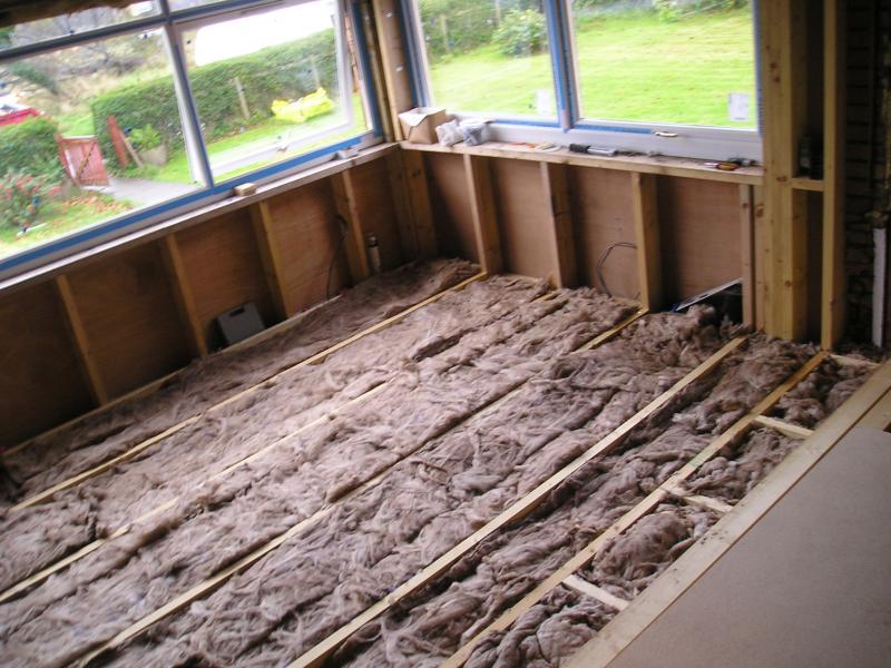

floor insulated.
floor down walls insulated.

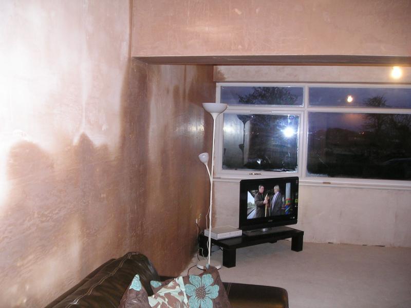

plastering.

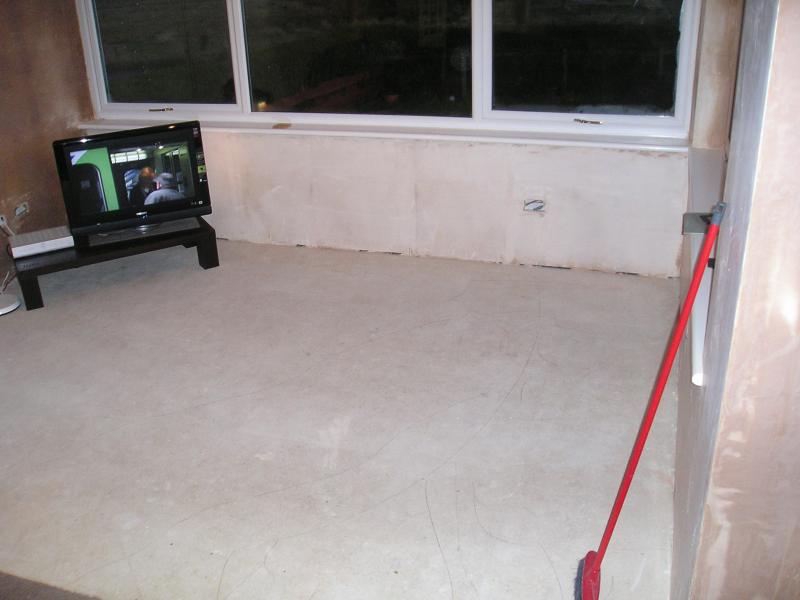

job complete and telly moved in lol.
he wanted to do the skirtings himself...... :D and he's a spark he done the leccy work.
