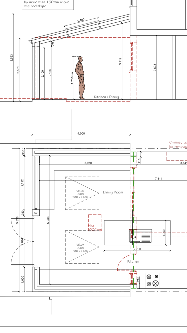

low pitch extension roof

I’m having a similar concern with a 4m pitched roof extension.

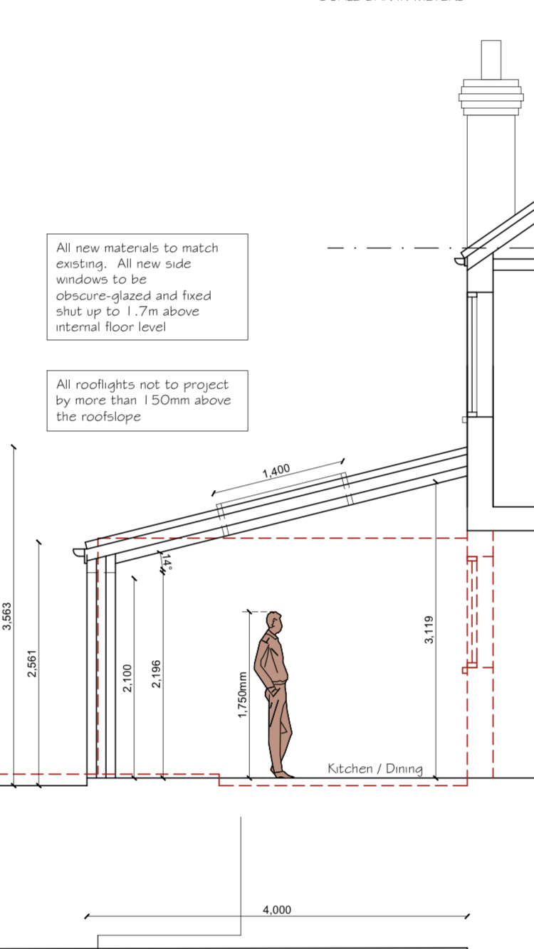

Can I ask what you did in the end? My current drawings just about allow for the 210cm high doors but not much else, I’m concerned it will feel too low and we won’t even be able to put blinds above it.
The pitch is at 14 degrees which I’m unsure if the velux will leak (it says their minimum pitch is 15 degrees) for these windows.
The pitch doesn't have to be restricted by the existing windows in the house.
Nor do you have to have a full width flat roof to increase pitch of the tiled section.
If you go that route you may as well go flat all over .
This problem has been covered on this site several times and drawings posted .

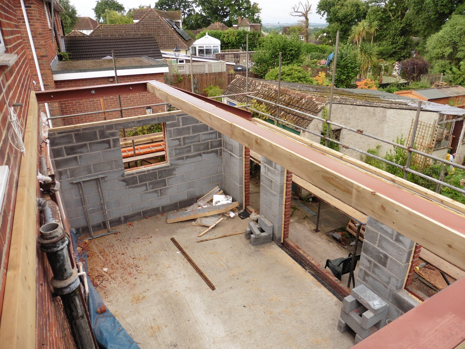

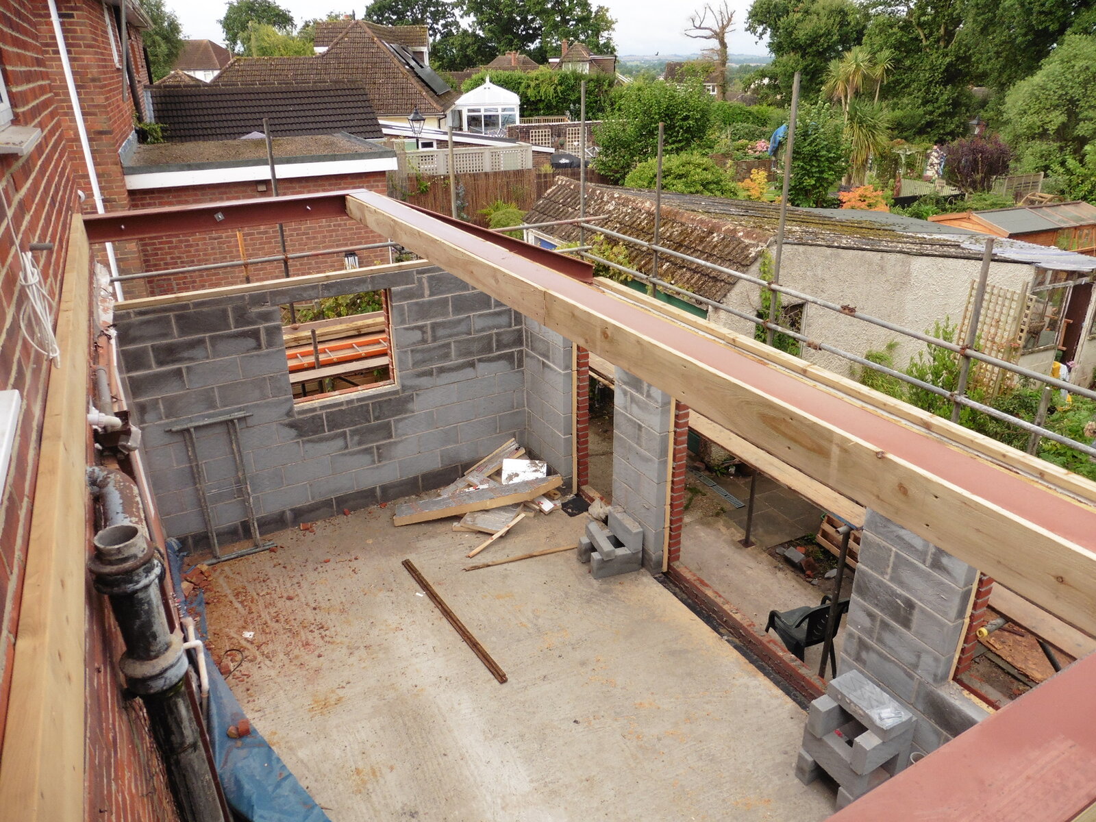

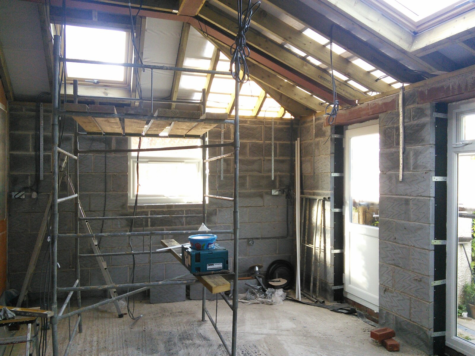

Some pics of a flat and pitched roof under construction. The tiled section is pitched at all 3 sides! Looks great underneath vaulted. Probably cost a fortune in steels!
I think the architect just left most of the roof design to the structural engineer...
That’s just 2 cranked steels, not that expensive.
You can gain 300mm with the same pitch by raising the roof line up the 2nd story windows and flattening the roof profile in front of the windows. You can also lower the pitch to 5 degrees by changing away from tile, bonded aluminium / insulation panels are fime at 5 as is the lower cost sheet tile effect > If you need a concrete tile option for a lender redland do a tile that is fine at 7.5, interlocking singla roaman, its has a fair head lap so you will need to budget for a 3rd more at shallow angles.
Is that an Architect drawing or just a plans person....they should know all the options
....or have a low pitch EPDM / Single Ply roof, and then cover it in any finish you feel like! :)
What the fudge is going on with those rafter bottom cuts!
New Generation of Velux skylights out now with a minimum pitch of 10 degrees.
