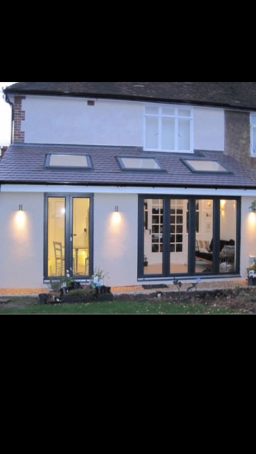

As I'm about to start my extension very similar in size and pitch also with 3 veluxs/keylite.
I'm thinking of going for a cut around the rear window to compensate pitch? Extension is 4.3m-5.6m so even lower degree roof, i would be grateful for any feedback.

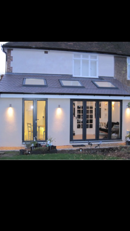

Cheers, I was thinking something like this below which will give me just enough For 15 degree pitch, Nathan

Don't forget that there could be design issues regards the lack of fixing potential at the window abutment (once above the window sill), which in turn could have an effect on the positioning of the Velux. It may also have a visually detrimental effect regards the vaulted ceiling perspective, viewed from below.
Not as simple as you think......;)
yep and certainly don't consider raising the pitch of the veluxes as per what the OP did, hopefully he resorted to a std fit, as he was already at the limit and must have flattened the pitch of the tiles above the velux to about 6 degrees.
Its really not difficult or brain taxing..unless you want it to be.
Visually there will already be a knock on with the vaulted ceiling caused by the steel holding up the rear of the house etc..
Its really not difficult or brain taxing...
No - quite. But if the OP has expectations and then finds himself in a position where he has taken advice from the internet then puts a window well into practice, he may be disappointed with visual result from below.
Looking at the image posted with the three Velux and the window well - I'm guessing there will be a flat ceiling area starting directly above and at the head of two of the Velux windows. I'm not sure how the trimming arrangement works but it will require a wee bit of thought especially in view of the fact that the two inner rafter Velux trimmers do not but against the wall, rather they will be cut short onto a bearer.
A small flat ceiling area ..Quite So! What is he getting now? A vaulted ceiling butting a boxed in steel , down one side and up the other. There is a compromise needed. Small flat ceiling or leaking windows? umm Im sure he wont forget his cavity trays either.
Anyway he is to far on I suspect.
Trimmers and doubled rafters Yes you are correct.. perfectly doable though
