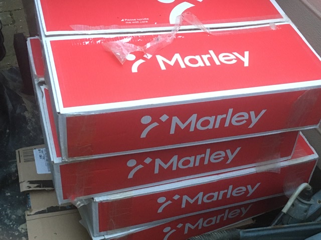

they don't send out the 12.5 version as samples (strange!)
I have asked for several samples and had zero result. The first time I asked for 250 and the second time I asked for a modest 110. Both times refused.
Go for singles multiple times although 110 or 250 might be pushing it (y)
