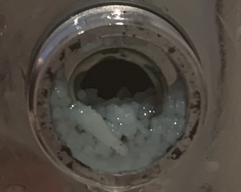

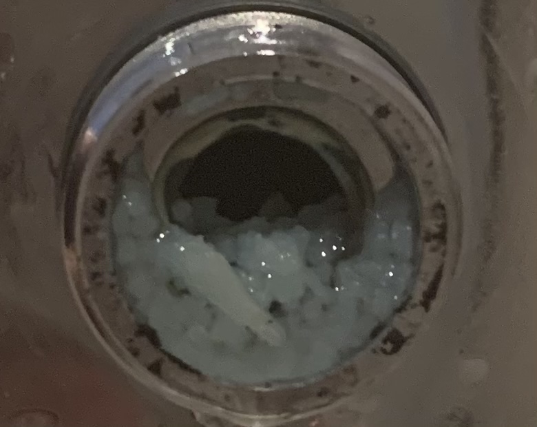

Hi, now the shower filters got blocked again with blue gunk (see attached) which I’ve cleaned. Not sure what it is and why it keeps building up?

Never seen anything like that in a mains fed pipe ??
Anyone else ??
I would suspect that gunk has found its way into those too. Are they monobloc taps ?
Is the hot and cold gunged up at the shower ,or just hot,or just cold ?
Just the hot in the shower, the cold was completely clear.
I took the tap apart and the filter in the white plastic cartridge seemed clear.

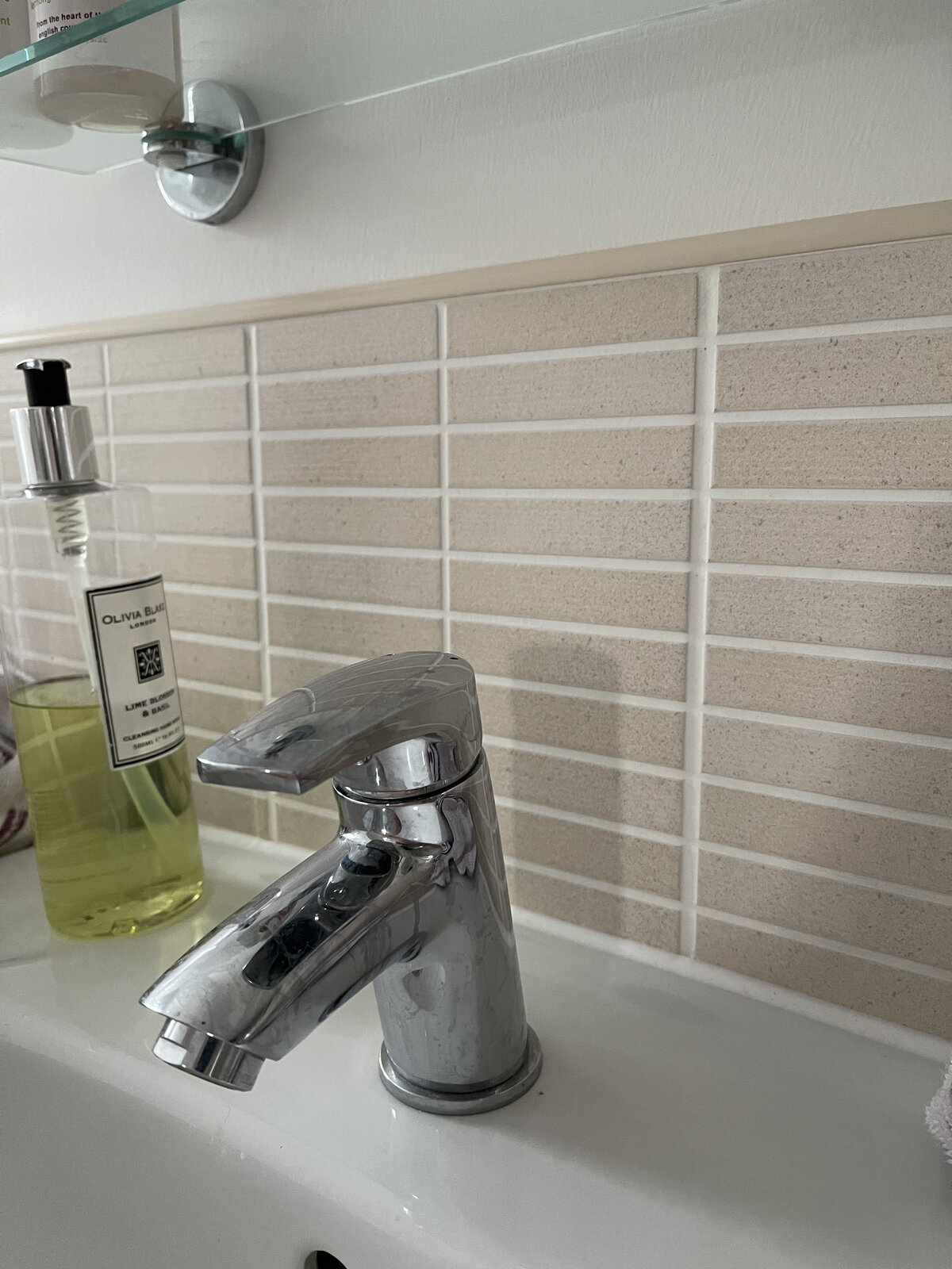

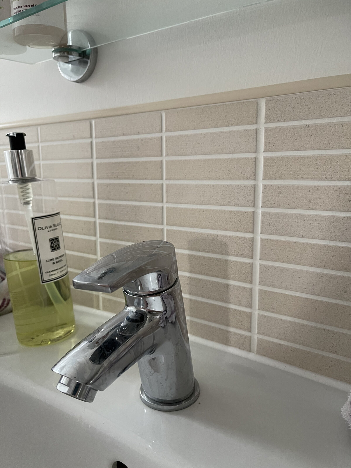

Show pics of the taps that are not performing.
Ah I see what you mean
Both taps are the same - see pic
Thanks. I expect the supplies to the tap are silver ,braided ,flexible hoses ,or possibly copper tails. Both are restrictive ,flexis can be kinked / twisted And both are capable of being blocked with that gunk where they enter the tap body. You will need to isolate water supplies and take apart to examine.

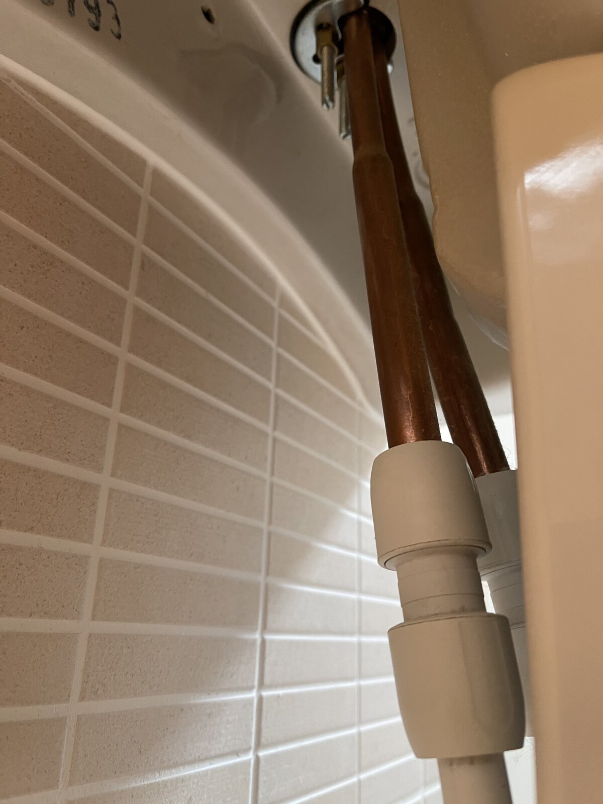

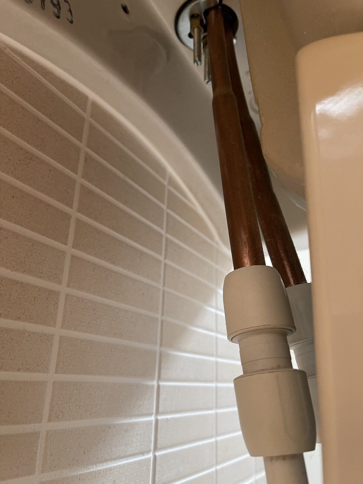

I’m hopeless. How do I disconnect the plastic tubing from the copper? Doesn’t seem to just unscrew as the plastic bits just turn and turn
They look like HEP20 fittings ,any markings on them ?
If so you need a special demounting tool to release them.
